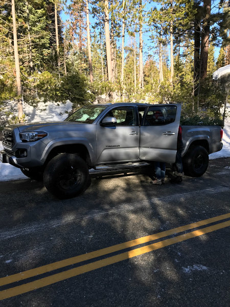

    Hey All!
    Any help would be greatly appreciated! So I put a 3" Procomp lift on my '16 Tacoma and I'm not sure I want to keep it on, however I have put larger tires on 285/75/R17 Toyo's.
    Now I know there are vastly different opinions and there is probably a much nicer route to go, however I honestly didn't think I needed something different or more expensive. I am finding now that this suspension is pretty stiff feeling.
    So here are my uses thus far and my future uses. I use my truck for daily driving and traveling for work. I take my truck out hunting, which right now it is Duck season here in CA and travel on washboard type roads out around the club that shake the crap out of my stiff riding truck. I will be putting my Snugtop Camper on this week and eventually a CVT Tent here in a few months. We will use my truck as our camping vehicle for some beach and mountain camping, but beyond that I don't see myself in the immediate future going on anything more than some moderate terrain with basic mud, potholes, gravel, or sand.
    SOOOOO ... I need to keep the height on my truck for the larger tires, but I want a better quality ride, that can take the road to the duck club, at least better than my brothers stock F150. Id like to keep budget around $1200 max if possible for now.
    Any help would be great!
