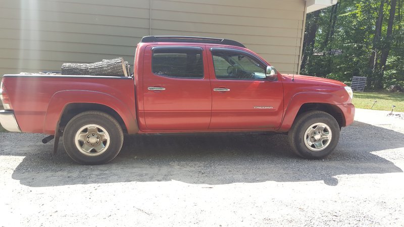

    Mine was sagging so bad when I installed the sumo's it raised my back up 1/2", so the ride is just a bit stiffer but it doesn't bottom out going over the railroad tracks anymore. That pic is with 800lb in the bed and 2.5" squat
