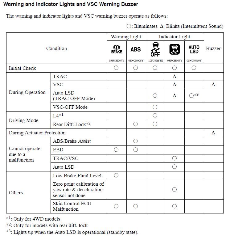

    I reviewed the Toyota troubleshooting material I have, and while useful and technical, it is somewhat generic. From what you described [ a single ABS Warning light] it points to a malfunction with ABS, EBD, or Brake Assist. Either way, the dealer is on the hook for fixing it, so make sure they do!
    • ABS Warning Light - Lights up to alert the driver when the skid control ECU detects a malfunction in the ABS, EBD or Brake Assist.

    For my situation after the lift and tires the VSC would go off on every turn on the roads to my cabin. Highways exit and on ramps not so much.
    They first diagnosed a miss alignment and aligned the truck but did not reset the VSC. Not until I read these threads was I able to go back and ask them to reset the VSC. When they did this many lights came on. ABS, VSC off, and I forgot the third light. They diagnosed this to a faulty YAW sensor. This is the tricky part the faulty YAW sensor was setting codes for Speed Sensors and the Yaw Sensor. However this device failed it was creating False Codes. Lucky they did not just swap parts, they did check every speed sensor and recalibrate but would come up with the same and different codes every time. I don't know how the ultimately decided the YAW sensor was the problem?
    After replacement of the YAW (Which btw is VERY EXPENSIVE and not readily available or at least not where I am).
    With the replacement of the YAW recalibration all is good again. I have no false skid control issues anymore. Skid control works as I went 4wheeling and it went off a few times while out.
    Anyone having sever problems and I mean 80%+ of the time should have an alignment done and a reset. If that doesn't solve your problems ask them to diagnose the YAW sensor.
