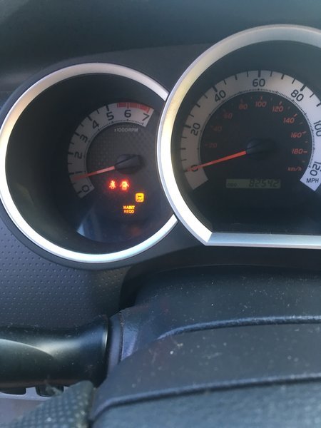

    [​IMG]I only got the light when I tried adding the lean spacer. First with the 1/2 drivers and 1/4 passenger the light first showed up. Then now with just the 1/4 drivers spacer it still shows up. I think Im going back to stock soon or at least just a 2.5" lift to try and correct this. I cant stand the light
  18. Aug 7, 2016 at 8:01 AM
    #338
    Large
    Large Red
    Sep 10, 2011
    #63268
    22,457
    I am the same way, I might pull the cluster out and solder the circuit without the light. It means nothing to me anyway
