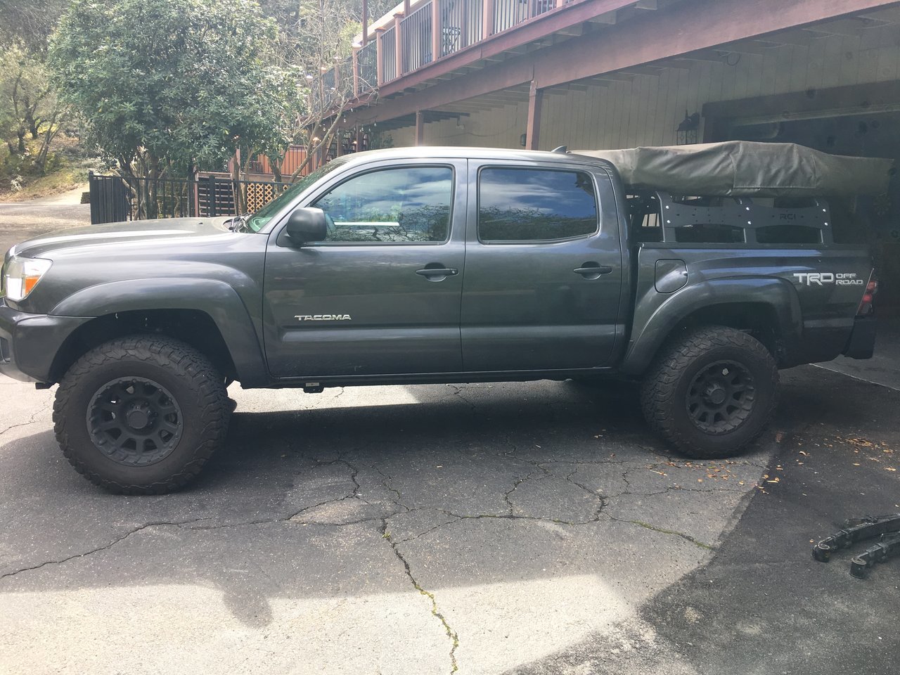

    This just happened to me on the 330/18 going to Big Bear. Freakin thing went off like 12 times. Pretty much forced me to drive the exact speed limit. Now I'll be that slow guy who has to use the turnouts. I think the length of the DCLB doesn't help.

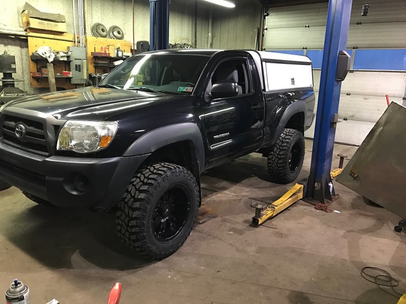

    I just had my 09 Reg cab lifted with the Zone 4" lift plus the Wheeler's AAL at my favorite shop. I haven't seen the truck yet and will pick it up this weekend. I went with 285/65/18 tires and -19 offset wheels. I just discovered this thread (and issue) yesterday. I read 90% of this and I am really crossing my fingers that I don't have the long sweeping turn VSC engaging like some of you mention. Had I known about this potential issue, I still would have done the lift. If I do get the problem, I'll probably try the Yaw reset and last resort would be toggle switch on the wheel speed sensor. Maybe there is a cleaner way of cancelling the VSC, idk. All I know is when I tried drifting and doing donuts the other week in fresh snow, it kicked on and I personally can't see any reason I would ever need it to do that. I drove POS rear wheel drive vehicles my whole life in the Northeast and never had a problem when the ass end kicks out. I'd really like the toggle to cancel the VSC without affecting anything else like the ABS but from what I have read here, they go hand in hand. If, the theory that altering the factory rake like the dirtbike guy stated is the culprit, I might be ok with the addition of the AAL to my lift kit. Thanks in advance for any input and I'll report back once I drive it a bunch.

    I've driven 3000 miles since my lift and no VSC problems. I don't corner hard cus I'm pretty easy on her. On the street anyway.
