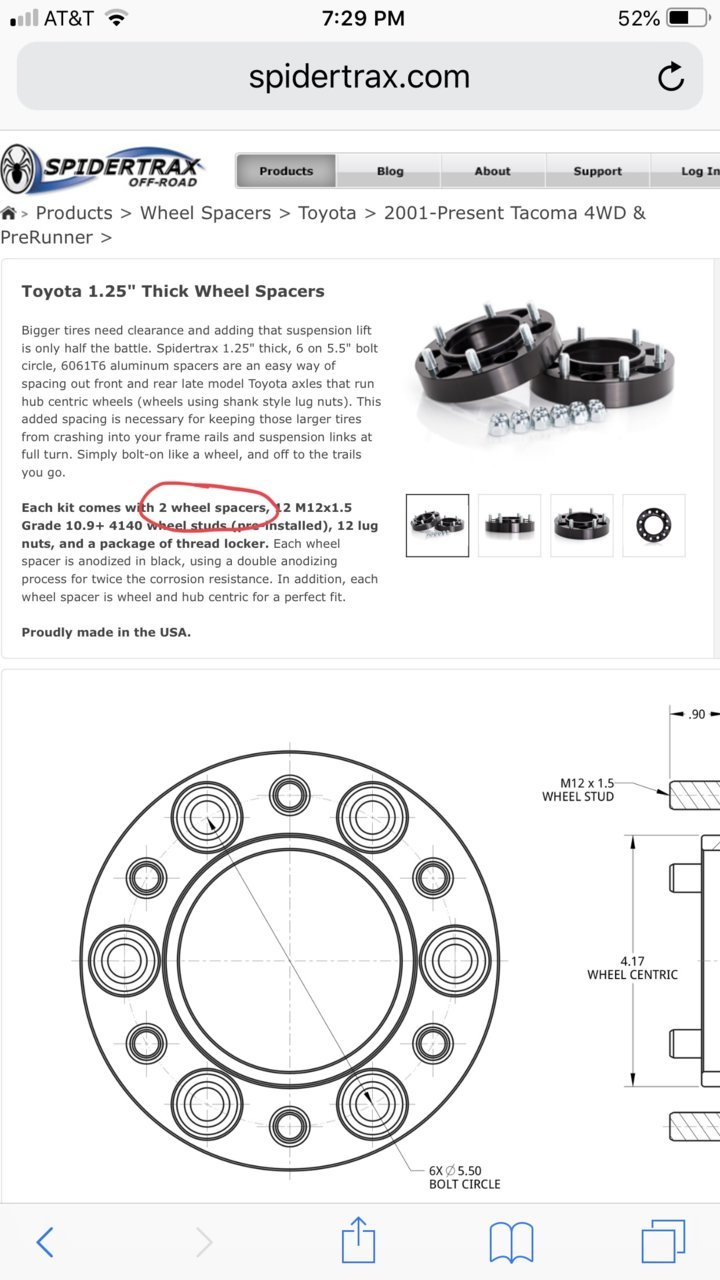

    2016 QS Toyota Tacoma Trd

    So you don’t have to put it on all four tires?

    No you do not, some just need them for the front to keep from rubbing on the upper control arms
