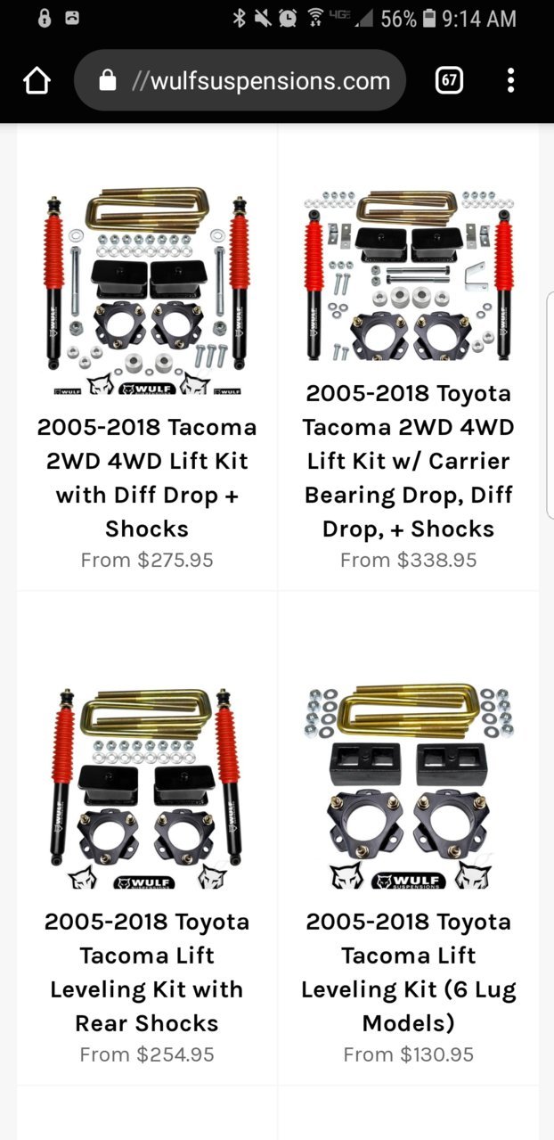

    Should I get one of these wulf suspension or get bilsten shocksScreenshot_20190408-091404_Chrome.jpg

    If you want to stay in the $300-$500 range, I recommend 5100’s on all 4 corners with the front on the top setting (2.5) and either blocks in the back between 1-2 inches or a single add a leaf (long style).

    These 3 links are pretty much all you need. A lot people don’t like rear blocks. In my opinion a 1-2 inch block is perfectly fine, any height above that and you’ll need a new leaf pack. I use 1 inch rear blocks and 5100’s and I’ve never had an issue, the ride is great. Are you a 4x4?

    Ok, is your truck 4 wheel drive? If it is you will need the item in link number 3. If your truck is 2 wheel drive, you can disregard that link. What wheels are you going to run? Are you gonna run larger tires?

    No, save your money and get a real lift kit. New coils. I did this for about a grand.

    I'd just like to add the diff drop is optional. Ended up removing mine because it wouldn't clear with a pelfrey skid, and no issues. If you end up needing it, you can always order it later. Or I'll send you the one sitting in the corner of my garage if you cover shipping.

    Go with 5100’s all around or save up for coilover’s, buy once cry once..
