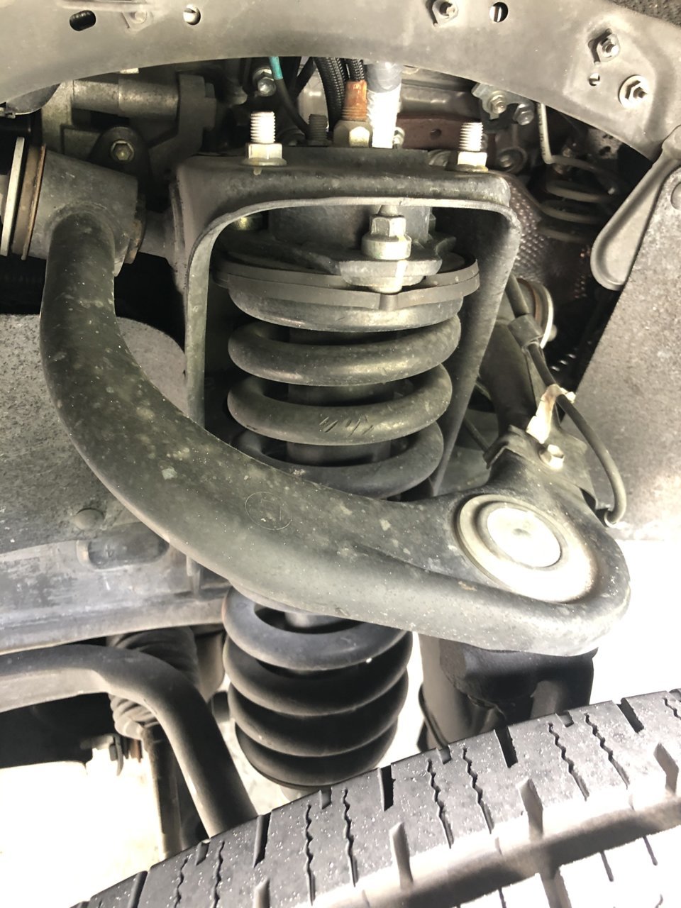

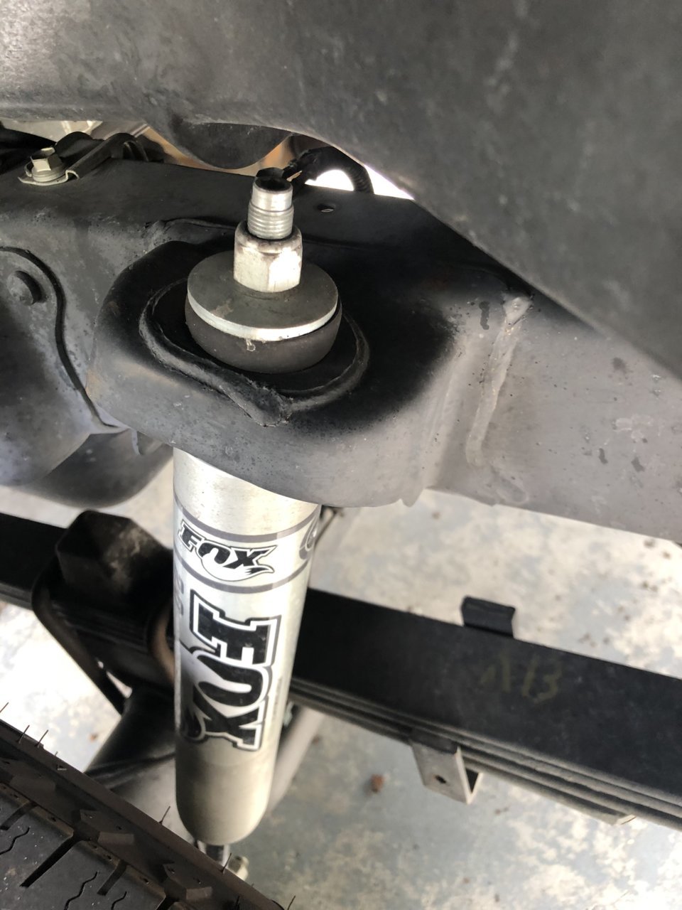

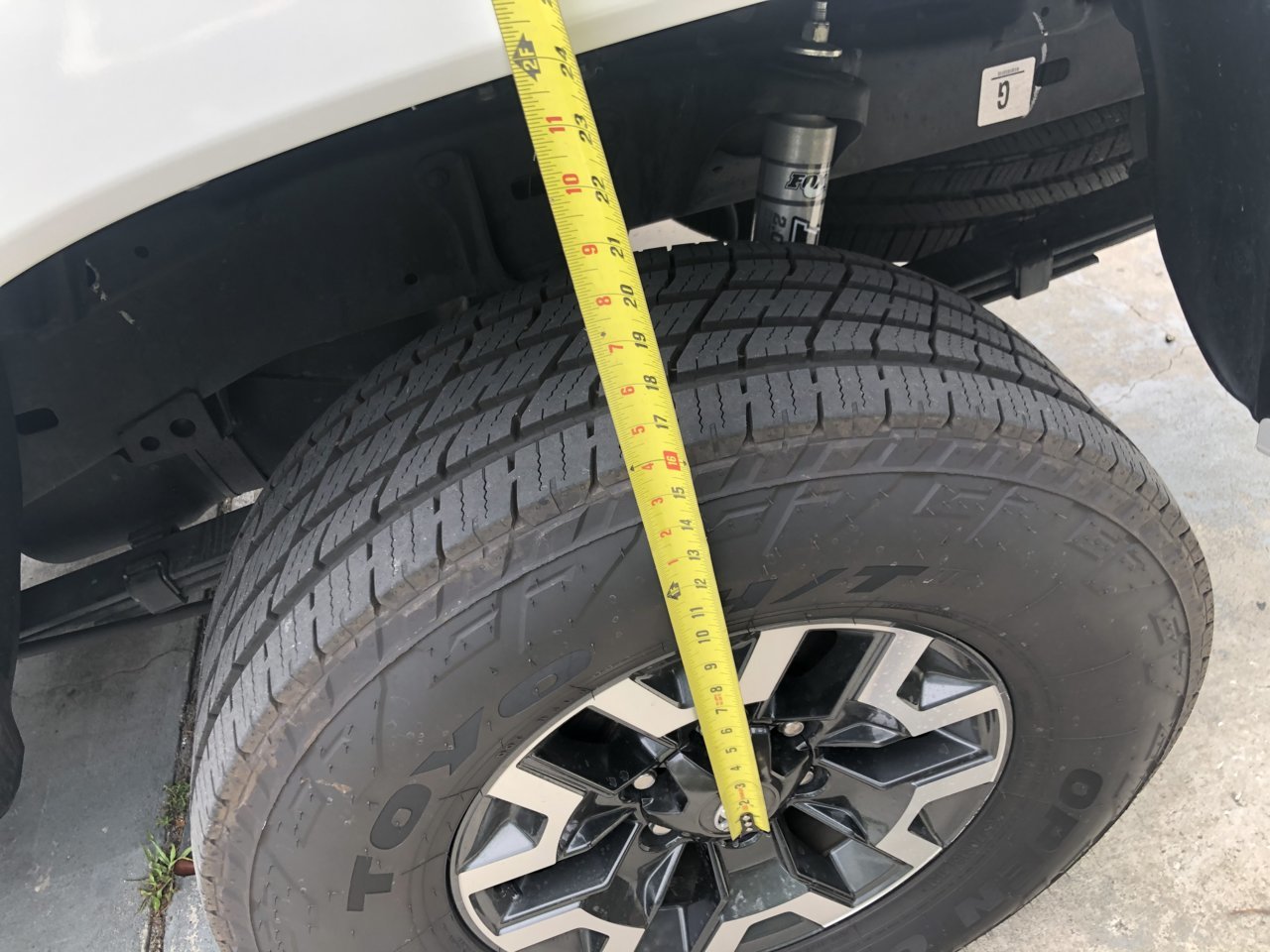

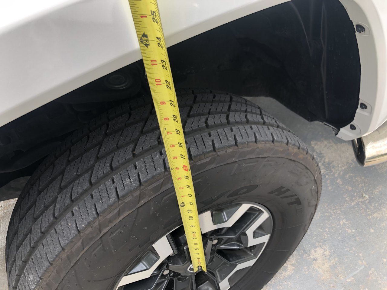

    I was trying to figure out what kind of lift or leveling kit I have. I’m not seeing any spacers in the front and have fox 2.0 rear shocks. From fender to middle of hub is 23” in the front and 24” in the back. Don’t think that’s is stock, but can someone let me know? Thanks

    Stock is around 22"r/21"f

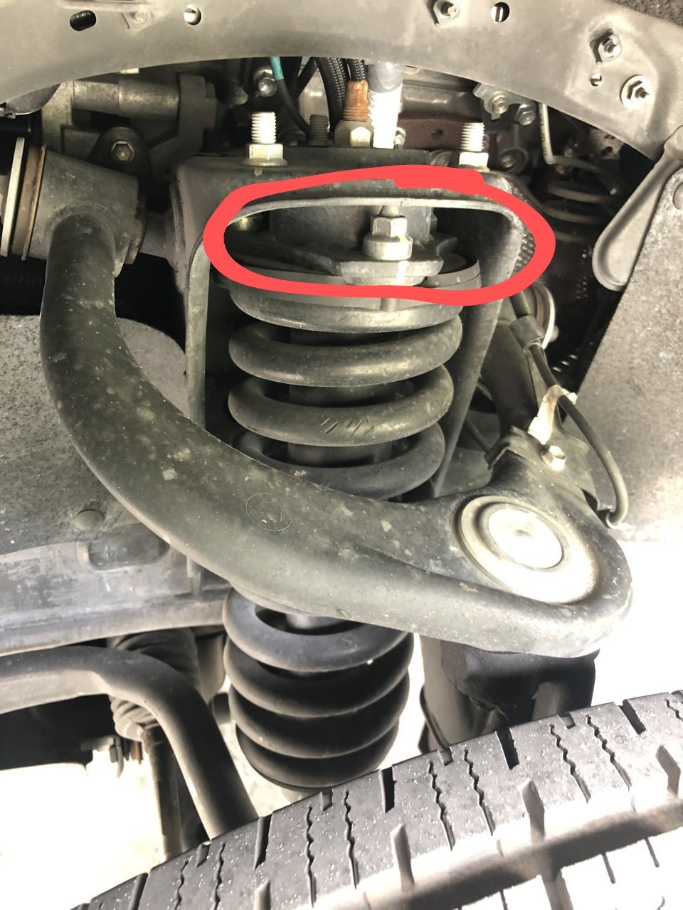

    Front is a spacer on stock shocks/springs, rear is a block under stock leaf springs.

    You have a block under your leaf springs. It's at least two inches. You have spacer in the front.

    Blocks and spacers bad. The Fox rear shocks are good.

    Remove front spacer , Pair the front up with matching fox 2.0 and your good :thumbsup: Block in the back your fine if your not doing anything crazy. Spacers in front reduce shock travel if your off-roading. Pavement pounder you are fine if that’s what you prefer. :thumbsup:
