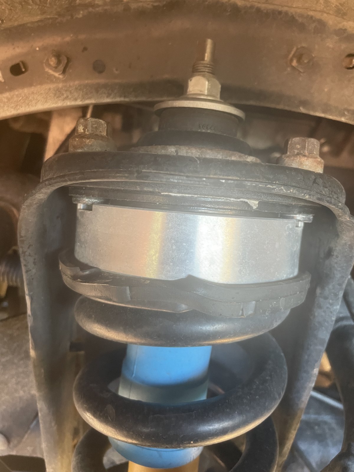

    I have a 1 inch spacer along with a 1/4 spacer does that equate to a 2.5 inch lift altogether.

    The 2 front struts are the ones that have the spacers so each strut would have 2 spacers one measures 1/4 and the other measures 1 inch.

    There’s a picture of the spacer

    Yes that's correct. Spacers on the front coilovers will give you lift approximately equal to 2x the spacer size. So 1.25" spacer lift will give ~2.5" lift.
    You may want to look into replacing your needle bearing with the ECGS bushing. If the needle bearing fails due to your lift it could possibly grenade the front diff.
