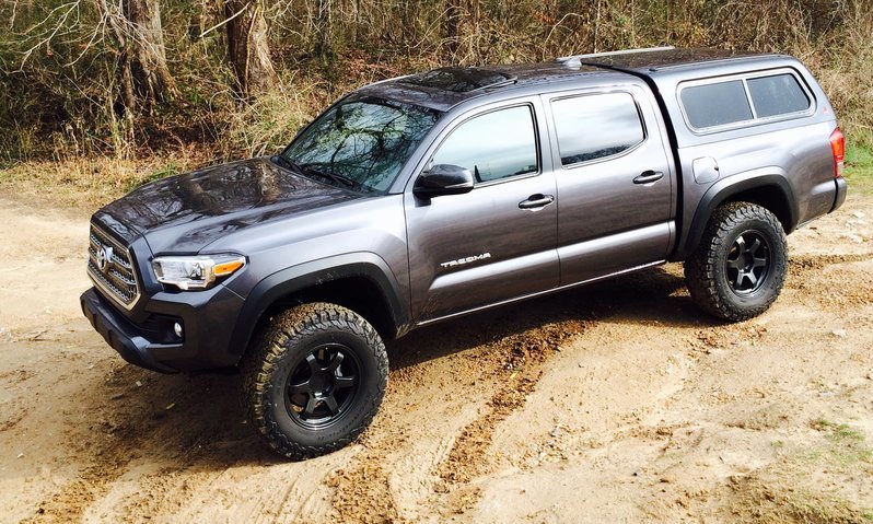

    Are those Koing wheels hubcentric to our truck? They look great! Are you running center caps?

    Looks really nice Ryan!

    Weathertech floor mats. Derped emblems. 20% window tint OME suspension lift 285/70/17 nitto trail grapplers 17" vision wheels Custom black trd off-road 4x4 sticker Trd pro grill CBI rock sliders with kick out CBI overlanding rack Homemade bed slide for propane stove and ice chest CVT roof top tent. Mt.Shasta summit extended HID headlights Every bulb in truck changed to LED
    Thank you. It rides really nice too. Great quality product.
