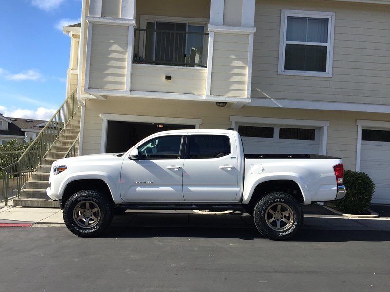

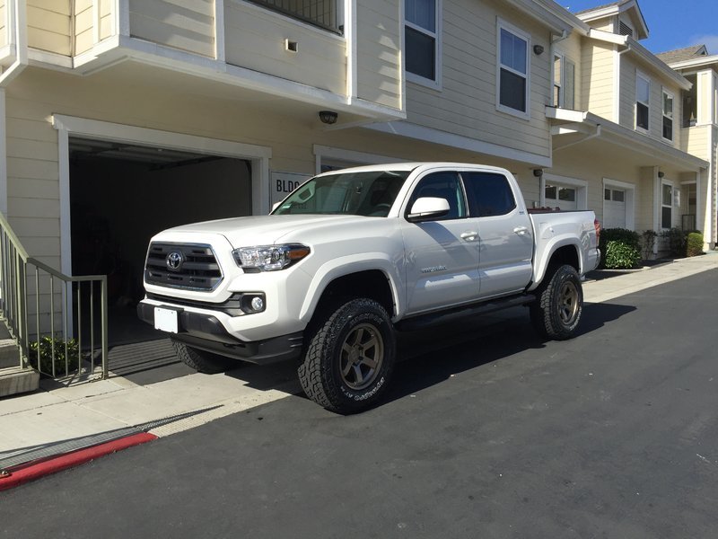

    ‘14 DCSB 4x4
    Camburg UCAs, Fox CO, fox rear resi, deaver 10 leaf
    image.jpg My Scarlett
    rickrobb and BKJ0E like this.

    20
    NorCal
    01’DoubleCab PreRunner V6
    What is the wheels specs?? Width,offset or backspace?

    leather, T.C. 6", King coilovers, TC uca's, Alcan, amp, Pro comp, bushwaker, bamf, magnaflow, afe.
    Pro comp 5001 series, 8x17 0 offset which is 4.5 bs. What the lift calls for. Yes sway bar is flipped. Sway bar has to be up above the tie rod, won't work any other way.

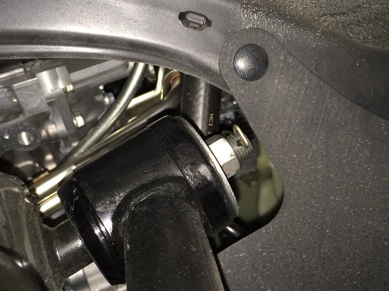

    I also read about some concerns about the upper control arm bolt that has to be cut on the passenger side while replacing upper control arms. So the fix was to cut the bolt and install a new one opposite of how it was installed originally. The problem was the fear of the nut getting loose and having the entire bolt slide down since installing it the other way around now has the bolt in a downward slope.
    So what I did was drill a hole at the end of the bolt and put in a cotter pin. While it does not prevent the nut from backing out, it will however keep the nut from unthreading completely. I'm sure I'll fell or hear some vibration if anything, and I can just simply retorque the bolt. Just thought I'd share. With the proper torque and a dab of lock tite (like others have suggested) and the cotter pin in place, I feel a lot better knowing my suspesion won't fall apart while driving.
