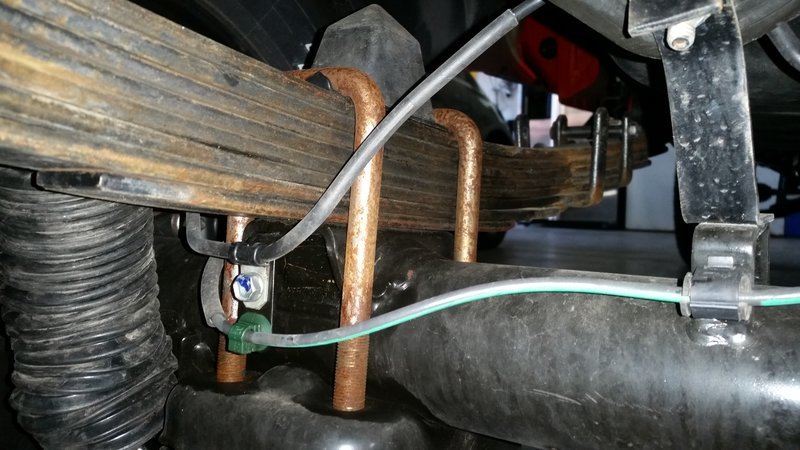

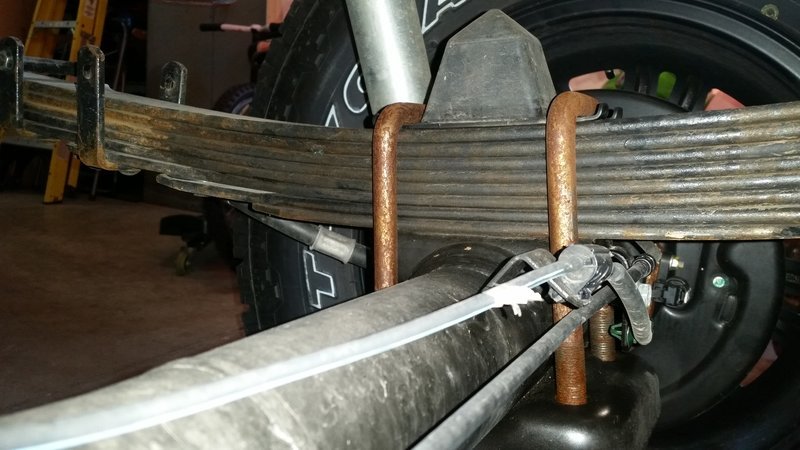

    I suppose anything is possible but it looks really good to me. Here are a couple pictures20160416_095140.jpg20160416_095106.jpg

    Some degree shims on the rear axle may help. It's hard to tell the angle on the diff from the pictures.

    I see carrier bearing drop, witch good. Take one more pic so we can see differential angle and if you have any shims under your leaf pack.

    There are no shims underneath the leaf pack that I can see. This is a full Leaf pack from Alcans Springs, no blocks or spacers was made specifically to give me five inches to match the six inch front lift. Mechanic at a different Toyota dealership today asked the same thing about shi20160416_184045.jpg 20160416_184033.jpg ms and said that possibly need some. I wouldn't know how to do that or who to have do it though.

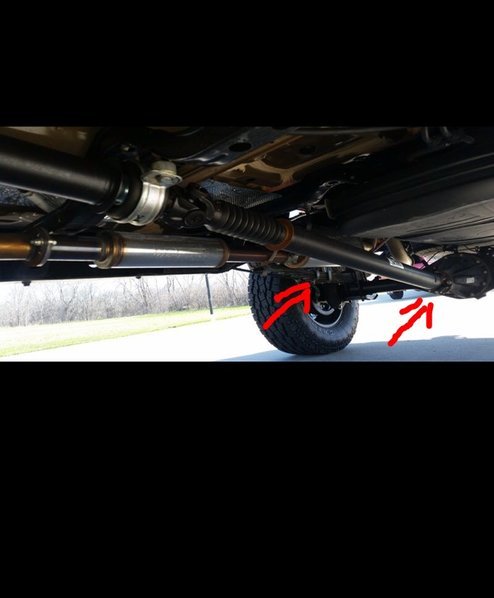

    There is your problem. They are easy to install, remove place them under leaf and tighten everything back. Here are few pics that they look like. I belive you would need 4 degree shims, headstrong sells them

    So that's probably causing the slight shudder going at 15 to 20 mph, and even more pronounced slowing down through those two speeds? There is a local spring shop, do you think they would have? Is the thick part of the wedge to the rear? And can the U bolts just be loosened a little and drive them in and retighten?

    I'm not sure if you can get them in without removing U bolts, you can try losses all bolts and whigle them in, some shims have slot in the middle for center pin and some have hole. Lift shops shold stock them they are cheap and used on lifted suspention. The skiny part goes toward front and thik toward back. You want to keep your differential in straight line with drive shaft.

    I had 2" blocks and it gave me vibrations because it was not how it's designed to work. Here is story how Toyota or others trying to tell you that it's "normal" Ordered 2" tapered blocks they send me regular straight blocks, I called them asking wtf? They call me back said they talked to their engenier and he said I don't need taperd blocks, I toght to my self bs, but because I already had all parts for my lift I decided to put them in and see if they were correct, took it for test drive and guess what! Vibration on stops from 20-10mph and humm o acceleration:annoyed:
    Best of all call headstrong or company that made your leaf pack and ask for degree shims. I used 3 degree, you might need 4-5 maybe 6 degree.
