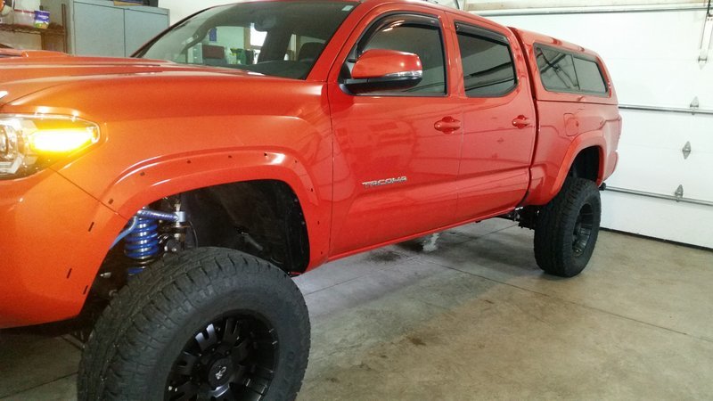

    Now that I'm understanding it a little better and looking at it closer. Here's two new pictures. I think where the spacer is to drop the carrier bearing at the first joint if I added a couple stainless steel washers to drop it just a hair more that would be more straight even though it's pretty close now and by doing that would actually help to straighten out where it meets in the back at the differential. That might be enough to help before I try the shims to Twist the differential upwards. ??20160416_230604.jpg20160416_230623.jpg

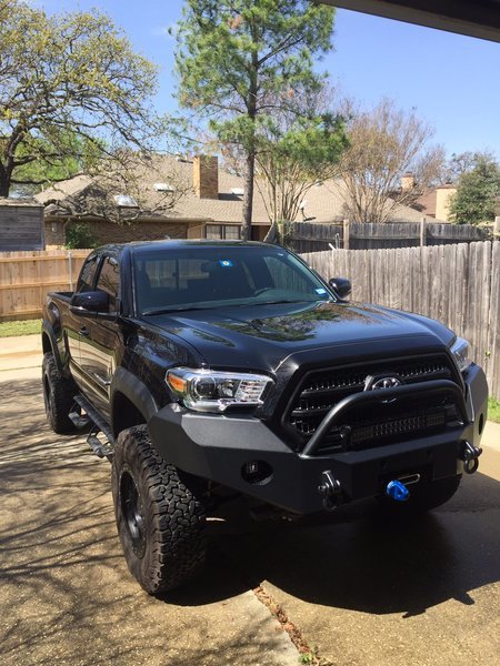

    It rides good. the bigger wheels and extra bumper weight makes my gas mileage crappy but I don't care. i had rubbing when turning with bumps and backing but the new bumper took care of all that.

    It doesn't look to bad but picture might not show it well. But having 5" lift there is definatly need for shims. It would be good if shop that does lifts measure your angle and corrected with shims. And I don't think you need to mess with carrier bearing just yet, first get shims in and see how it drives, if it's still vibrates then add washers.

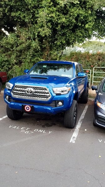

    image.jpg image.jpg 3 inch leveling kit with 2 inch wheel spacers

    Just ordered 4 degree shims from headstrong! Hope to have them and in place next week. Thanks for all your help! I will give you an update!

    Looks great! Did you have to chop the cab mount?

    I didn't. All my rubbing was from the front fender liner area. installing the new bumper required trimming about 12 inches off the liner and 6 inches off the fender flares.

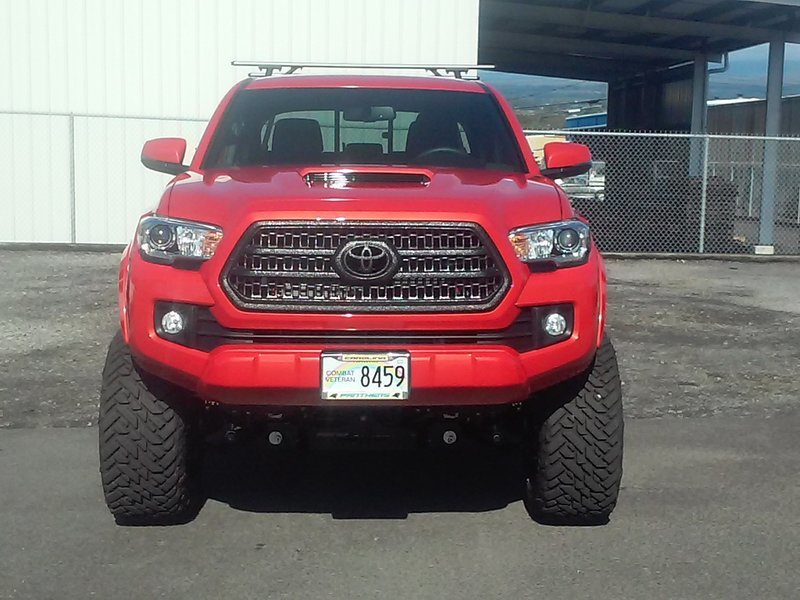

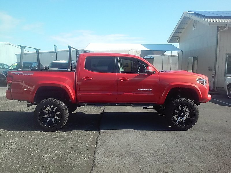

    3.jpg 2.jpg 1.jpg Saw this at a used car lot.2,000 plus miles and 50,000 ripoff $.....

    I don't know what all was done to it. But when I am done with mine I will have over $50,000 in mine! I am about there. Actually might have passed it up, and I bought the truck at invoice and got discounts on just about every part and install! Only 600 miles on mine. Not for sale!!!
