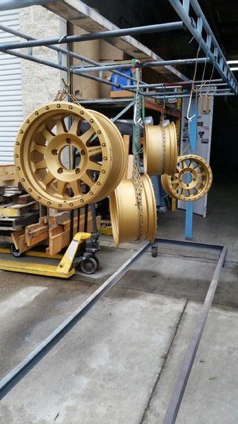

    Same wheels? I got my grill powder coated spartan bronze. Would love these to match. I guess sandblast them and re-cote.. $$$$$$$

    Paint the truck white! Problem solved haha jk well he didn't paint them bronze but I'll post a pic of his truck and they are method but I believe they double standards

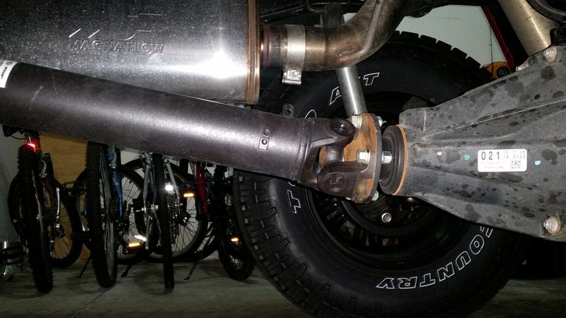

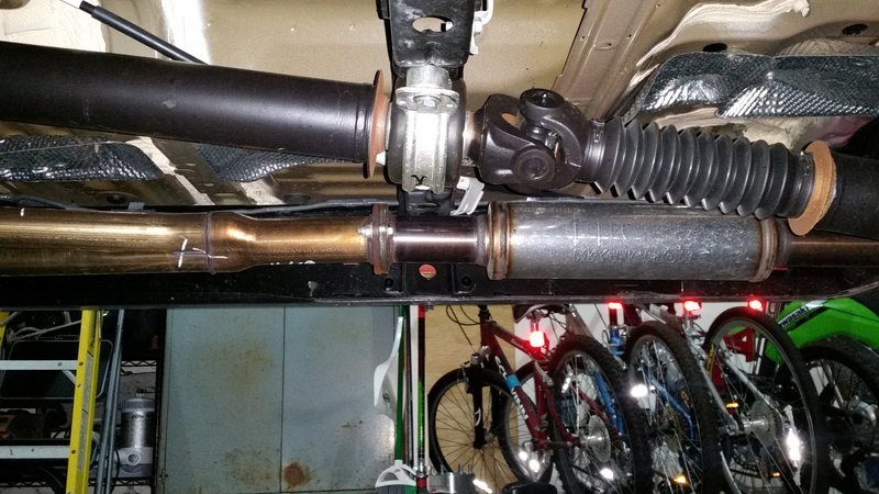

    I am willing to bet that you maybe getting your vibes due to the 2nd half of your driveshaft. On the prerunners the driveshaft is different but when the rear of the vehicle is lifted it starts to pull the driveshaft out of the flange on the transmission. What is commonly used is a driveshaft spacer which I have attached pics below which will return the driveshaft to the stock location. On the 4wd's they have an expandable sleeve on the 2nd part of the driveshaft which when you lift the rear of the vehicle the concept will apply as far as starting the separate it farther than stock. Not sure if the flange is the same as on the 2016's as on previous models but if it is you could possibly use one of these. You would just have to figure out what thickness you would need. I am listing a link for the spacers and you could always call them to assist.

    I appreciate that idea about the driveshaft spacer. I have shims coming in the mail tomorrow to try to shim the Leafs to get the differential more in line with the drive shaft. Will probably try that first, already talked with the mechanic on it. He's going to do that when he installs the AMP running boards probably on Thursday I'm hoping.
