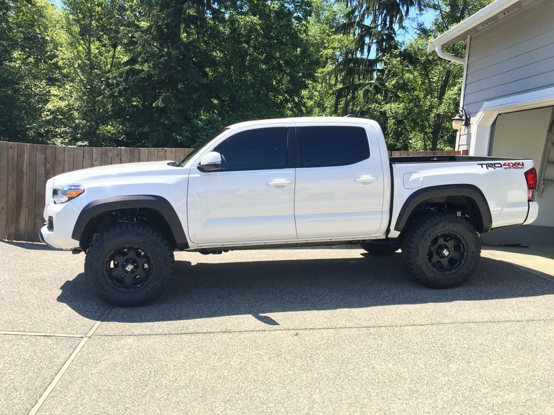

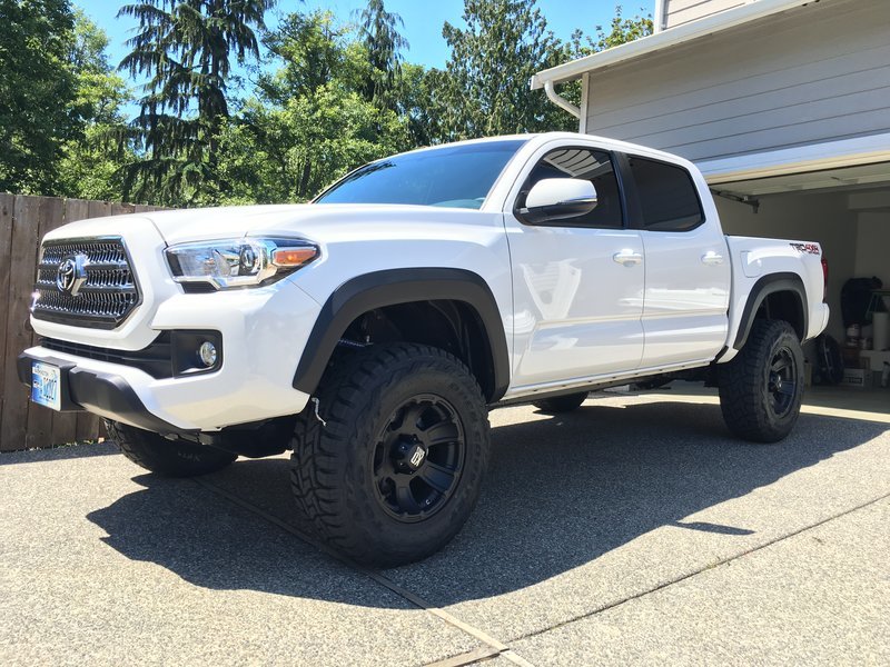

    OME kit with the 888's, Total Chaos UCA's. Those upper control arm bolts were a BITCH!

    How much lift and what size tires?

    It's about 2.5", 285/70/17.

    Looks great. Any trimming required?

    Looks great. Im doing same height lift on my Taco too. Any rubbing or trimming need to be done? Also, are you running spacers? Thanks

    I had some rubbing until I had the alignment done, seems to be good now. It is close though to the cab mount and the rear of the front fender flares. I'm running the trim packer on the lt front, no spacers. Depending on how the coils settle I may add spacers in the future.
