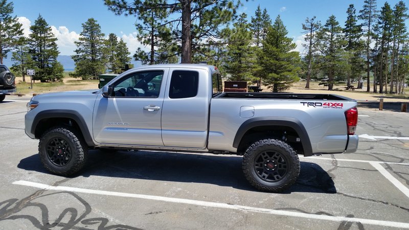

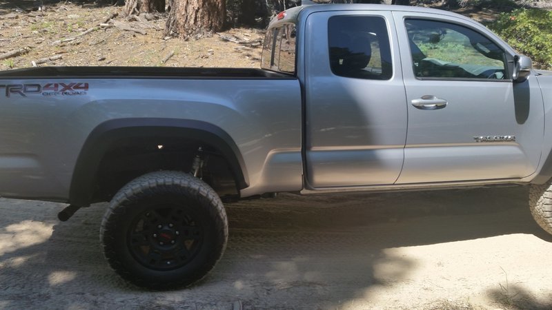

    2016 TRD OR AC

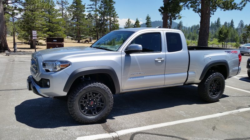

    265/70 R17 BFG KO2/TRD PRO 17" Wheels/FOX Factory 2.5" Coilovers,TC UCAs /Fox 2.0, Icon AAL - Rear/Raptor 4" Nerf Bar/

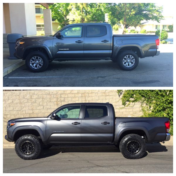

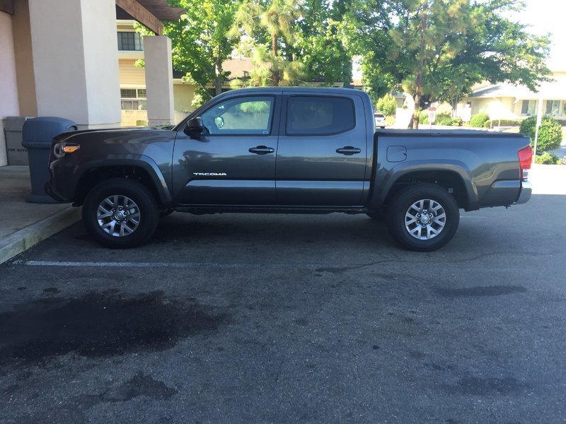

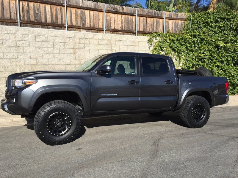

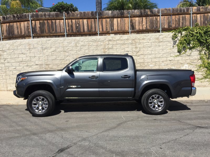

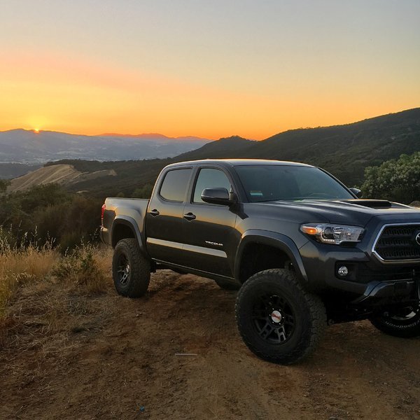

    So I finally got my 5100's installed in front at the 3rd setting (1.75?) and stock rear. BFG All terrain KO2's and Method NV's go on tomorrow and it should look pretty good. Still thinking about doing 5100's in the rear along with an AAL and/or block. We'll see after wheels and tires tomorrow.
    AFTER TOP photo /// Before bottom photo

    Alright guys... here it is!!
    Got my 5100's front installed yesterday at 1.75 (3rd notch) and stock rear (for now)
    Got my AT KO2's (265/75 R16) and METHOS NV's on today and its looking amazing!
    Here are a few before and after photos.
