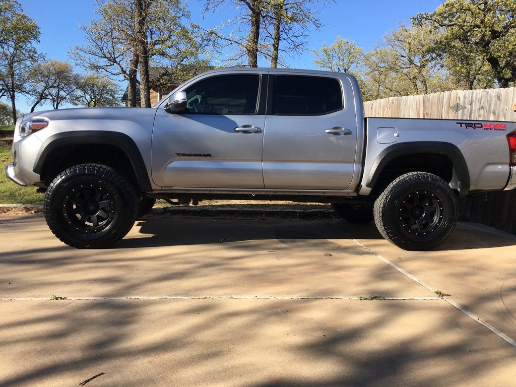

    I set my 5100's up front at 1.75 and used Spidertrax (1.25"). It was enough backspace clearance so I didn't have to get aftermarket UCA's and there's no rubbing and I no chopping/cutting needed. This allowed me to get 285/70/17 KO2's on my stock Sport wheels:)

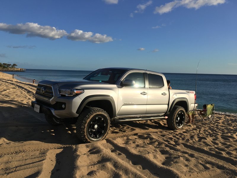

    Here's another pic of my baby (with her 2 older siblings) LOL!
