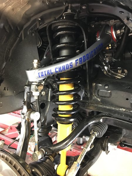

    Any more pics or details on this set up?

    Nice, I have this same setup with 885 coils and headstrong 3 leaf AAL in the rear. Had to move the swaybar forward with a relocation block because the coil was really close to the sway bar and sometimes coming into contact.

    Crazy, I've yet to make any contact.
