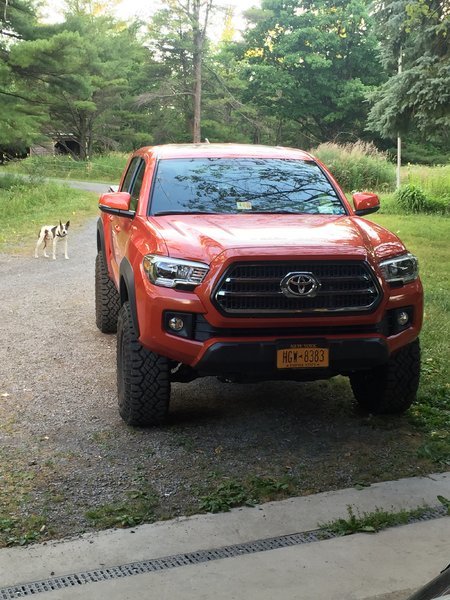

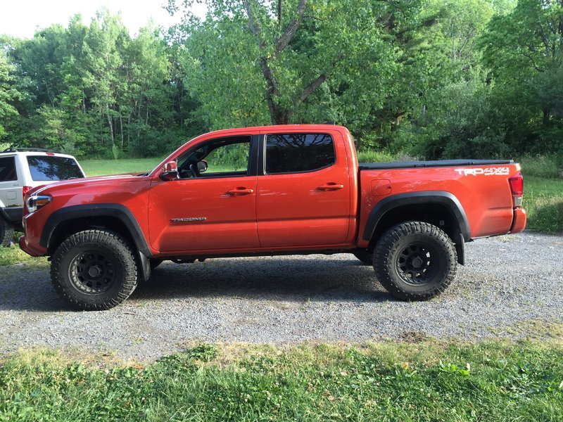

    Gotmy OME lift installed today. I must say it rides waybetter than stock. 887 coils with Headstrong 1/4" spacer, Dakar leafs, Light Racing UCA's, extended brake lines and 275/70/17 KO2'sinstalled...

    That looks great!

    That looks great! What wheels are those?

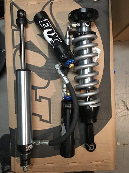

    These arrived today. Gonna try and get them on this weekend.

    Thanks! SCS SR8

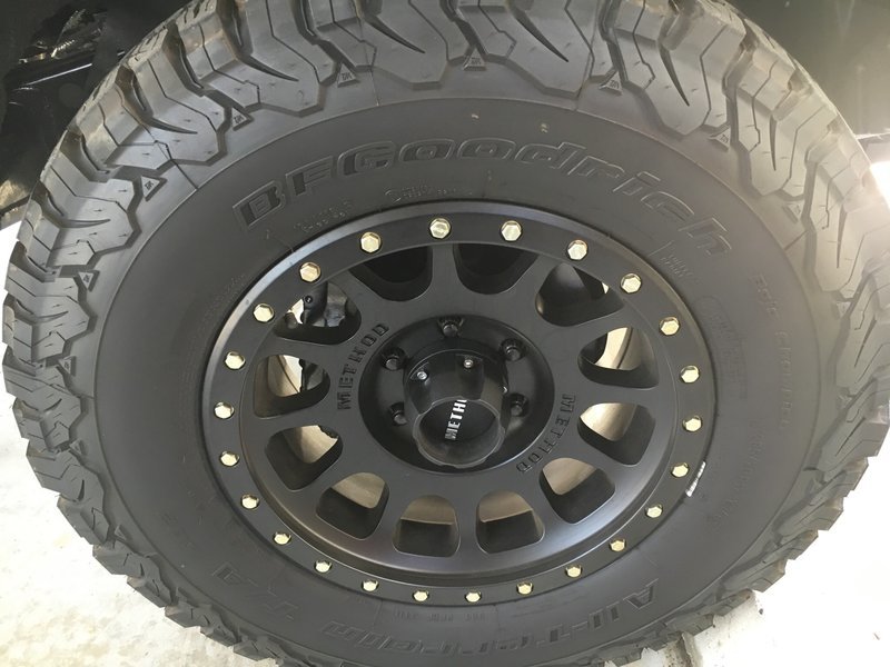

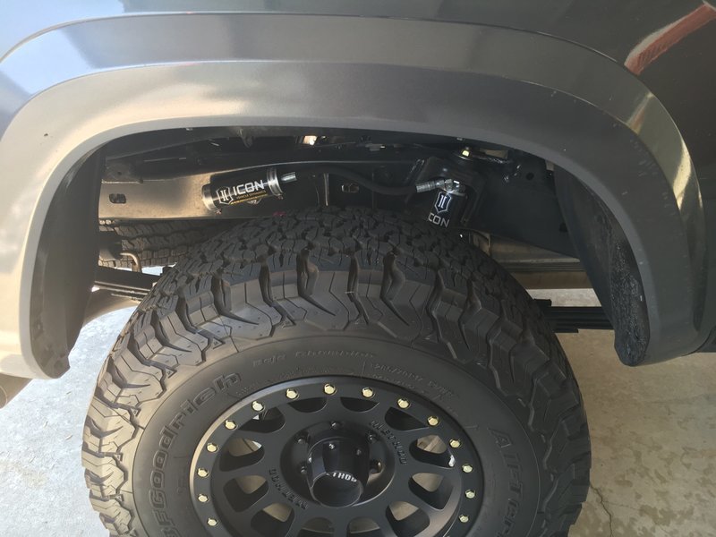

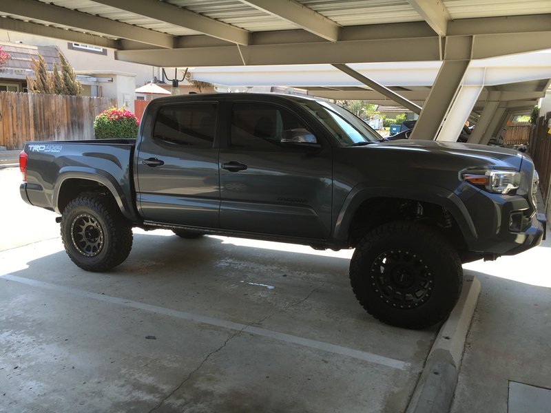

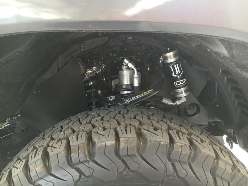

    Icon stage 4 lift method nv 17x8 1/2 on bfg 285/70/17

    ^that looks legit.

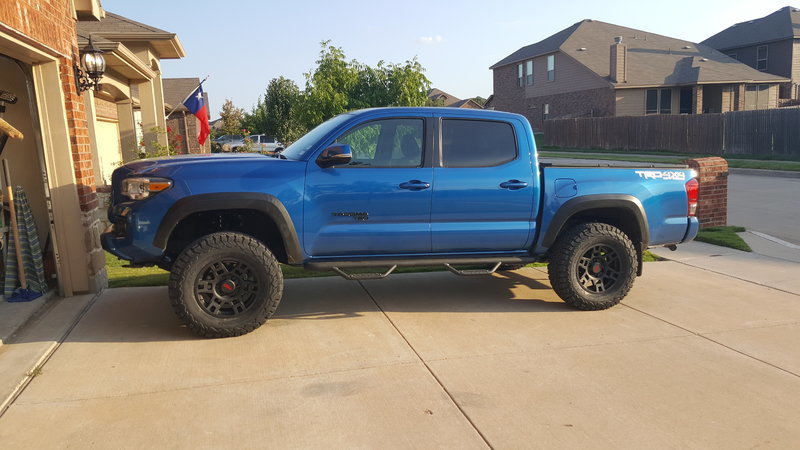

    Finished the lift today. Bilstein 5100s all around. Fronts set on second notch with OME 887 springs. 2" AAL in the rear. I achieved a 4" lift which is much more than expected. I had to remove the front mudflaps because it was still rubbing. I like the ride, much better than stock. I have never had a lifted truck before so it will take some getting used to. I noticed that bumps in the road tend to move the steering wheel a lot more. I can feel a drag from the larger wheels so I am sure GPMs will take a hit.

    The 4" of lift is because they're on the 2nd notch. It's recommended that OME coils be used with the lowest setting on 5100s. You may want to check your CV boots with that much lift.

    Definitely get yourself a front diff drop at the very least. That'll help your CV angles. I installed one and I'm at 3" of lift, makes a big difference

    Factory coil still? Any alignment issues?

    Thanks Guys. That is the first I heard that OME recommends the first notch. I started hearing a "clicking" noise on the first test drive. It appeared to be coming from the front of the truck. It is definitely a rotational issue because there is a rhythm to it and increases with speed. I thought it was with the wheels somehow but could not find anything. I did notice a pretty steep angle on the CV joints. Since they rotate with the wheels, I am thinking that is where the noise is. I did install a differential drop kit but the noise remains. Dropping the front to the lowest setting on the front shocks may resolve the problem. I appreciate the input.

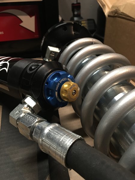

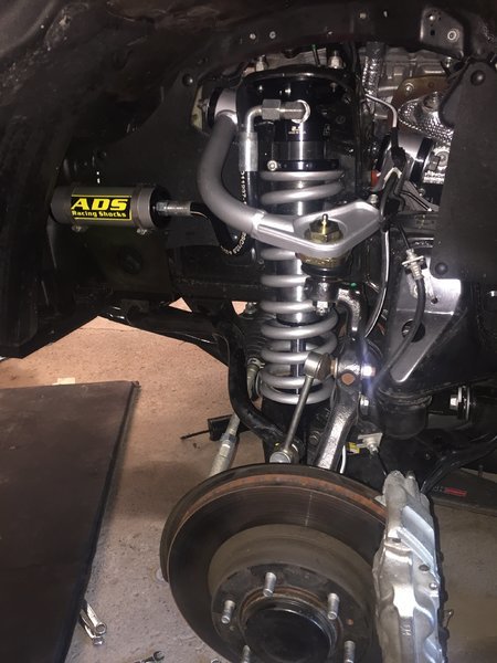

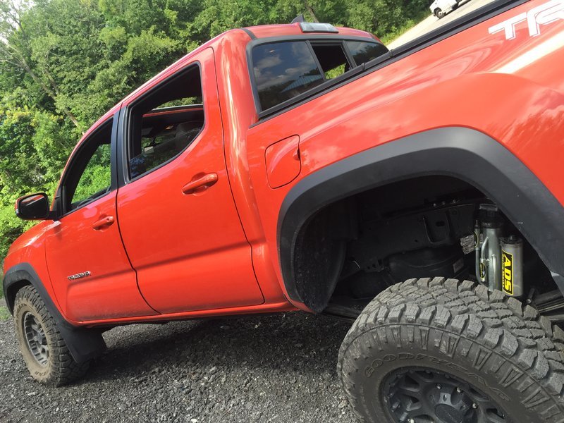

    ADS ext travel COs with LR UCAs, super bumps and no sway bar. Rear is 10" 2.5 three tube bypass and Dakars w/ 2nd overload removed and angled shims ( 3deg I think).
    Front lifted almost 2" ( didnt crank them down yet waiting for cap and I like more than 2.5 ins of drop). Rear is just under 3" of lift. 285/75/16 4.5BS
