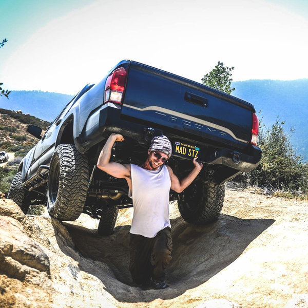

    Does this count? :muscleflexing:
    Me and @MADSTEEZE's 3rd gen at Pilot Rock last weekend lol

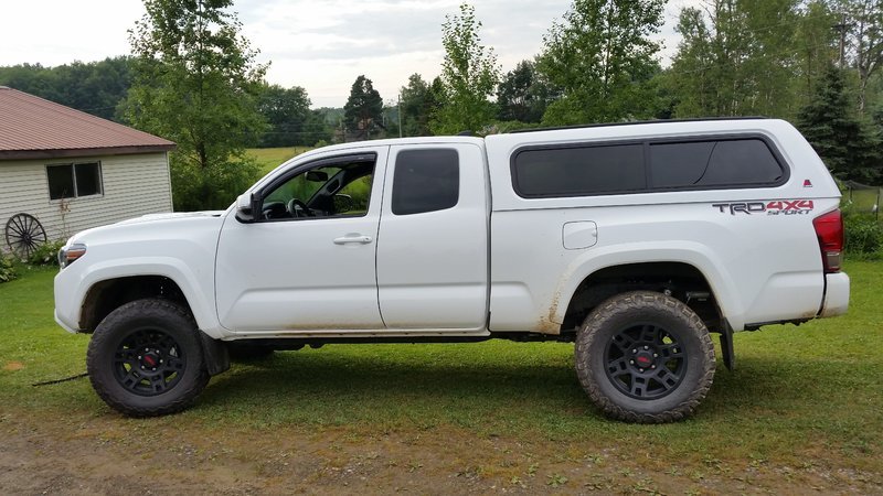

    Sounds like you got it figured with the rear end . Tires on mine are 265s. Factory flaps and no rub.

    Truck is in getting an alignment right now. I was unaware we get one free one in the first year. Although I caused it by lifting. Pretty pleased regardless. Superior Toyota in Erie PA. Been extremely pleased with their service department over the last 6 or 7 years I have used them.

    Trucks looks good!
    Did you get UCA's? How did the alignment turn out? Any leafs or overload removed from dakars? How much lift was achieved front and rear?
    Thanks.

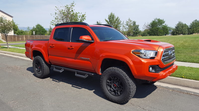

    Anyone set up a 295 70 17 on a Toytec Trail Boss kit?

    Nice. Anymore pics of this from other angles?
