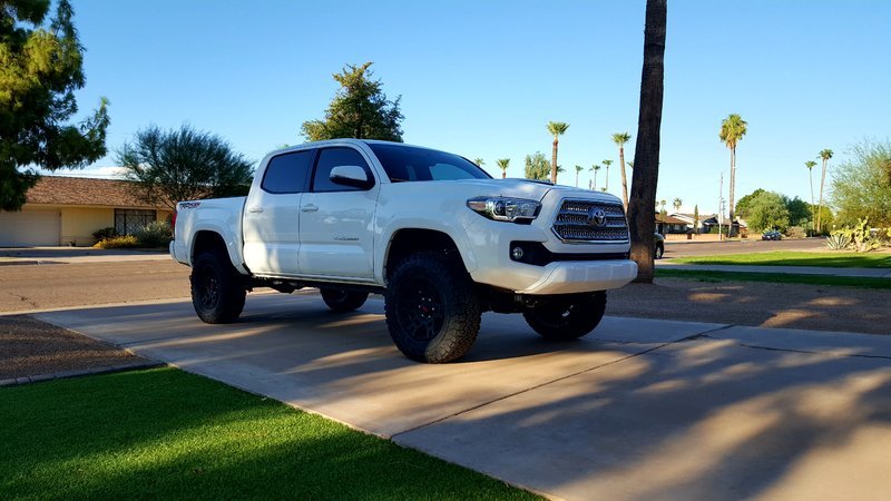

    Overload was removed

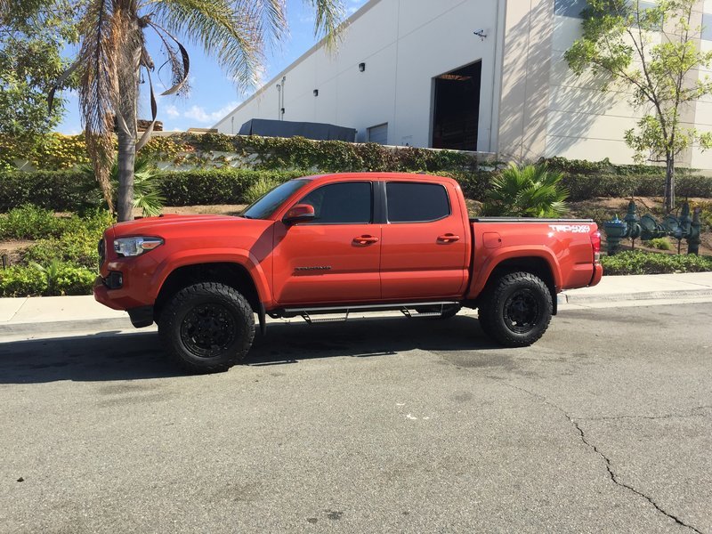

    Yes the overload spring is still in place.

    Looks good! This is the same set up I want to get once I have some extra cash.

    That looks damn good! Not to over the top but you can tell that its been lifted.
    Pretty much what I'm looking for. Is the rear slightly higher than the front?

    Are these Part Number:BOSS-TTFCS-2016 the Boss's you used?
    Which add a leaf did you go with?
    How's the ride compared to stock?

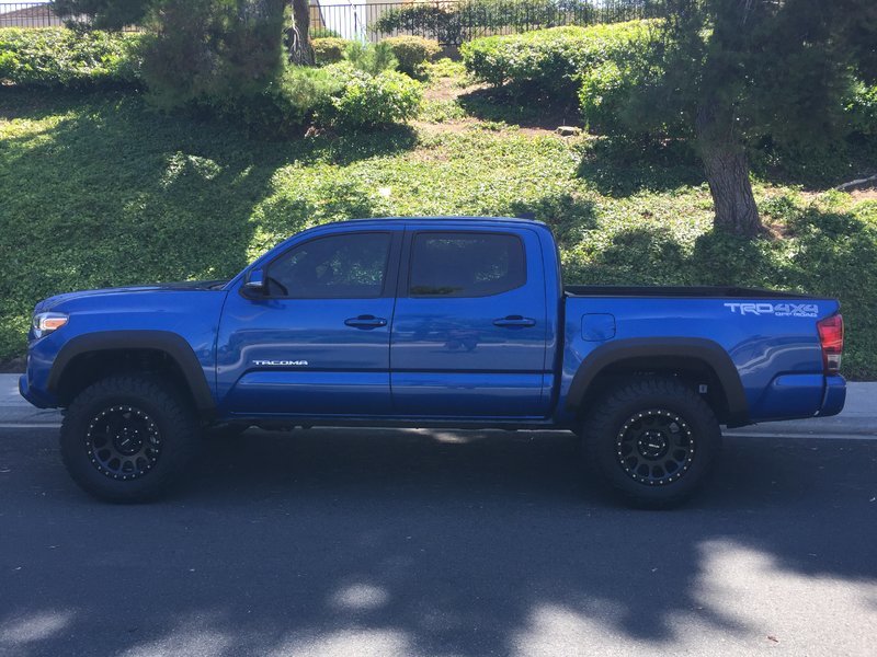

    lift specs?

    whoops don't know why I quoted RPain also (I know how to read) was wondering about the blue truck

    Kit was TTBOSSTAC-2016-BK15 with the 2" add a leaf option instead of the 2" block. I never drove it with just the lift but with the lift and the 285/65R18 bfg t/a ko2 it rides really good. It's a bit stiffer than stock but nothing extreme and a 50 mile drive on the highway was very nice. I was worried the tires might sing on the highway but I couldn't hear them yesterday. According to waze my speedo is a little off. Speedo said 70 mph and waze said I was doing 75 mph. I'm not sure if waze is wrong or if there's a setting in the truck to adjust for tire size.

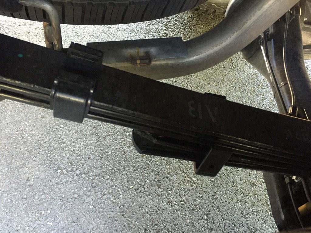

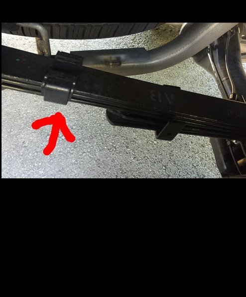

    Did you put new pack over old rivet and bracket?

    What your pointing at is the original. The add a leaf from the kit is much shorter and doesn't extend past the overload. Also as a disclaimer I didn't install the kit. My toyota dealership sells and installs them so less warranty hassle for me. Although they did tell me that putting bigger tires and rims would cancel out the wheel and tire protection extra warranty I got. That does cover aftermarket rims and tires but only in manufacturer recommended size 265/65R17. They processed the cancelation and refund for me.

    The over load is the shortest one and pointing downwards(oem leaf) progressive pack has 3 additional from small about 8" to long about 36" and one of them is resting against (oem) leaf bracket. I think they got it wrong. Take picture from underneath the leaf, the 3rd leaf friction pad must be against the bottom of the top leaf, of its resting on rivet it will make noise, soon... Anyways just heads up.

    image_19_23cc626520fe53d26a48e25f01b4c5f350c816dc.jpg Does this angle help?
