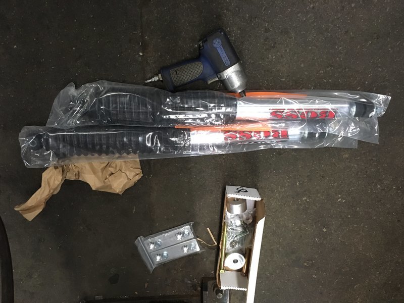

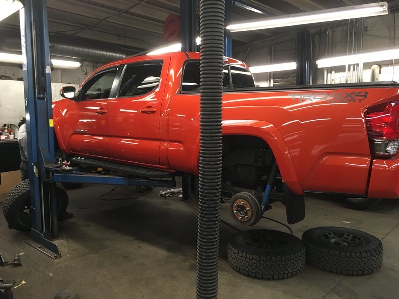

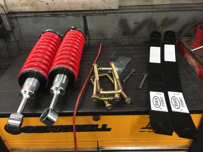

    My parts guy sent me some pics. The Boss 2.0 is going on right now!

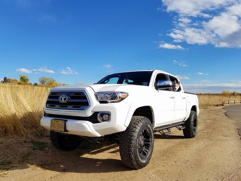

    I'm getting 17 in the city, 18 on the highway.

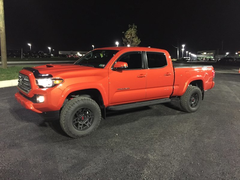

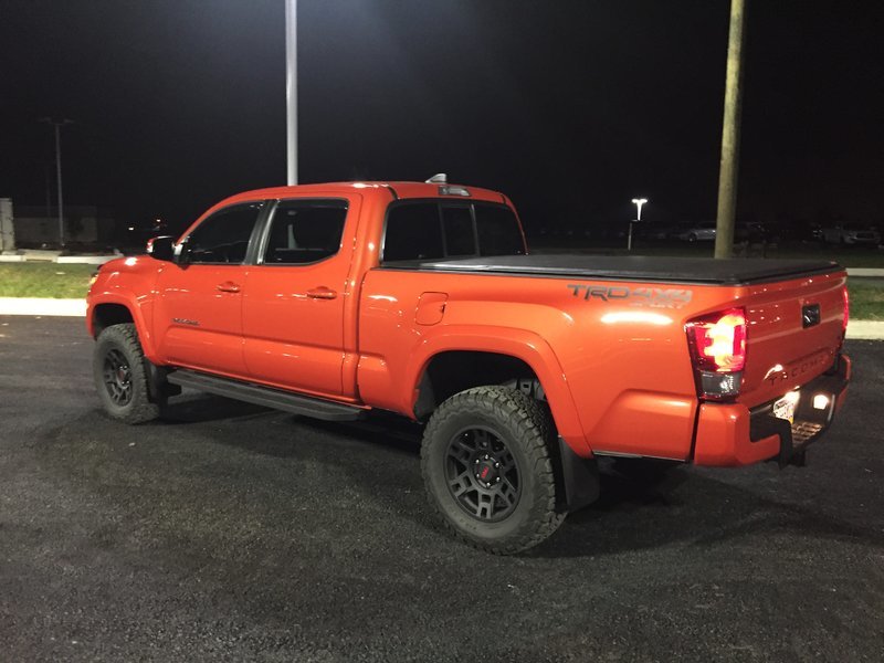

    Just picked it up. Love it!
    Boss 2.0 kit
    The ride is much better than stock! Not firmer, but smoother if that makes sense. Definitely better though in my opinion.
    Truck was half a quart low trans fluid.
    Tsb on the trans was done and there is a noticeable/better feeling now.
    I paid $1789 for the kit and install at Koch Toyota.
    I have 265/70/17 BFG AT KO2's and TRD Pro wheels.
    The front measurement from middle of the hub is 23 1/4" and the rear is 23 3/4".
    If I had to change anything it would be going up to 275's. For now though I think it still looks good but 275's might be in order down the road when I run the tread off these.
    I lost 1 mpg compared to what I normally get coming back from there. I'm won't lose sleep over it. IMG_6585.jpg

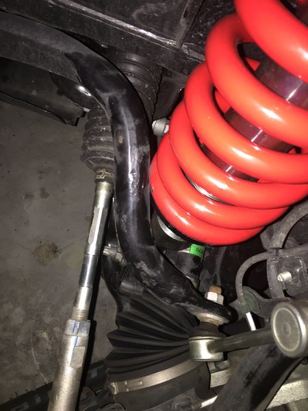

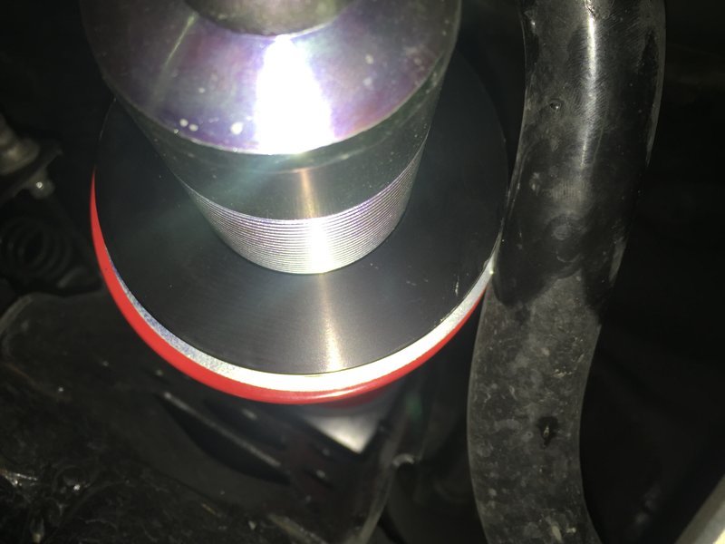

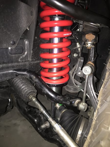

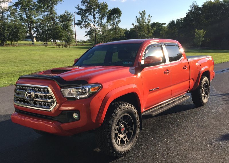

    For those who know more than me on this topic, although I think I know the obvious answer.
    So today with the windows down I heard some rubbing at times coming from up front. I thought I heard it last night to after I picked up the truck so I asked the guy at the dealership. He said give it a week to settle and if you still hear it bring it back.
    It's the faintest of rubbing noise while going over a bump or turn but it's there.
    I just looked under the truck and saw that the sway bar is touching the bottom of the strut on both sides. It should not be touching should it?
  15. Nov 3, 2016 at 5:59 PM
    #3795
    JerryTaco
    JerryTaco Well-Known Member
    Jan 28, 2013
    #96315
    6,862
    Nope, definitely should not be touching. looks like you need the sway bar relocation kit
    2016 Tacoma SR likes this.

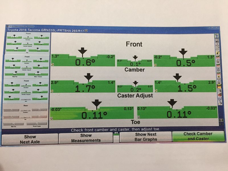

    Had alignment done today and it alleviated all the rubbing!

    Those CV angles look really sharp also, not good. Look into a diff drop as well as the swaybar relocation kit. Personally I don't think removing the swaybar of a majority street driven truck is smart at all, especially if you tow.

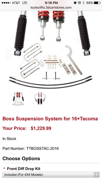

    Thanks. I called the dealer and I'm taking it in tomorrow. The kit I bought was supposed to have the front diff drop kit in it??
