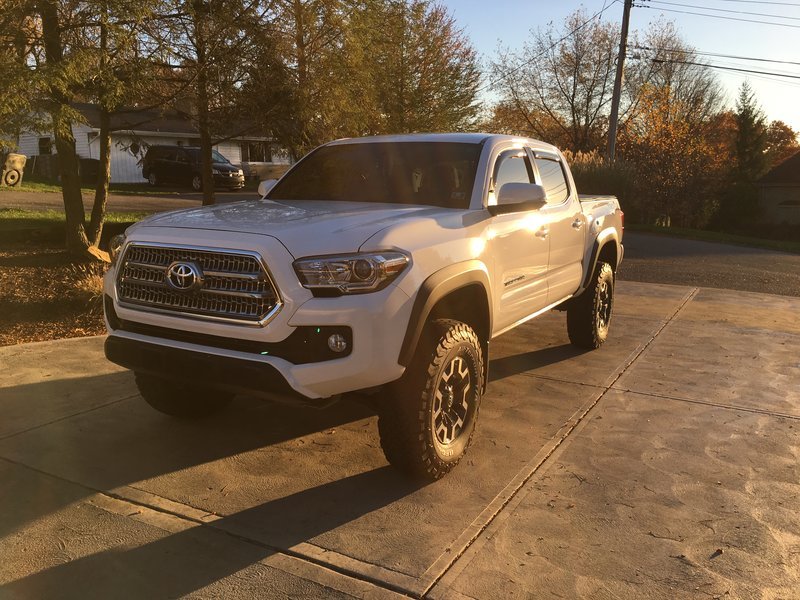

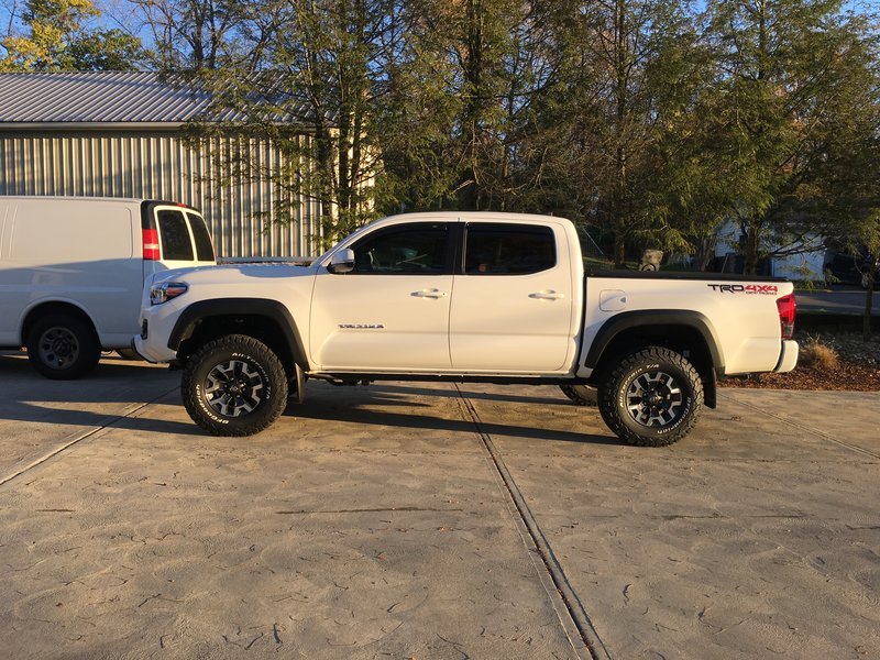

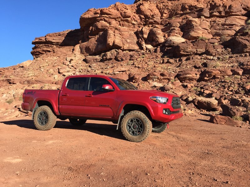

    Rough country 2" front 1.5" rear
    265/75r16
    1" bora wheel spacers
    I'm very happy with this setup
    Ride is more firm than stock but not by much.

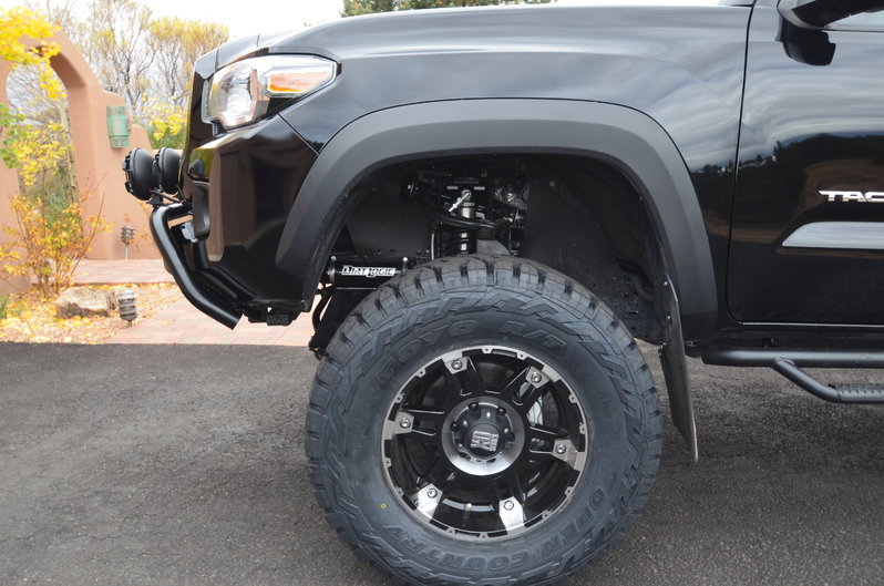

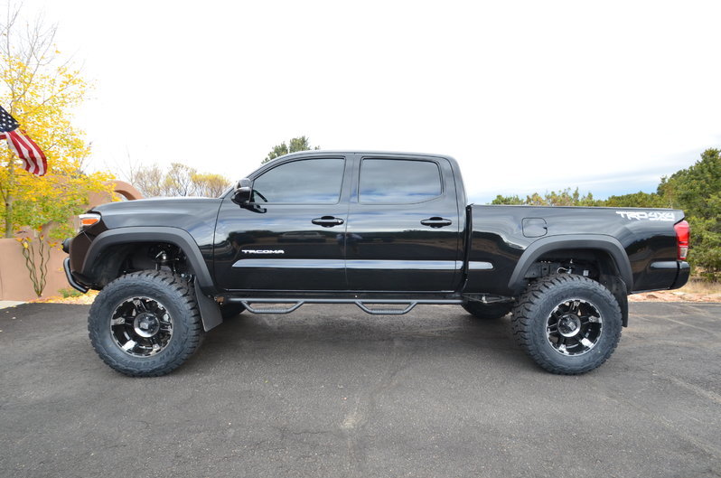

    image.jpg image.jpg Re Do. Took the 3" Procomp lift off and went with the Fabtech 6" with dirt logic coil overs with remote reservoir up front and a new leaf pack and dirt logic shocks with reservoir in the rear. 35" Toyo Open Country RT's. Love the look, and the ride is 100% better. This mod thing just never ends, does it?

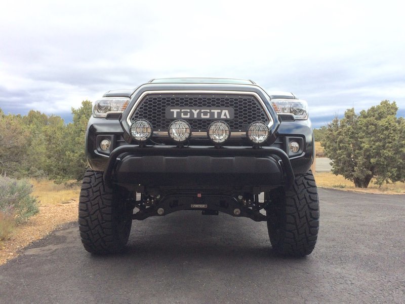

    Dry617, Do you have a front pics of your truck.Do you have info on your front light bar. Tia

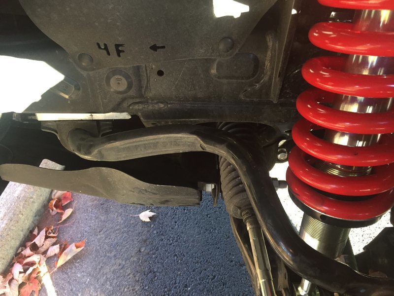

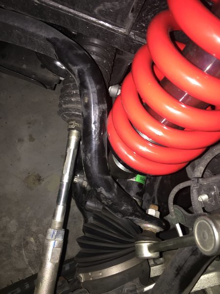

    I'd get the swaybar relocation kit. I only went up 1.5" in the front too.
    Without the kit:
    With the relocation kit:

    Ah wow I didn't realize the swaybar would be that close at 1.5" Thanks for correcting me, that's what we're all here for. Learn something new every day.
