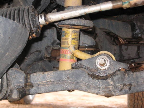

    Right and you figure he was driving it normally, not wheeling it hard? You see how that thing is bent before it broke? Maybe jumped it, who knows. You're also assuming he had coil spacers. How about a complete suspension picture or a link to the article? Ever seen the snap rings on the 5100s fail? I have, everything has a failure rate even when used properly

    He hit a pothole coming out of a parking lot

    Got a link to the whole story including pictures showing spacers? Proof spacers had anything to do with it? Proof it wasn't already bent and failing before the pothole? Google shock failure. See how many bent and broken fox, icon, and every other shock comes up. Actually happens way more often that I expected to see..

    Always seen that picture posted but never saw the backstory. That must've been a hell of a pothole. And parking lot? Would probably need to be exceeding a safe speed in that case.

    There's a whole hell of a lot to that story that's not being told. Maybe a pothole did finish it off but it was already failing long before that.

    Its happened many times on member trucks. One wasn't even a hole, as much as a small dip. All happened with Top plate spacers. They lengthen the shock, and upon rebounding, the shock is over extended, and breaks on the lower end. All instances were due to top plate spacers. SO....Use a top plate spacer, and enjoy the ride, and lift, just drive it like a gandma. Use a preload spacer, and have a ride like an Amish wagon, and enjoy the lift, and off road. OR, Spend a handful of bucks more, and do it right.
