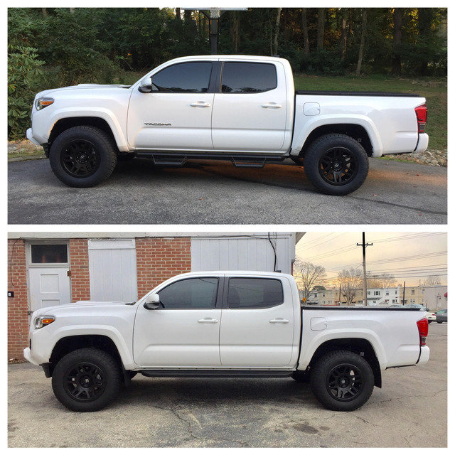

    One of the best looking 2016s I've seen
