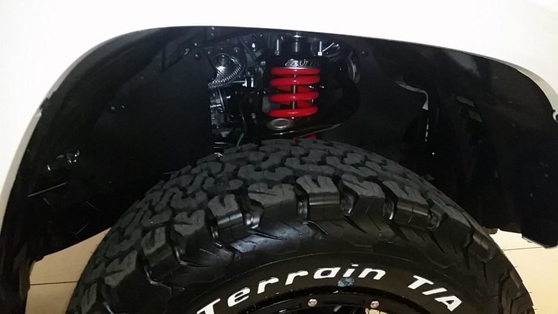

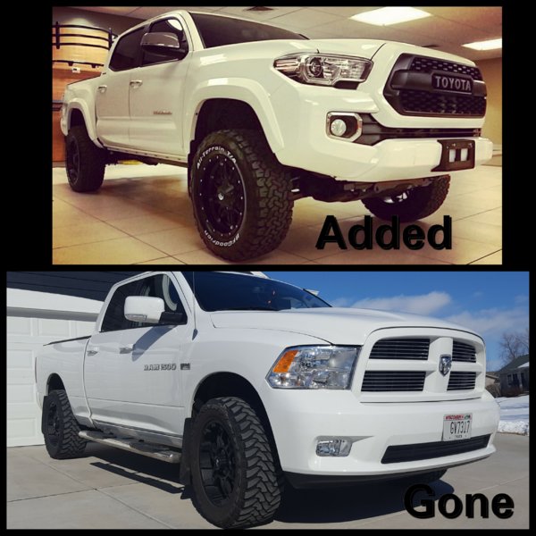

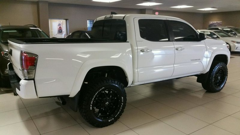

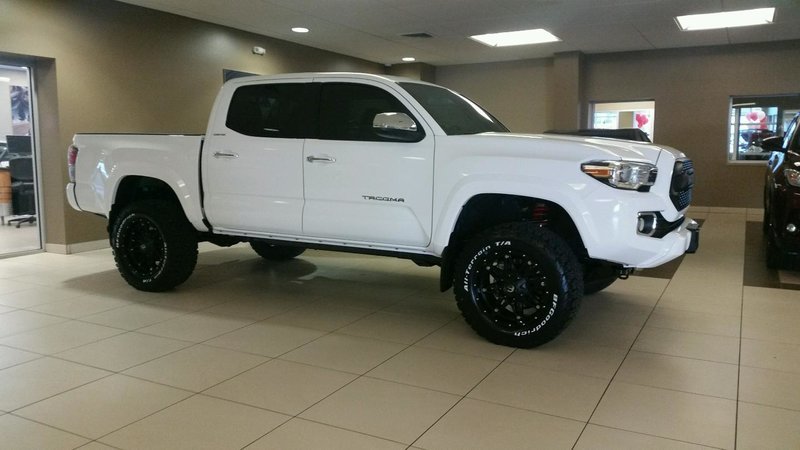

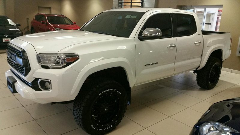

    Front .jpg output.jpg Rear shock.jpg 2017020895162236.jpg 2017020895162223.jpg 2017020895162322.jpg 2017020895162214.jpg 2017020895162236.jpg 2017020895162223.jpg 2017020895162322.jpg

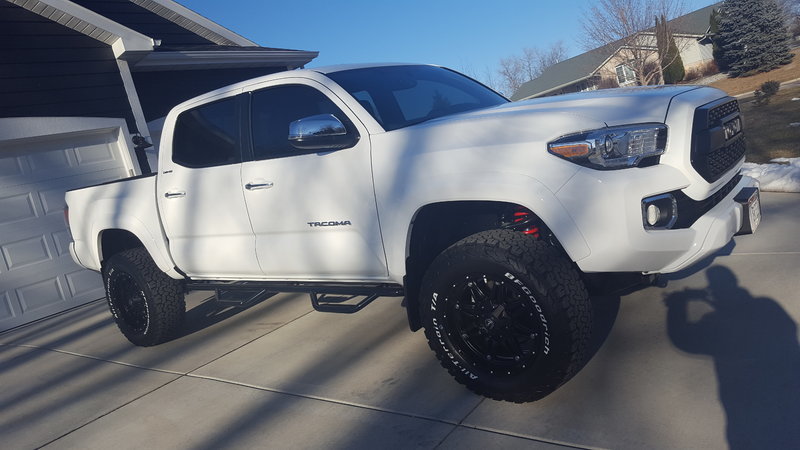

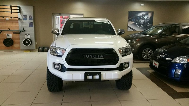

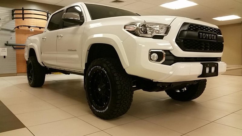

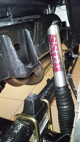

    2017 Limited
    Toytec Boss Lift
    Pro Grille
    Fuel Hostage D531 Wheels -12 offset
    BFG ALL-TERRAIN T/A KO2 285/60/18
    Steps and Cover coming

    Nice. What size tires.

    Thx 285/60/18

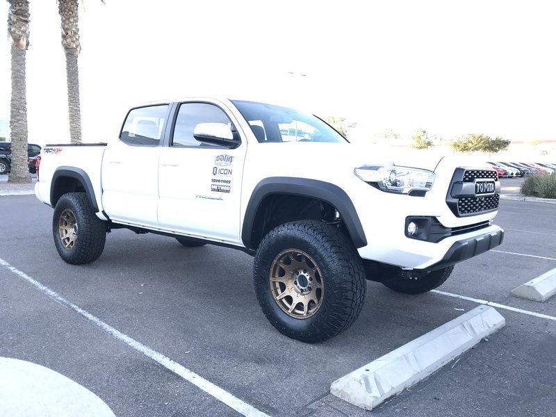

    All of them
    Stage 2 icon kit with bronze method roost wrapped in 285/70/17 Toyo open country A/T's

    I'm considering bronze on my super white as well. Any chance of another pic? Not to be picky, the back light is kinda washing it out a bit. Love the stance on your truck.

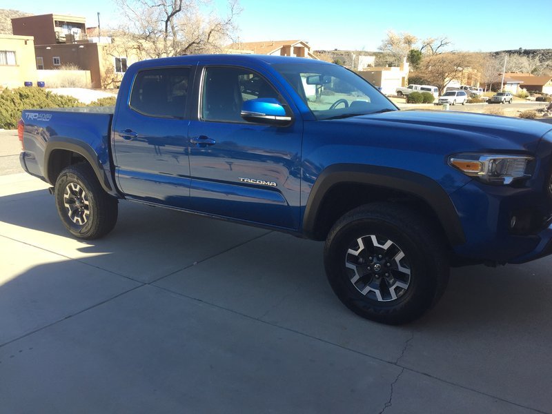

    I think she came together nicely. F/R 5100's, Pro Comp aal, 17" XD Spys wrapped with BFG KO2's.

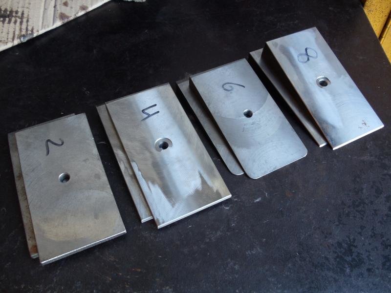

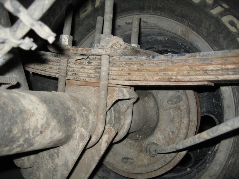

    I've had 2" straight blocks and it would make humm/vibration on acceleration and bad vibration when braking from 20-0 mph. So then I pulled them out made them tappered at 2.7 degree and it rode so much better. Now I have 2" AAL (3 leaf pack) plus 1/2" spacer blocks and 3 degrees shims. Now rides perfect

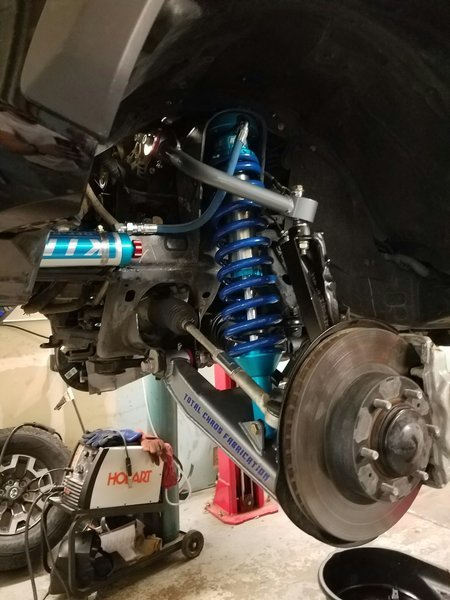

    King Total Chaos Dakar SCS Ray 10 315/75-16 STT Pro
