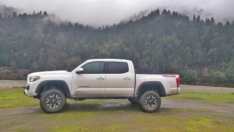

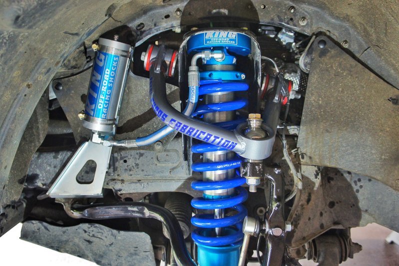

    Kings & total chaos uca's, wheelers progressive AAL (overload removed) & fox 2.0 shocks.

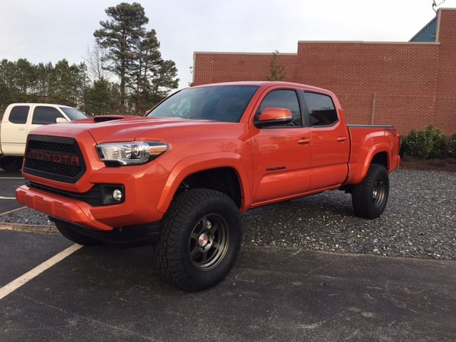

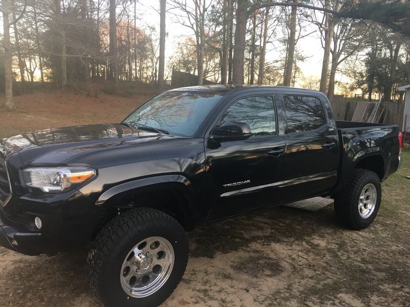

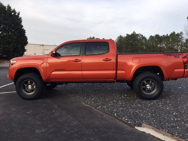

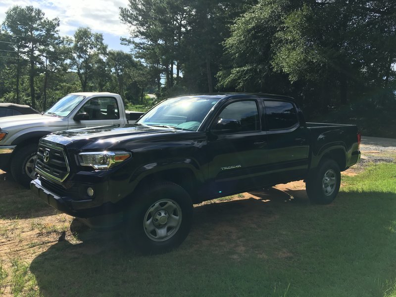

    before and after
    2nd gen 5100s at 3rd notch on stock springs
    rear Deaver aal
    17x9 wheels
    265/70r17 Falken Wildpeak AT3 tires

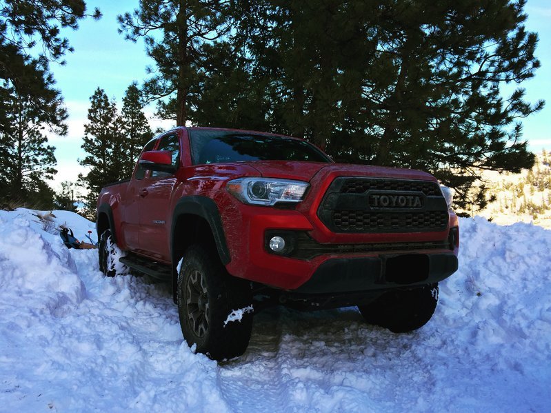

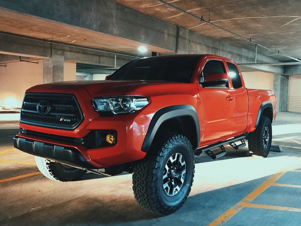

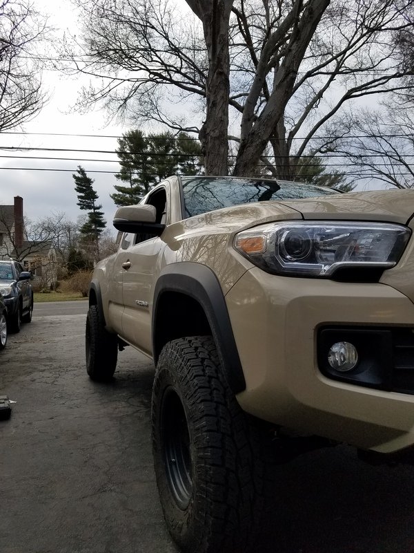

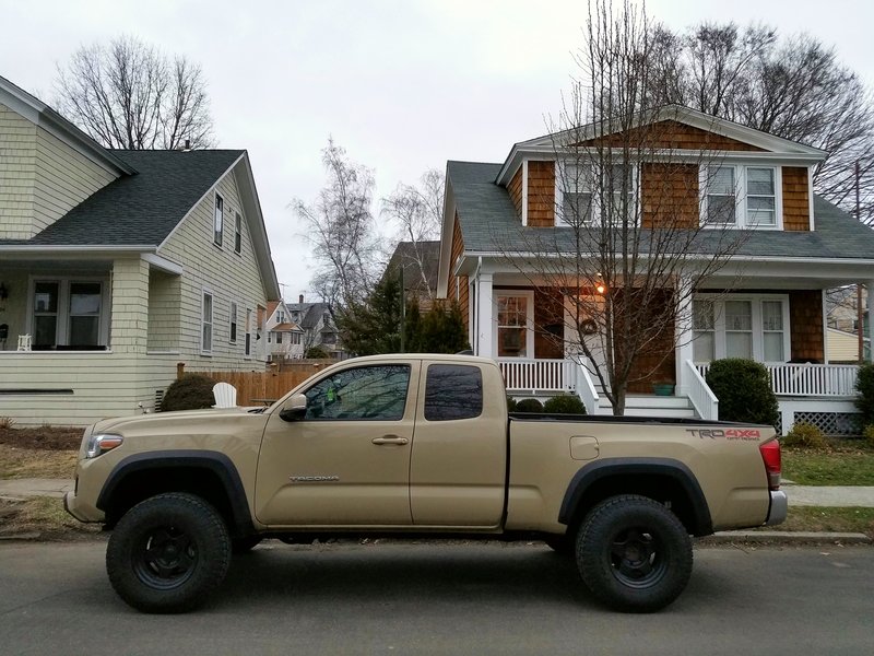

    Ok, so I succesfully installed the lift this weekend and couldn't be happier with the results. Keep in mind this is right after the install and it has settled a little bit since I took these pics. I hope it settles just a little bit more tbh.
    Now I haven't gotten an alignment yet, but I've started to notice a very slight cyclic hum/vibration at certain speeds. I really hope it's not the needle bearing in the differential but I've got a strong feeling it is since I know what a bad alignment feels like. I've also been reading that the differential drop kit is pointless and does nothing to resolve the issue with the needle bearing - I was banking on this fix if I got the vibration. Can I expect this needle bearing to get worse over time? What has everyone been doing to resolve this issue here? Dishing out the cash for a shop to install the ecgs bushing? Is this job really that big of a deal? I promised myself I wouldn't get too crazy with modifying this truck lol. Heeeeere we go again :rolleyes:

    I think you answered your own question. What's your plan for a rear lift at this point? Can't tell from the pic exactly but seems you got a little bro lean going on?

    Slightly bro, but it seems a little bit better this morning. I'll get the tape measure out later. I really haven't thought about the rear too much other than adding the 5100's out back to match the fronts.
    How much are people dishing out for this job? People seem to cringe at the thought of it haha. Can any reputable shop tackle the job?

    Are you mechanically inclined at all? If so you can take your time and do it yourself. You will need that special needle bearing removal tool tho. Search for guys here borrowing the tool from each other. If you want a shop to do it buy the bushing and ask around. Most shops charge between $3-400 bucks. Doubt the dealer will put a non-Toyota part in there for you. And don't waste your time putting the same needle bearing back in. Also, put your truck in 4x4 and see if the vib goes away. If it does then its the drivers side needle bearing.

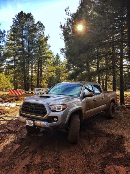

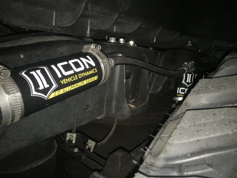

    2016 Silver Tacoma DCLB TRD Sport 4x4
    Stage 4 Icon Lift, Method Grid Wheels with 33in Open Country M/T, CaliRaised Grill LED, BackFlip VP Tonneau Cover

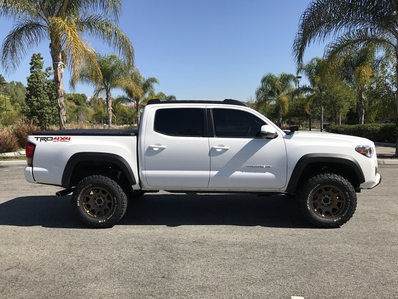

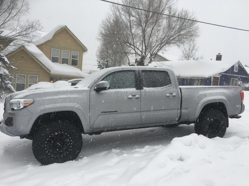

    2016 DCLB SSM
    Icon Stage 4 Lift kit (3in/2in)
    -Front: Coilovers with Reservoirs
    -Rear: Shocks with Reservoirs
    Tires: Toyo M/T 275/75R17
    Rims: Method Grid R17

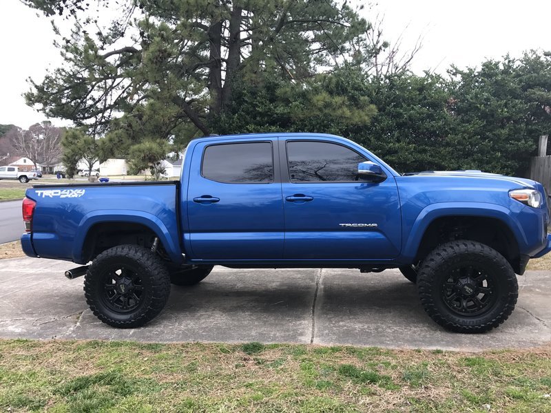

    Details regarding the specifics and tires would be helpful...:pccoffee::deadhorse:

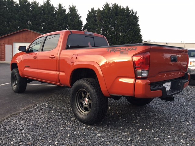

    6" BDS suspension lift, 33" Toyo mud terrain tires, 18x9 -12 moto metal shift wheels.

    I had ordered my 2nd gen 5100s before the 3rd gen 5100s had come out. I just didn't have time to install them till recently.
