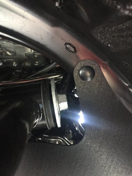

    This guy right here is gonna be your problem.....

    Driver side can be bent not problem, passenger side is the issue.

    Gonna give an angle grinder a try on Friday hopefully.

    Plasma cutter :welder:

    So what was Toyota thinking by making one of the passenger side UCA bolts only removable by cutting out? I guess they expect dealers to do this whenever a UCA, or its bushings, needs replacement? Seems stupid
    Also, if the oem one doesn't fit coming out, how are y'all getting the new one back in?

    You can put the bolt in the opposite direction when you reinstall it. Plenty of room to do it that way, just make sure to add some loctite to the threads as an added safety precaution.
