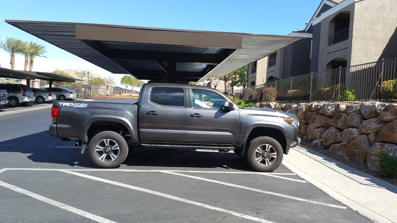

    2017 MGM TRD SPORT DCSB 4X4
    Bilstein 6112/5160 JBA UCA
    6112 front set at top setting driver side and 5th setting passengr side.
    5160 in rears with 1 inch block.
    Just installed when it settles front should give me 2 inches in front. Right after install gave me 2 1/4 up front. Truck should settle at even 23 inches from hub to center.
    Had ECGS bushing installed at same time.
    Alignment will be tomorrow.

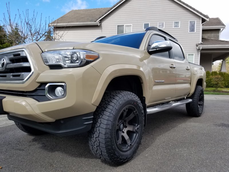

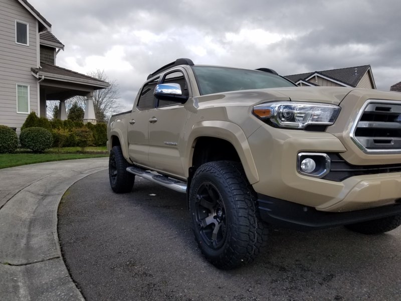

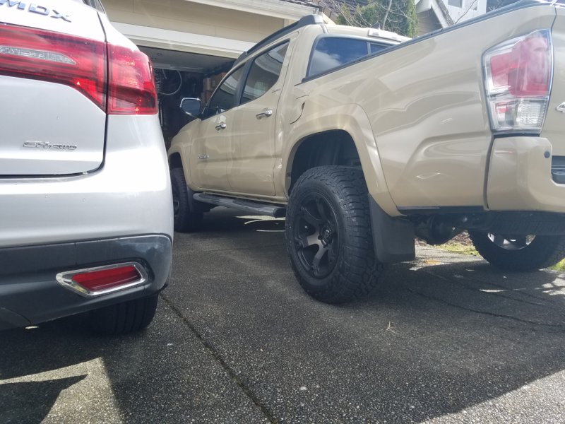

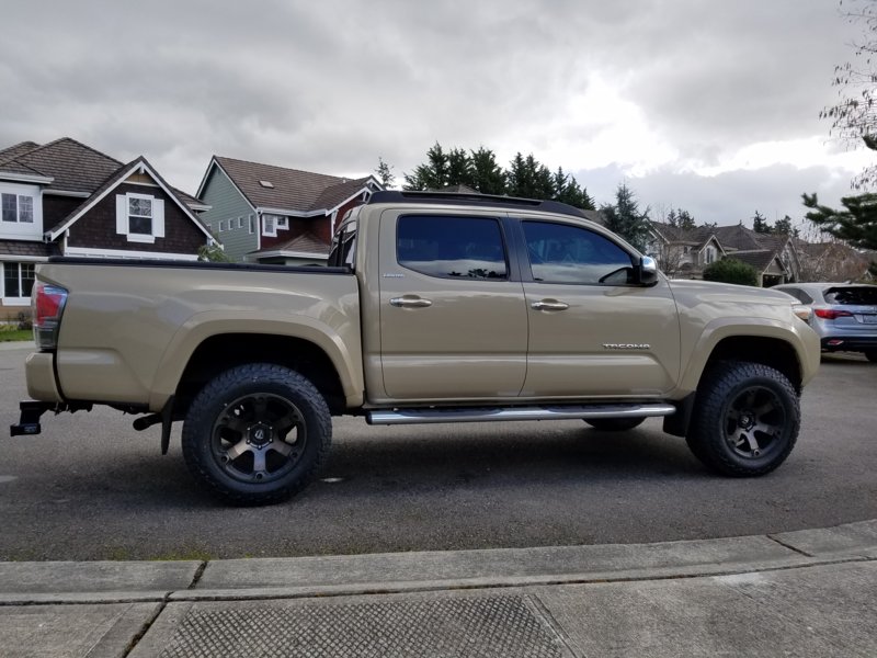

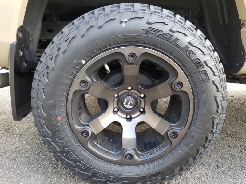

    2016 Quicksand Tacoma Limited
    wheels : Fuel Beast 18/9 -12 offset
    Tires: Falken Wildpeak 265/65/18
    Lift: Revtec 3 inch leveling kit with ECGS bushing.
