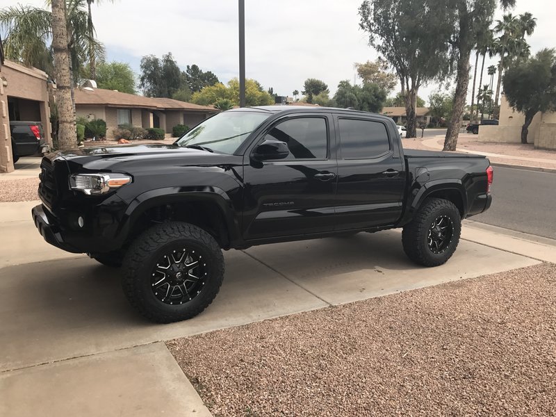

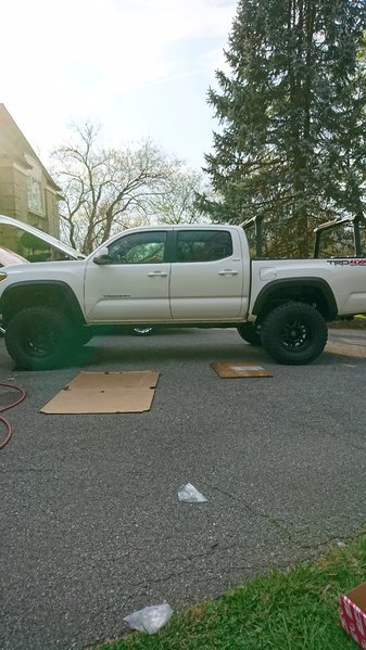

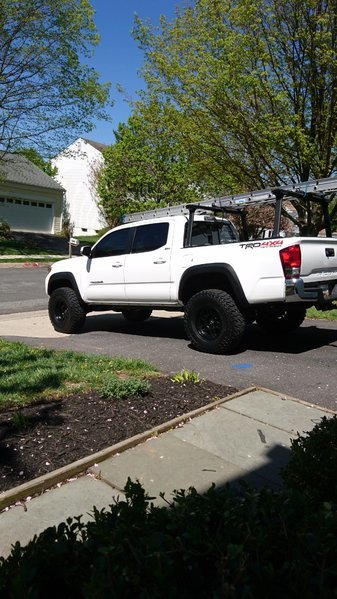

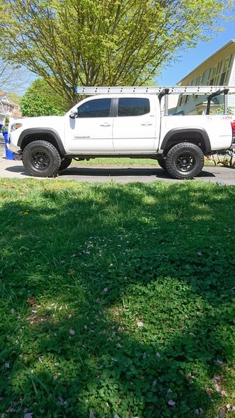

    Just did mine. 887, 5100's, full Dakars.
    285 75 16 3.5 backspacing and -25 offset. It rubs pretty good. I'm still trimming. Love the look though. Unfortunately I don't know how to post pics from my cell phone. I don't even use a computer.

    how much lift does that equal? have you done cmc?

    I did hack the cab mounts. Now I need to fine tune the plasti

    beautiful looking truck!!

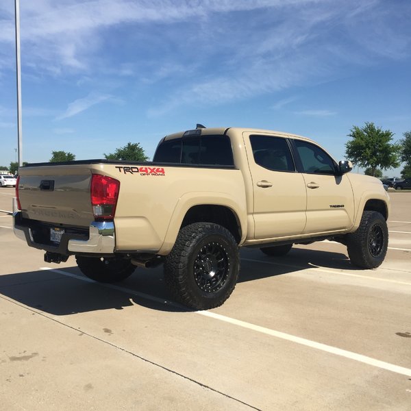

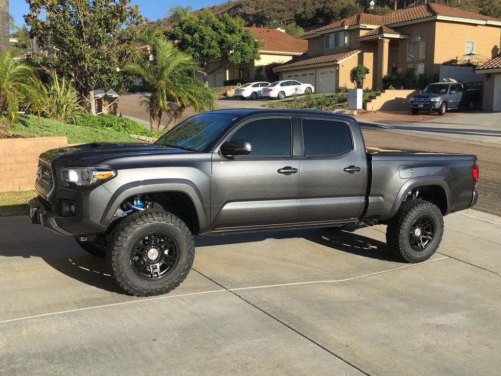

    Front: King 2.5 coilover w/ compression adjusters
    Total chaos UCA's
    Rear: King 2.5 shocks w/ compressions adjusters
    Dakar leaf pack
    (5) 285/70/17 Cooper Stt pros
    (5) SCS F5 -38mm, 3.5" BS
    1.25" spidertrax wheel spacers

    beautiful build man.. 285/75/17 is pretty close to 33x11.5 you think you could fit another inch wide??
    ive got 33x12.5 right now with kings on order... wondering if theyll fit before I test fit :D

    Thank you! And yeah I'm sure, it'll just rub more. I actually just took off the spacers since I'm taking a small trip this weekend. But it def rubs more with the spacers, or if tires are wider

    Does your tires rub on your fender flares? Could you LMK how many inches of thread is showing above the coilover collar.

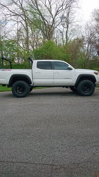

    Front: bil 5100's ome 888 driver's side 1/4" lean spacer, spc lr uca's
    ecgs bushing swap while in there, moog outer tie rod ends just because
    Rear: Dakar leaf packs, rcd/bil ext length rear shocks, new ss brake lines
    Tires: Cooper ST Maxx 255/85/16 on factory or rims

    Looks great!! Are you running any spacers? Any rubbing?

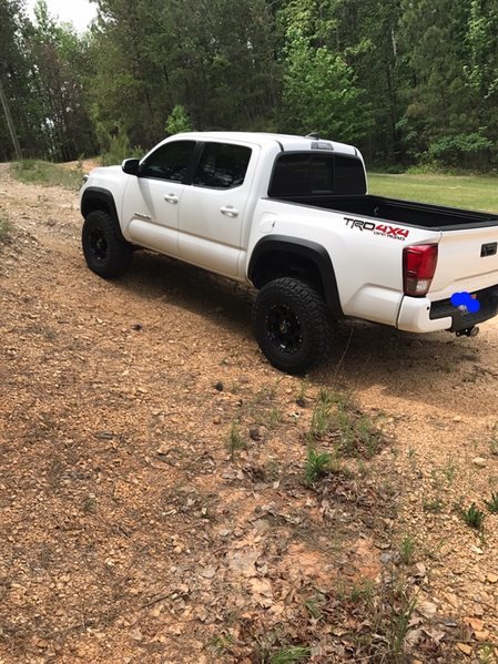

    Total Chaos UCA's, Raceline Raptor wheels (16x8) 4.5 BS, 285/75/16 Cooper S/T Maxx tires, Icon Stage 2 Lift Kit, Sos sliders w/ fill plates, exhaust reroute, mobtown offroad skid plates (ifs, transmission, transfer case), and diff breather mod

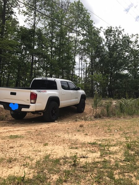

    Icon stage 2

    Thanks. I'm not running any spacers and have no rubbing whatsoever even when flexed.
