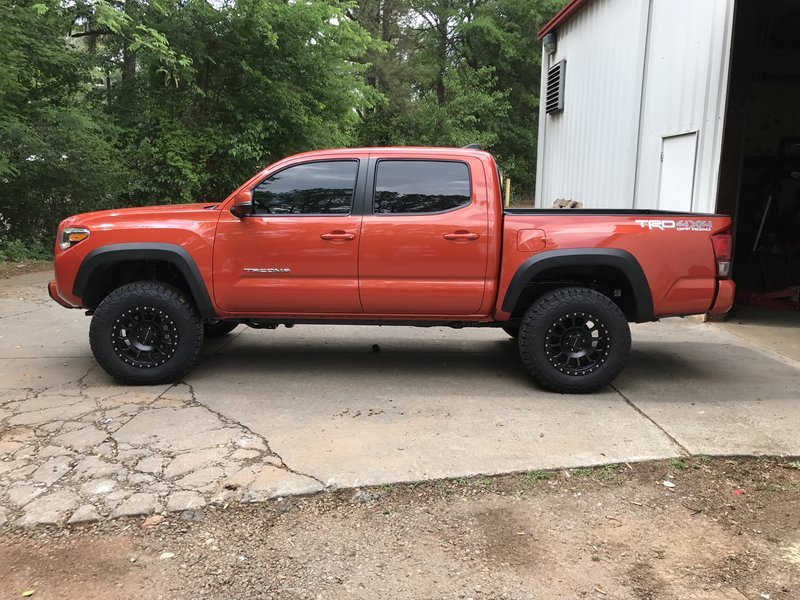

    Just got it leveled with new wheels and tires

    Very nice, specs?

    Before front L 20.5 R 20.66 Rear L 21.58 R 22.16. End Front L 23.25 R 23.5 Rear L 23.25 R 23.5. Taken in the same spot using a 3 count average.

    Forgot to measure at full droop on rack. Was a tid bit too excited to get it on lol

    What size tires

    265/70/17

    What wheels are those and what lift did you go with? Truck looks awsome!

    Pro comp Rockwell. 2.25" front 1" back pro comp
