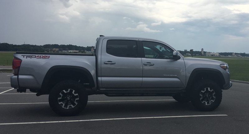

    Installed Bilsteins today set at 0.65" up front and now my RWD is perfectly level at 21.5" fender edge to wheel center on all 4 corners. No lean.

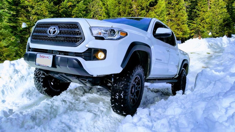

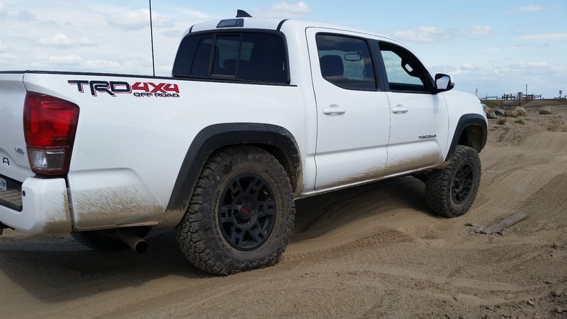

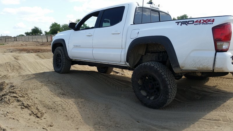

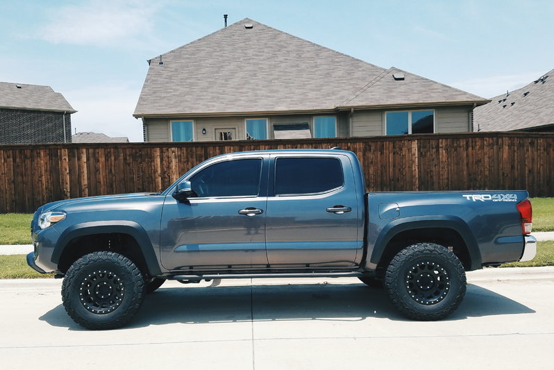

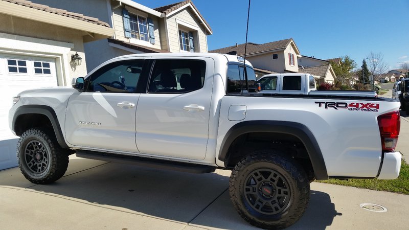

    Proud of my set-up....so posting it around today. I cant miss putting it in this sub!
    3-1/4" Front with Bilstein Gen. 2 5100s (set to 0), OME 888 coils, and LR Upper Control Arms
    2" Rear with Headstrong Progressive AAL with Overload still in
    4Runner TRD Pro wheels (I believe 17x7 or 8?) Im thinking of getting SpiderTrax 1-1/4" wheel spacers....
    BF Goodrich 275/70/17 K"Bro"2 tires (just under 33")

    This is my exact kit. Except I added the LR upper control arm. It is an awesome deal! I also bought toytec sway bar relocation. Sadly, I only have 275/70/17, but I should've done the 285 for the looks.

    Nice setup! You have plenty of clearance with the 275/70s

    Samsonite88, Do you think the uca were a necessary and did you get any settling of the coils?

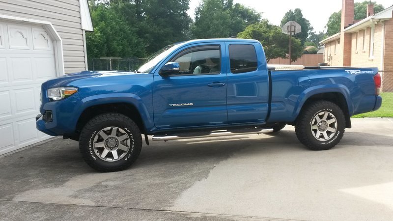

    Hoping to get the AAL on this weekend.

    Nice, did you replace uca? I am contimplating between 887 and 888 coils. I hear from different people that they settle and some dont

    What lift in front?

    2nd gen 6112 on 5th notch. Right at 2.5" lift.

    With how much lift I got (about 3-1/4" after settle), I would HIGHLY suggest UCAs. If you don't get them, your rig will track poorly and feel skittish due to not being able to get a proper alignment. The Light Racing UCA are the least expensive and have the awesome articulation (I did a ton of research on their angles/degrees of motion vs uniball UCAs). ALL coils will settle. However I think mine only settled just over 1/4". Zero issues with 275/70/17, and they are on "stock" toyota rims. I wouldn't see too much of an issue except in extreme cases off road with 285s, or if you don't do a UCA where they can properly adjust your tire position.

    I really like how that looks. I want to go with the same setup.
    What notch setting did you go with on the coil overs?
    Did you have to upgrades UCAs?
