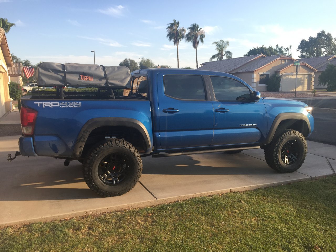

    Bilstein 6112 and 5160 BFG 265/75/16 KO2 ECGS
    It's set on 5/4 to compensate for the taco lean. 1.5" AAL in the rear with the overload removed. Factory control arms will work fine. But I would recommend while you are in there going ahead and doing the u-bolt flip kit and replacing the bumpstops with the superbumps kit.

    I got about 1.5" all the way around, so essentially I kept the factory rake. I get compliments on it almost everyday. You will love the look and the ride is even better!!!

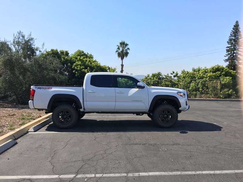

    Looks great. What size tire/wheels? I combed a few pages since you posted and couldn't find it if you posted. Thanks!
    c4lvinnn[QUOTED] likes this.
  13. Jun 27, 2017 at 8:37 AM
    #5073
    c4lvinnn
    c4lvinnn Well-Known Member
    Sep 30, 2016
    #198603
    2,128
    '17 TRD Off Road DCSB
    Thanks!
    Fronts:
    2nd Gen Tacoma Bilstein 6112 set at 5th (highest notch). 3rd gen 6112 has 6 notches (theoretically lifts higher)
    Right at 2.5" lift
    Rears:
    Bilstein 5125
    Icon Add-a-leaf (AAL)
    1.5ish inch lift
    16x8 ET0 (4.5" backspace) with 265/75/16. Will be going 285/75/16 sometime
    Ground to fender:
    DF: 37.25
    DR: 38.5
    PF: 37.5
    PR: 39

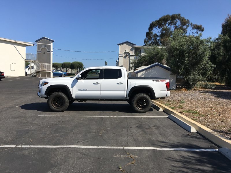

    After reading through this thread it seems a lot of you had some rake before the lift and tried to achieve level after the lift. I have a 2016 TRD Sport that is already level? 21" center of wheel to fender all around. I bought it used last September and have looked for spacers but don't see anything that I can tell. Seems to be stock.
    I would like to get just around 3/4" of lift so I was thinking about...the sqeemish should look away at this point...getting some 1/2" spacers up front that should equate to about 3/4" of lift. They would be top spacers. Then add a 3/4" block in the back (if they make such a thing). The thinking is that I would stay level going this route and still get the amount of lift I am looking for. I would also stay within the travel range of the rear shocks. Since the truck is still basically new, under warranty and I would only do mild offroading for now, would this be a viable way to go?

    Are you sure you don't already have Bilstein shocks up front. It is really odd to have no rake. The reason I ask is that with the Bilsteins you can adjust up to the next ring groove and not need spacers. Just a thought. Mine is rwd so the rake was very apparent when I bought it new and most that I have seen, even 4 x 4, had some rake. Mine is perfectly level at 21.5" on all 4 corners after adding the Bilsteins up front. I have not installed the rear yet but they do accommodate up to a 1" lift/block.

    This is it:20170607_193800.jpg
    This picture makes it look nose high but it's level.
