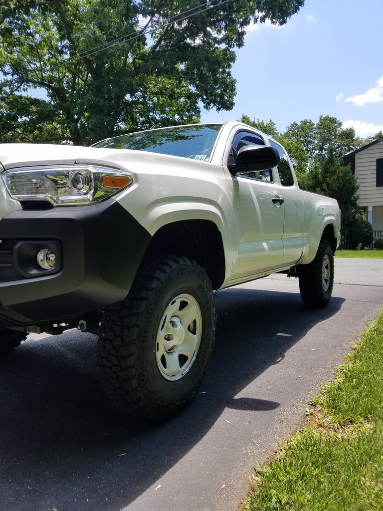

    finally able to lift my taco, low range off 3/1 lift level kit and 255 85 16s on stock steelies

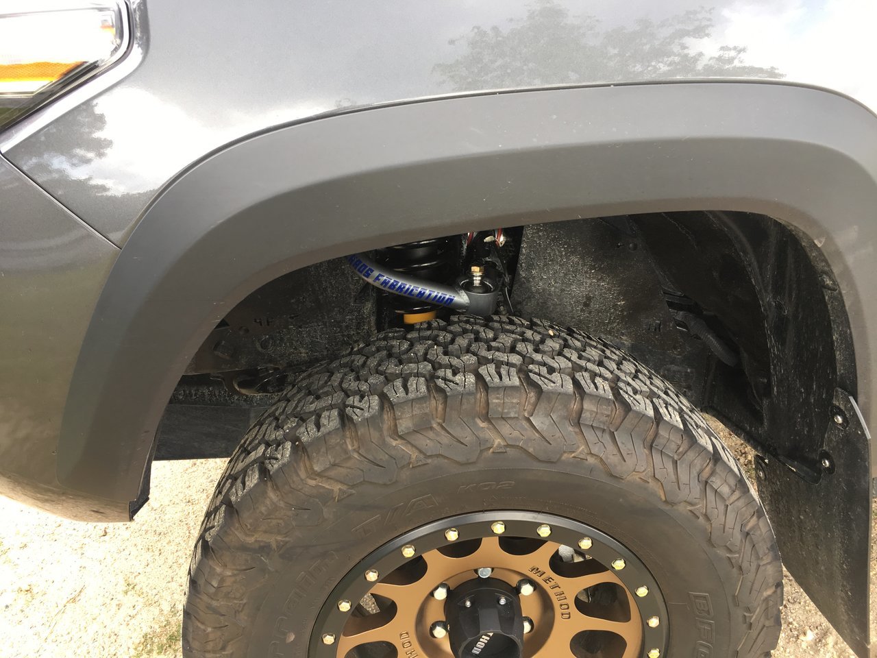

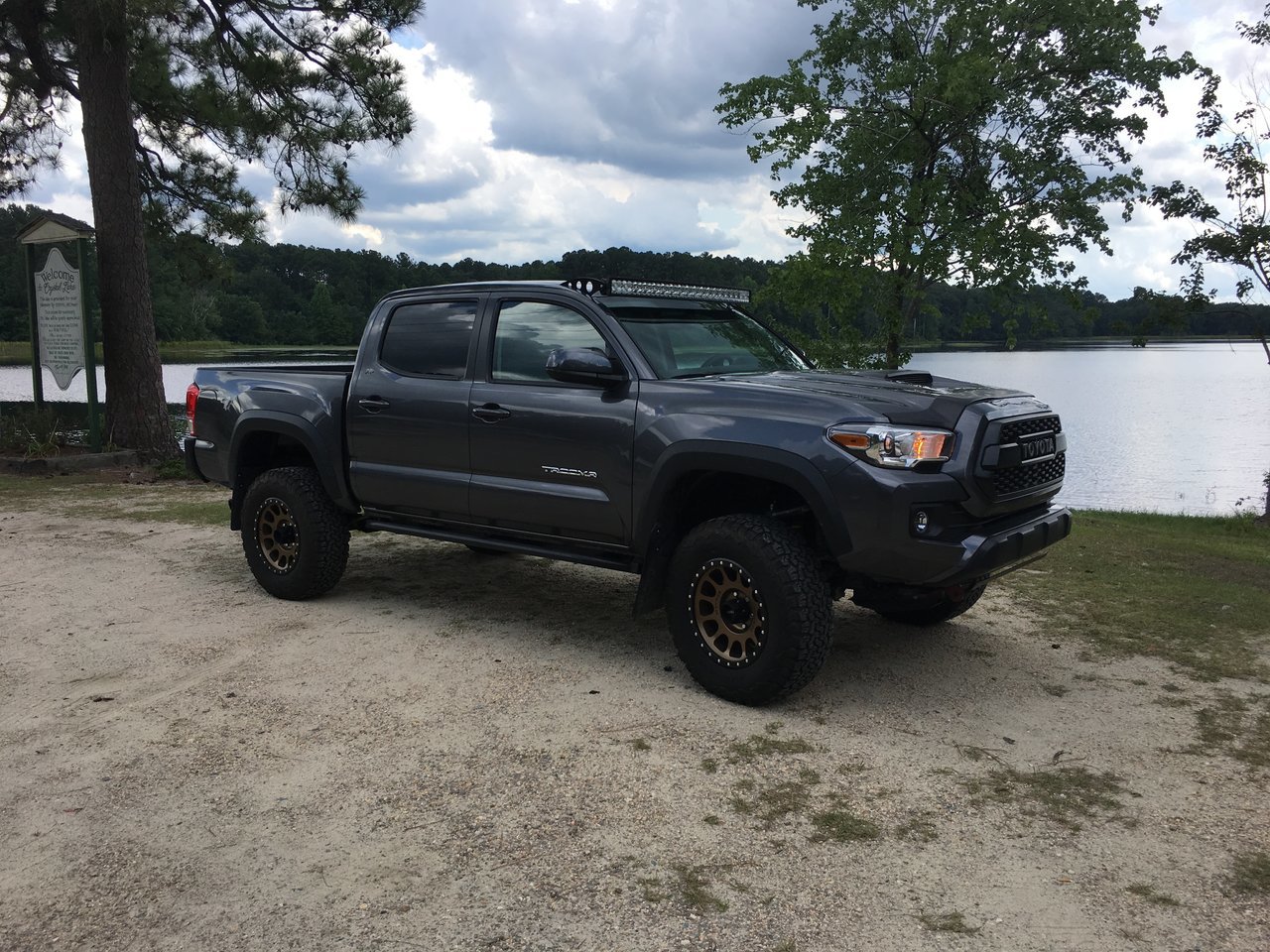

    METHOD | SOS | C4 | RIGID | PRINSU | OME | TC
    OME Nitrocharger
    OME 886
    Dakar HD
    TC UCAs
    ECGS bushing
    Fortunt1, SilverII, PNWTacoma and 3 others like this.

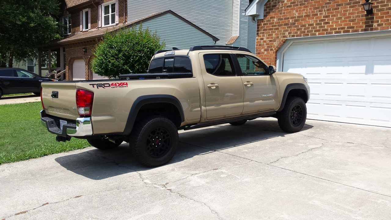

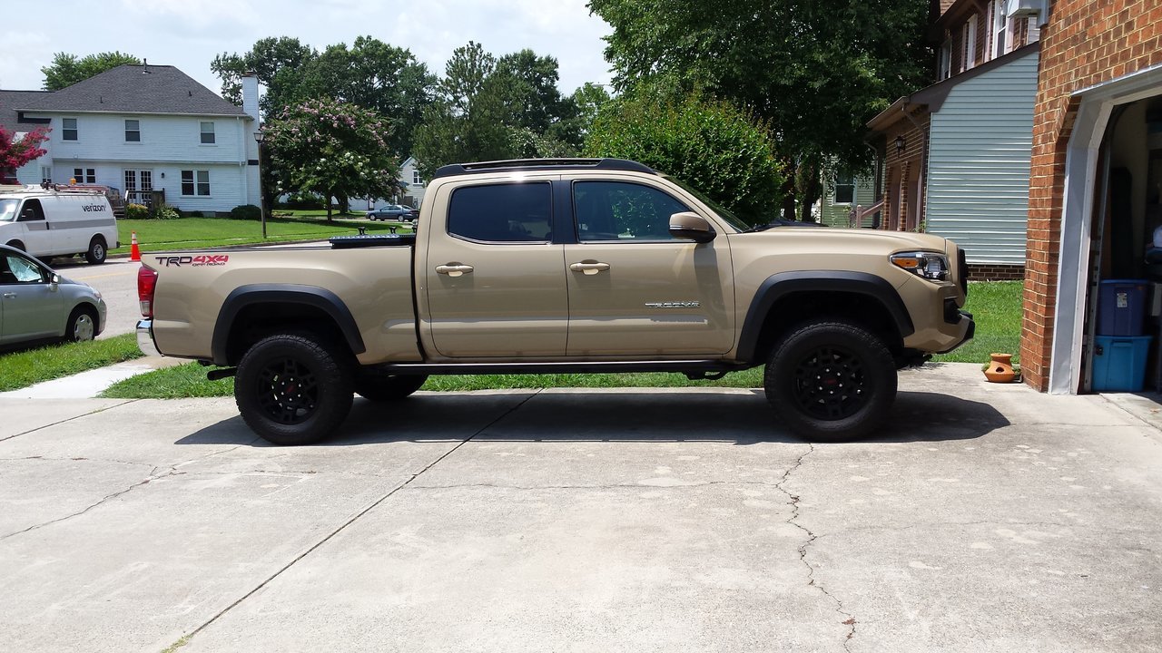

    Finally lifted mine after 18 months and 20k miles. Before on the stock suspension, tires are 265/70/17 Nitto Terra Grapplers.
    I wanted to bump it up about 2 inches and maintain the factory rake so I went with:
    OME 885 coils
    5100s (2nd gen) all around, front set to 0
    Wheelers 3 leaf Progressive AAL with overload leaf left in
    Driver side 1/4 in spacer
    Did the ECGS bushing replacement as a preventive measure.
    Gained about 2.25 inches front and back right after install, I anticipate the springs will settle about 0.5 - 1.0 inches in a week or so.
    Hard to tell with the slope of my driveway but the rear is about 0.75 inches higher in the rear than front even with the toolbox and 100lbs of stuff in it.
    Rides just like the OEM bilstein shocks which I really liked, just wanted to have a little more height without making the tires look too small.
    Very pleased with the results.
