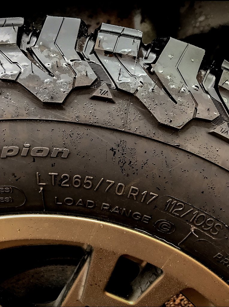

    Got the wheel/tire combo installed before i was planning on lift, sticks out a bit making measuring from the center cap of the wheel to bottom fender not 100% accurate but i would say about 2.2" front and 2.5" rear lift, maintaining a slight factory rake which i love.

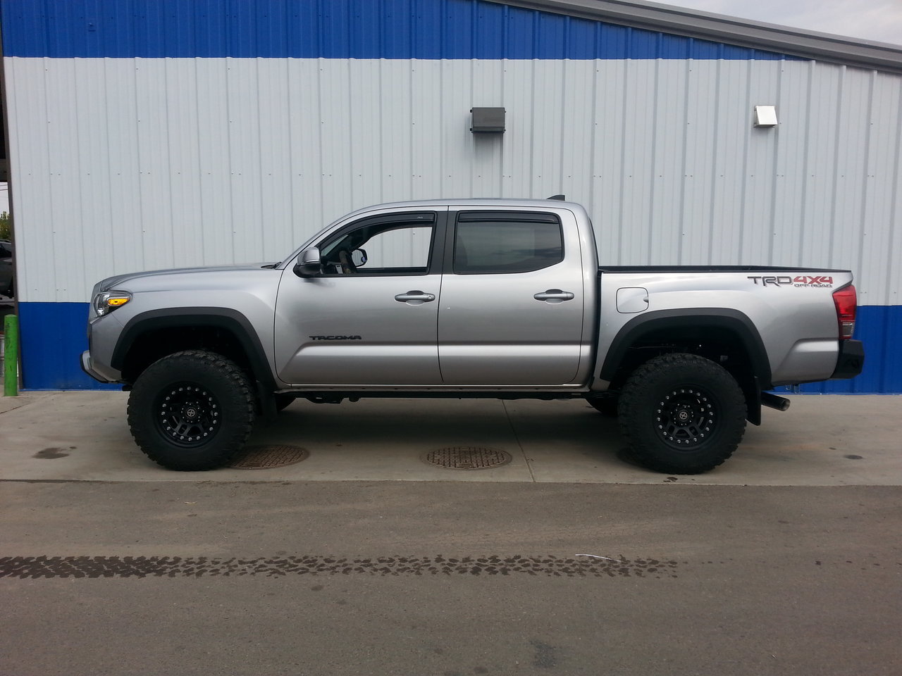

    3" leveling kit
    20170805_171426.jpg I got full 3in in the front and 2in in the rear,
    I'm going for 285/75/16 tires now.

    265 or 275 tire?

    265/70-17, got this last year when I wasn't planning on lift.

    Looks good. Have the same size tire on my lifted truck and I keep wondering if the tires look too small or it's just my imagination. You've confirmed my decision to stay that size.

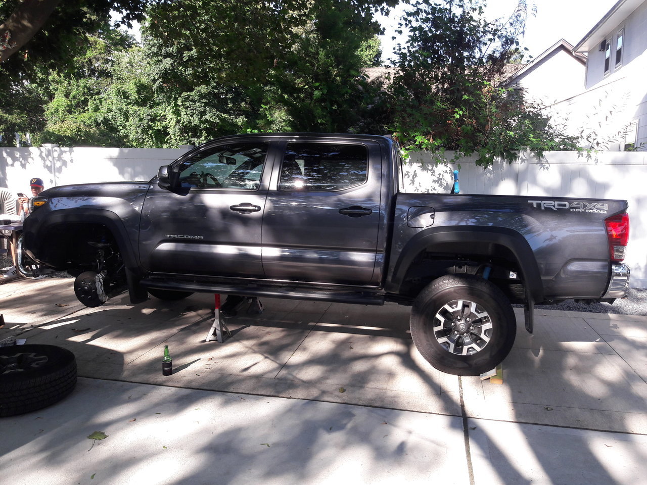

    Nothing crazy, Pulled the stock OR springs/struts, threw on the Bilstein 5100's loaded w/OME 887 springs. I kept the stock UCA's for now since I was getting the stink eye from the wife. 5100's on the rear paired with some cast 1.5" Maxtrac blocks and longer U-Bolts. Got lucky on a set SCS SR8's, wrapped them in E Load 265/75/16 K02's. Just ordered an OME Dakar leaf pack, and an allpro U-Bolt flip kit w/timbren bump stops.

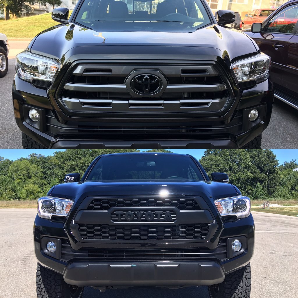

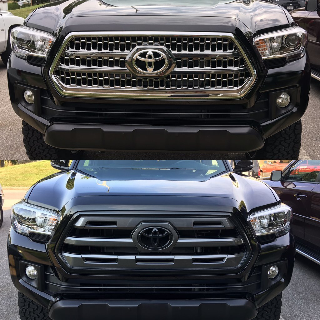

    Thanks @AtlasPilot the chrome emblems and trim weren't horrible, I just elevate more to the clean black look. I removed the chrome bumper caps, and hit them with satin black and a couple coats of clear. Really happy with the way it turned out. Since then I've played with the front grille assembly to try and complete the look. Picked up a Limited Grille and blacked out the bezel and emblem. But the Limited grille has a gunmetal finish unlike the SR and SR5 which is black, that kinda bugged me for the week. So I pulled the trigger on a cutom car grille mesh insert with large "Toyota" text. Was hella stoked when it arrived, only to find it would fit as I was sent the wrong grille. Coincidentally this around the time the "TRD Pro Replica Grill" thread was kicking up, so I pulled the trigger on a "Faux Pro Grille" to round out the Black look.

    64
    2017 Tacoma TRD Off Road Quicksand
    Icon Stage 1 with full Dakar Medium Duty leafs ordered from Headstrong Off Road.
    Measurements before the lift:
    Front Driver - 34.5"
    Front Passenger - 35"
    Rear Driver - 36"
    Rear Passenger - 36"
    Measurements after the lift:
    Front Driver - 36.0"
    Front Passenger - 36.5"
    Rear Driver - 38"
    Rear Passenger - 38"
    Overall, gained 1.5" in the front and 2" in the rear. I will adjust the front coilovers to a full 2" once I get new UCAs. Rides so much nicer and the Dakars handle the static weight I have in the bed like a champ! Installed everything myself with the help of a couple friends. Took exactly 4 hours.
