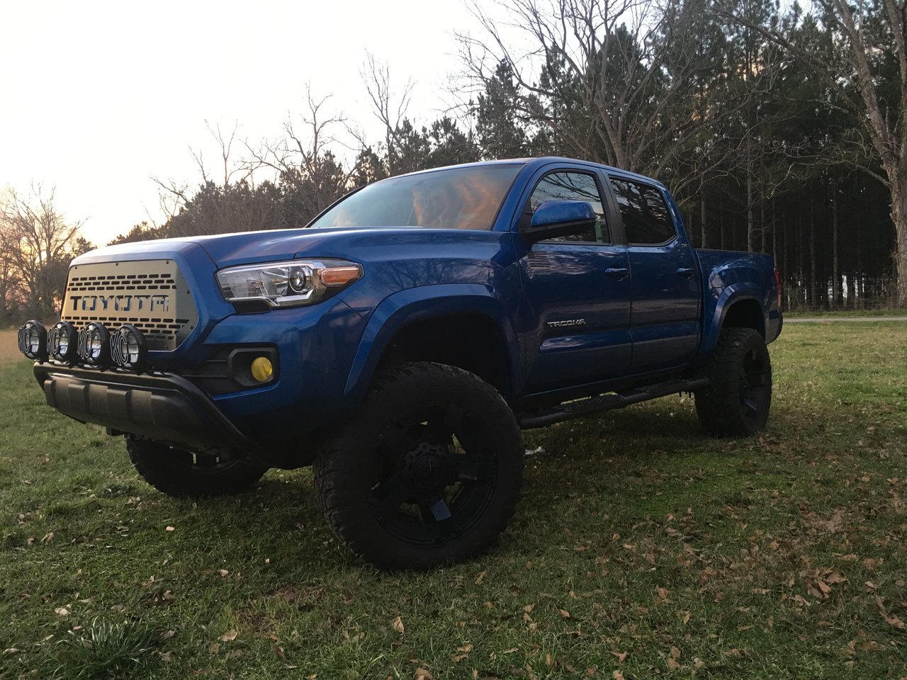

    Beautiful Mississippi day, time for a bathAAFDCE64-7F35-48AA-A356-37C2B6F9453B.jpg

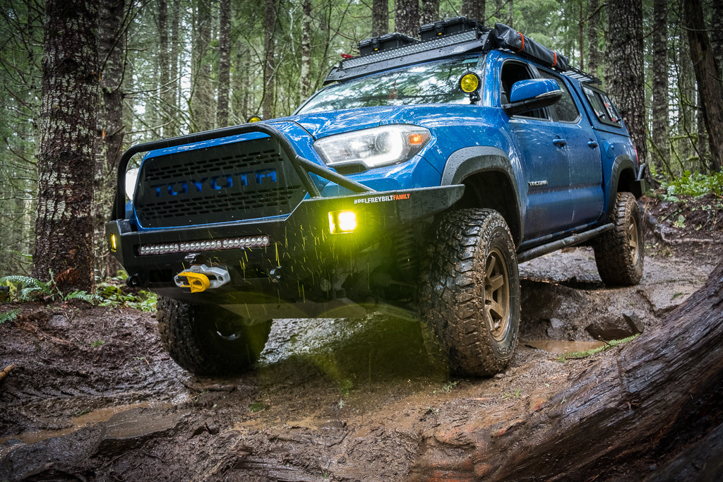

  2. Feb 18, 2018 at 6:42 PM
    #5282
    PDX_Cray
    PDX_Cray Well-Known Member
    May 11, 2016
    #186723
    201
    2016 Tacoma Blue

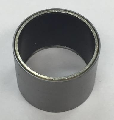

  4. Feb 18, 2018 at 10:08 PM
    #5284
    RangerComa
    RangerComa 58008
    Mar 14, 2017
    #213317
    2,829
    Adam
    Marin, CA
    17 DCLB
    list is growing fast

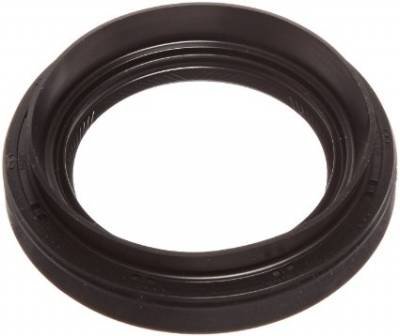

    just realized you said passenger side. the short answer is no. needle bearing is only on driver side.
    Find a straight smooth road where you can feel the vibe and do this. ^^^ If vibe goes away, it's needle bearing. If not, well crap... good luck.

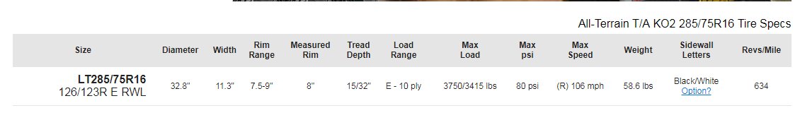

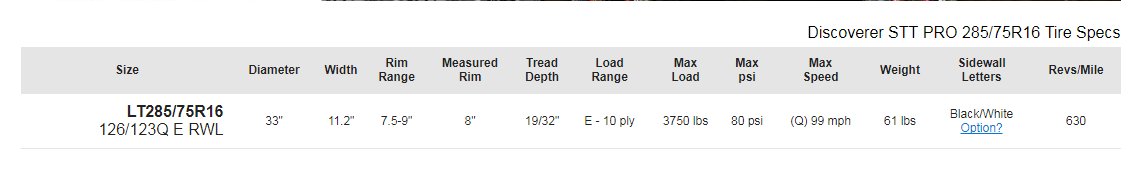

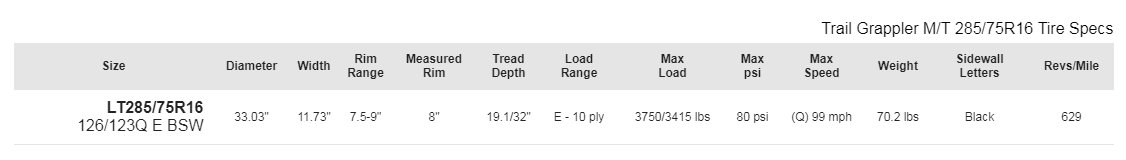

    Yes, the offset of the wheel will definitely come into play. So will the backspacing, the width of the wheel, and the width of the tire. Not all 285's are created equally.
    If you are looking at a 16" wheel, then 0 offset and 4.5" of backspacing on an 8" wheel will help, but then also take into consideration of the actual tire that you will be wanting to run.
    For example: A Nitto Trail Grappler
    Cooper ST Maxx
    Cooper ST Pro
    BFG KO 2
    Falken Wildpeak A/T3W
    Just some examples of how the same "size" tires are actually different.

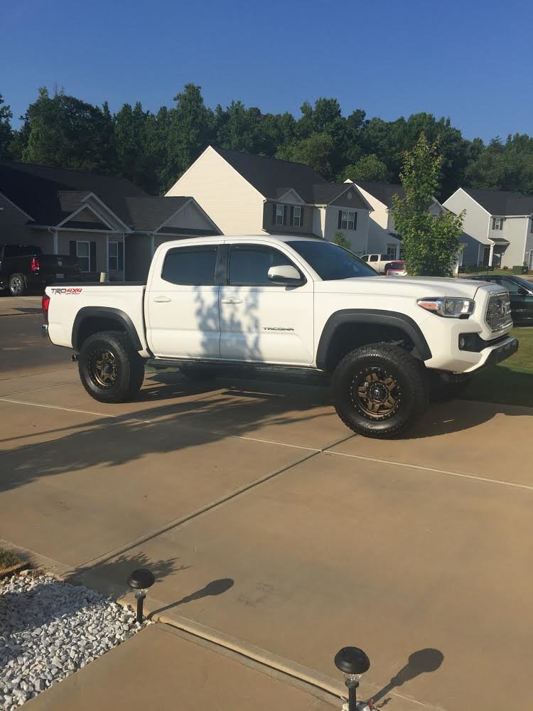

    3 inch Pro Comp Nitro lift. Pro Comp at sport 285/70/17's with Bronze 17 inch Fuel Anzas
