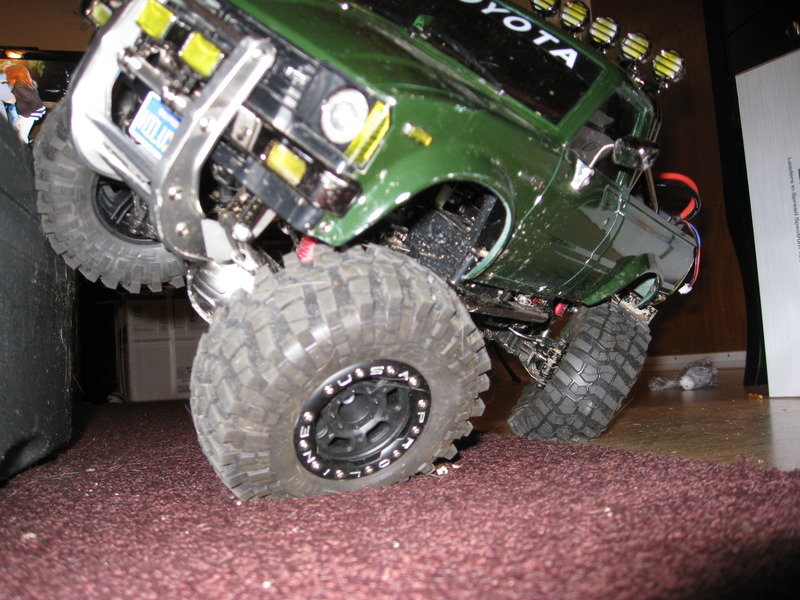

    That truck is awesome what are you guys talking about?!?!
    Here is my rig and i DD it and hit off-road trails with it and i overland it! Its too awesome.........I want a 2010 taco with a bulletproof 12" lift with 40"'s or larger. Where i go you cannot follow!
    This is the look im going for....my%20new%202.2%20bead%20lock%20wheels_zp_78847980b8f4b1a1127dba5f4e1888eb8400713c.jpg

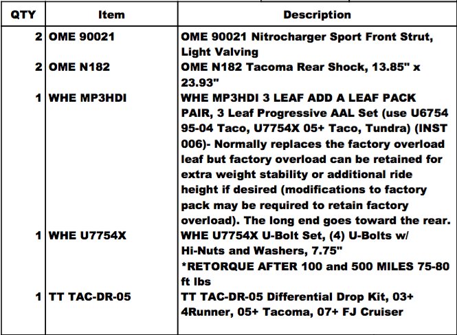

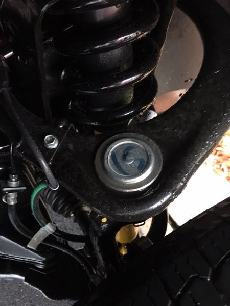

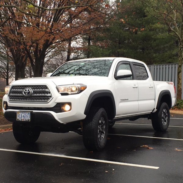

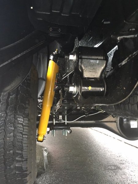

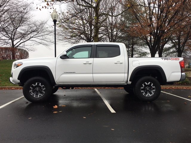

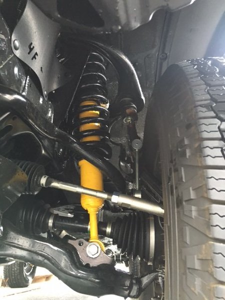

    Ok so I finally got the 3" OME Lift on the truck. I myself didn't install the lift so if you have some specific technical questions I may not have the answers but another TW friend did, ask @DOUBLLD if you have any questions regarding install, etc... Wheels and Tires to come shortly and photos will follow. So far love the ride of this setup, little bit stiffer and a nice height and stance thus far. Can't wait to see what this build becomes over the next few months! Stay tuned.

    Came out great! Good stance.

    Did you check for rub before the lift?

    Looks awesome
