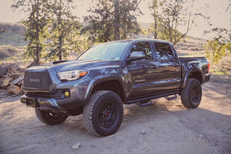

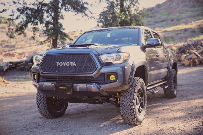

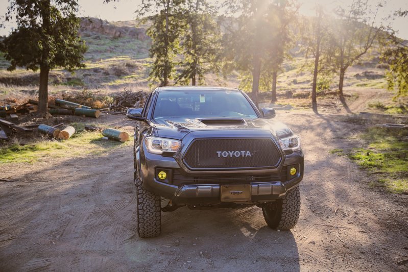

    My OME set up. 885 coils in front & 2" Toytec AAL for the rear. Thanks to @\000/ for helping me out with my build.

    Where is the grill from? The truck looks great!

    Looks good. You should cut the toyota letters out of the emblem and then re-attach. It'll look cleaner.

    Thanks. Got the mesh from customcargrills.com. Here is a link to the emblem http://m.ebay.com/itm/262150148354

    looking good. like the look of the yellow tinted fogs.

    nice set up, how much lift did you get out of the front? does your rear sit level or a bit high compared to the front?

    Hey PJC1183 what size tires are those? And any rear OME shocks?

    I got a true 3" lift in front and 2" lift in the rear. It sits level actually.

    275/70/17 and 60091 shocks in the rear
