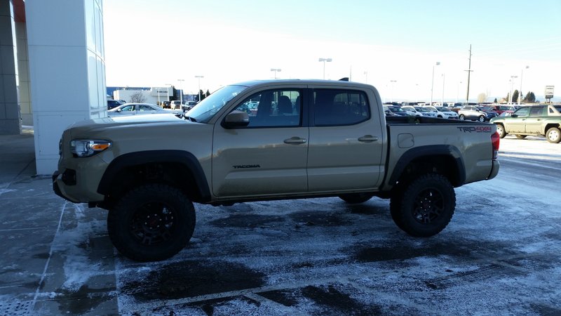

    Utah
    2016 DCSBOR 4x4 Quicksand
    Icon Stage 2 TRD Pro Wheels 285/70/17 BFG KO2's Header Rail Extang Solid Fold 2.0 Tonneau Cover
    -18 will stick out further than -12 but -12 is a more common setup on here. Depending on how wide your rim is -18 may cause you to actually rub more as this will affect your backspace. I'll let others chime in but IMO -12 is safer play
