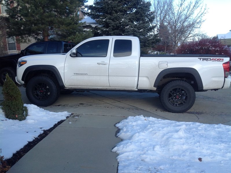

    TRDORAC, stock with 265/70/17's. Measures 22" in the rear, 21" up front, center of the hub to the bottom of the fender.image.jpg
