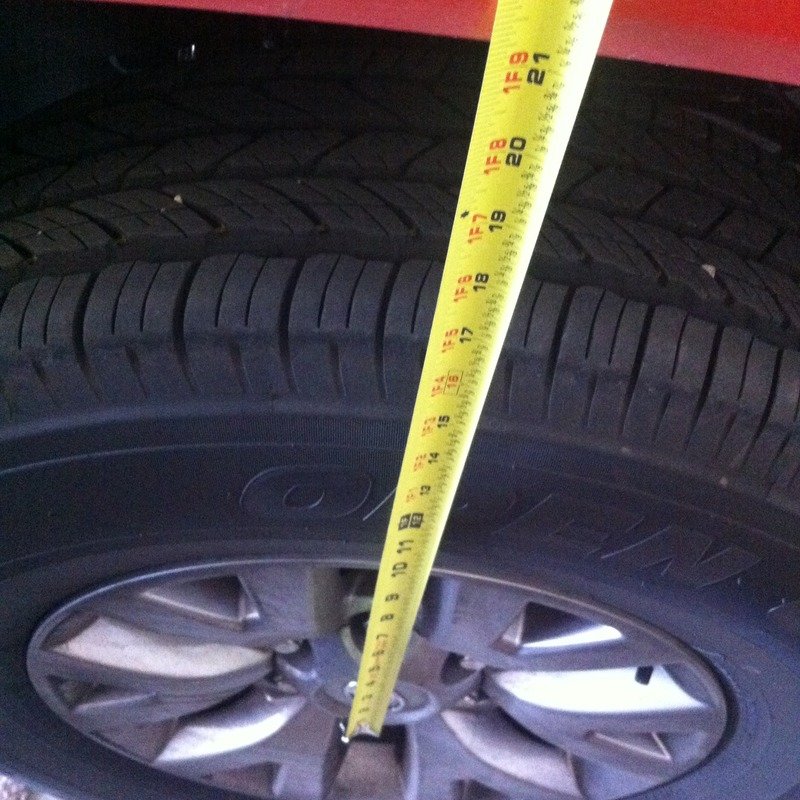

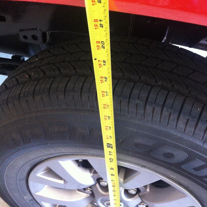

    Front Driver: 20.5" IMG_0407_zpseoemvgu2_ce8702379500c16a0a2c4b2418131e9e53ca5db1.jpg
    Front Passenger: 21" IMG_0407_zpseoemvgu2_ce8702379500c16a0a2c4b2418131e9e53ca5db1.jpg

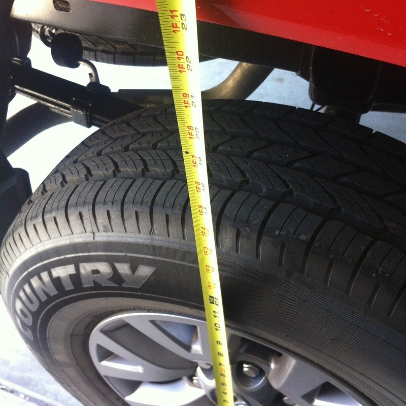

    Rear Driver: 21.5" IMG_0403_zpsnimizloo_db6c3413d84fe23928e6cac1608464168081973b.jpg
    Rear Passenger:22.5" IMG_0405_zpsir9szeqt_6e8a34022bd304d76ea22bcf0da3293141395393.jpg

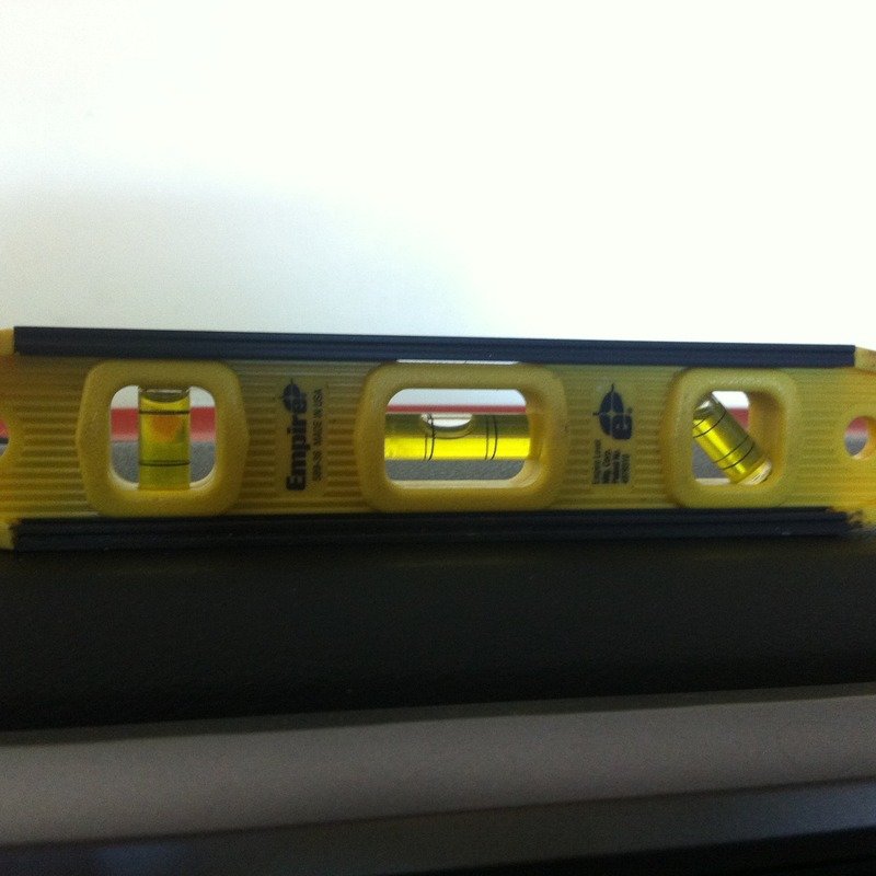

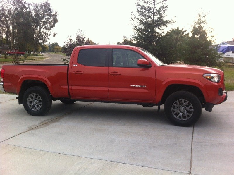

    Level front dash with me standing out side reaching in: IMG_0411_zpsj7ml8jyh_53c0c219b967d0fb3af0ec196a2db5ea75fc9977.jpg

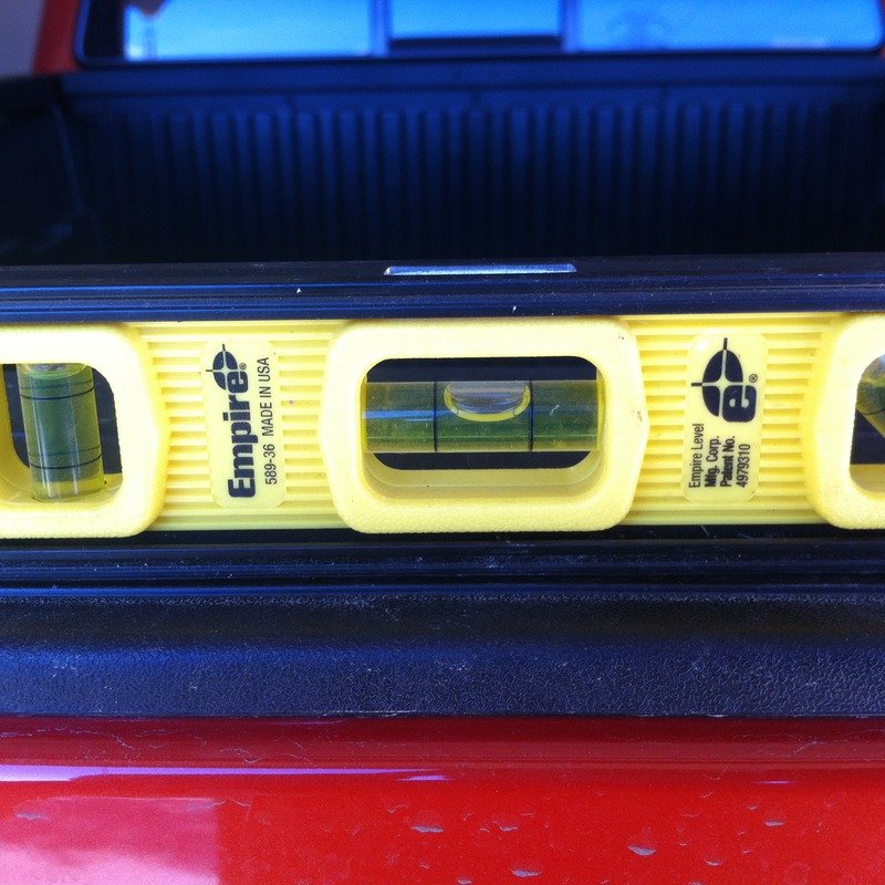

    Lever rear IMG_0410_zpsuceabu0s_e5cbd6c24d57fe319e6852e413be0fe410e7e2f4.jpg

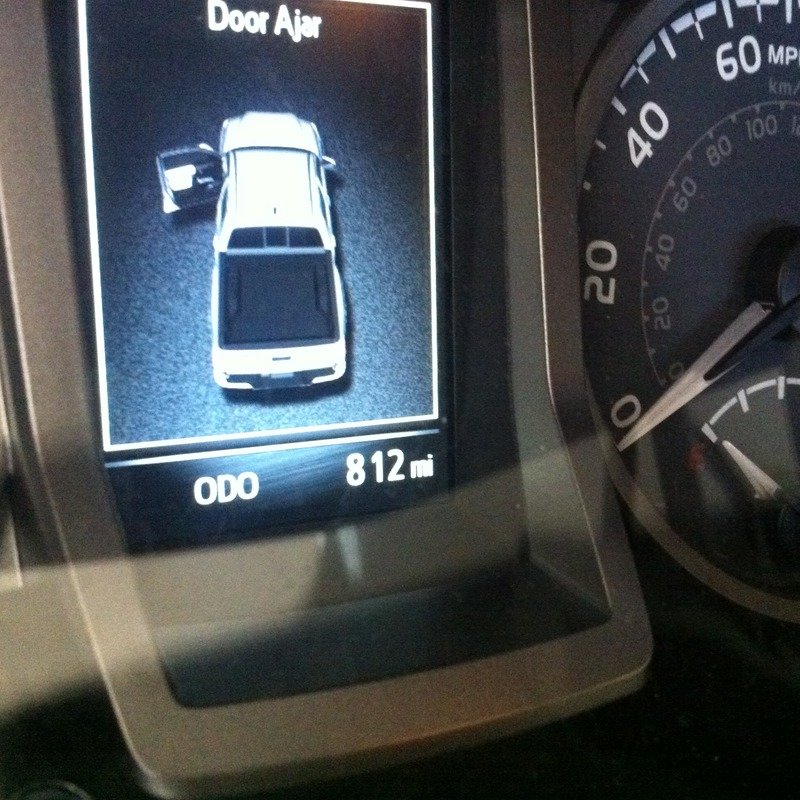

    Odometer: IMG_0409_zpsiwjo4bnr_ecb0676e625aa76e02b33b085963bce5ea374355.jpg

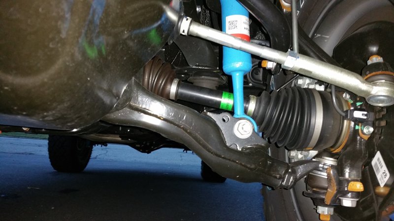

    That's a perfectly safe to run your CV's. If anything maybe have to replace a boot down the road. No big deal. This cv conversation is way over rated and you guys are over thinking it with only a 2 inch lift from shocks.

    You're past center hub :)
    Plus it's a door not ajar! I hate that lol

    It looks like that from the angle. Now imagine if I was past the hub the numbers would be even lower.

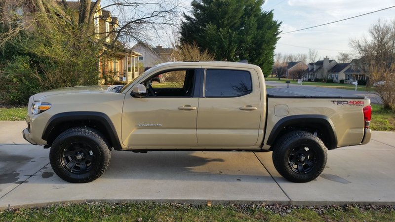

    I know it's not lifted but I will be leveling with Bilsteins soon. I have some rubbing with these 265/70/17's. Will leveling correct the rubbing? 20151212_153117.jpg

    -12 offsett I think that may be the culprit. I'm not sure what the back spacing is. It's rubbing up front.

    How wide is the wheel and tire

    17x9 wheel and 265/70/17

    I am not rubbing anymore after the CMC and fender well trim.

    That's weird you should be clearing. But no big deal after the trimming

    Yeah surprising to me as well, only going up one size, it's got to be the negative offset of the wheel. But oh well that's the look I wanted.
