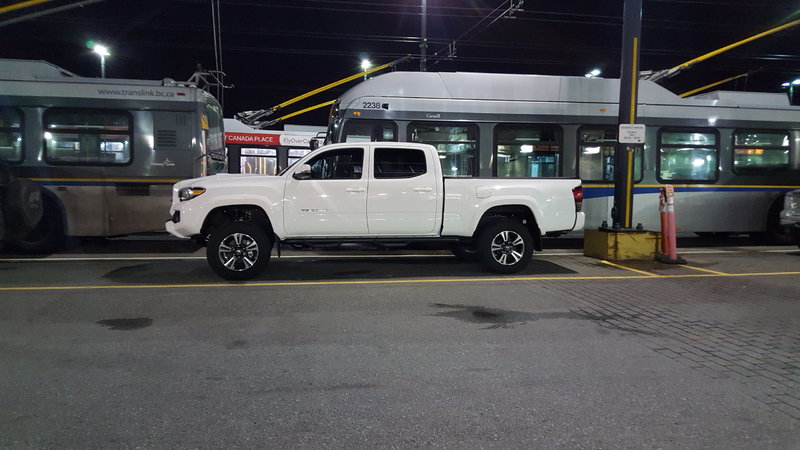

    Here's my 887s with bilstein set at the second notch and a Deaver aal in back. Got 1.5 ish in back and about 3 up front. It sits almost level. Front is about quarter or half inch lower. Good luck with your set up

    Why did you preload the shock when you are getting the lift from the coil?

    because i didn't get 3 inches from the coil, i got 1.75-2 of lift on my truck, maybe others will be different but i had to go up a notch to get 3 inches

    Cool

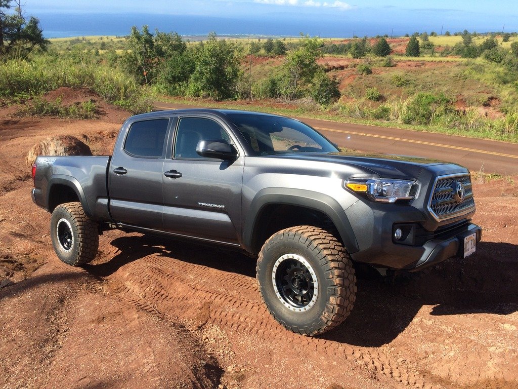

    Looks awesome! Which wheels are those?
