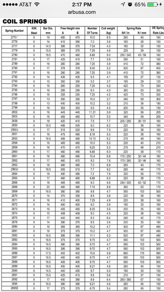

    What is the difference between ARB [or OME] 2885 and 2887 springs . I purchased Bilstein adjustable 5100s [not on yet]. I want a good 3" lift . I have a 3" lift now with coilover spacers . Thanks .

    285 are a medium weight spring the others are heavy weight and used in conjuction with heavy bumper and winch, you can use your Billies with the ome springs but you mave to set them at there lowest setting, or middle setting maybe get your 3 inch lift....

    885s and 887s have the same spring rate but the 887s are 5mm longer. 886s have the higher spring rate.

    image.jpg OME spec sheet compare 2885 vs 2887
