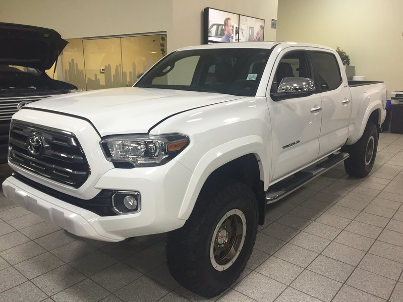

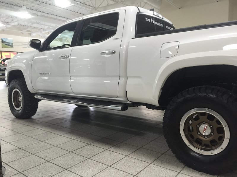

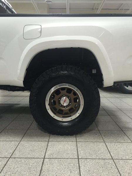

    Calgary Alberta Canada

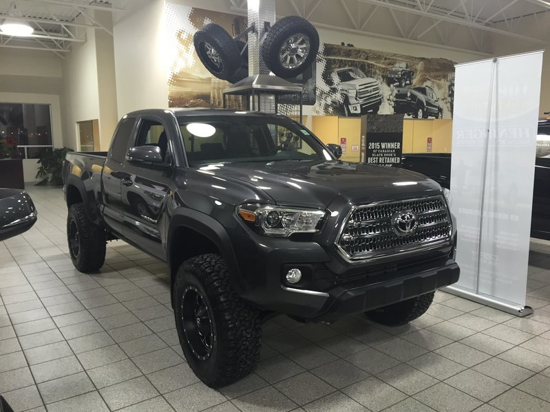

    Best picture I could get. Our showroom doesn't lend it self to taking the best pictures with how tight it can be at times.
    NABeast and Dean724 like this.

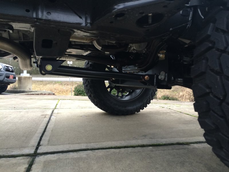

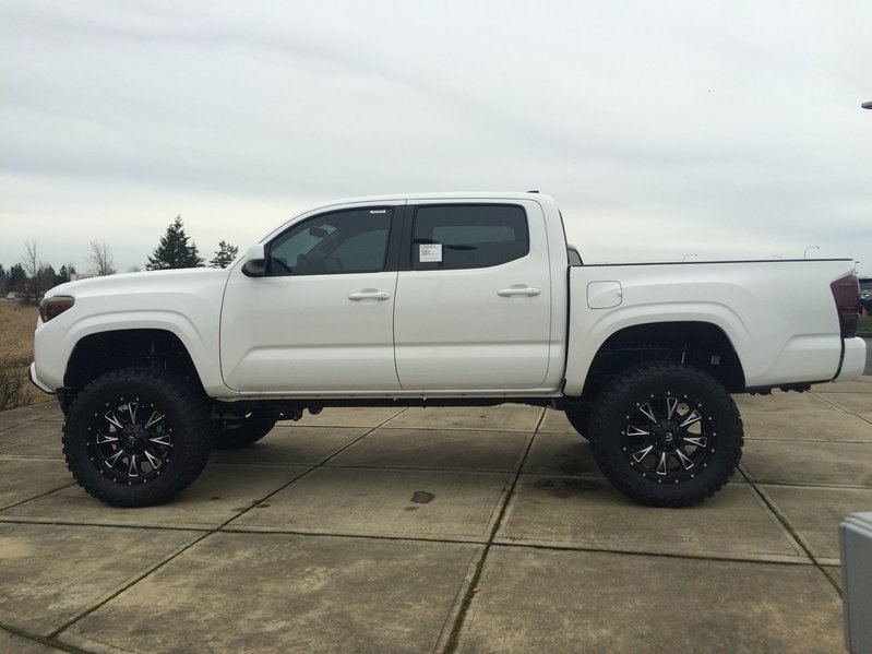

    Olympia, WA
    2016 Tacoma DCSB 4x Sport MGM

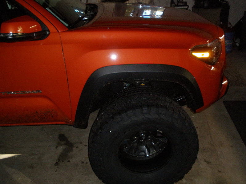

    Couple of pics.
    Pro Comp lift. Looks like 5-6" spacer in front
    Blocks in the back w/ Pro Comp Shocks
    35- 12.50 / 20" tires.
    For sale on dealer lot in Chehalis Wa.
    TcTtrdsport14 likes this.

    '83 CJ7 '19 MT 07
    Spacer lift and Pro Comp, what a horrible combo.
