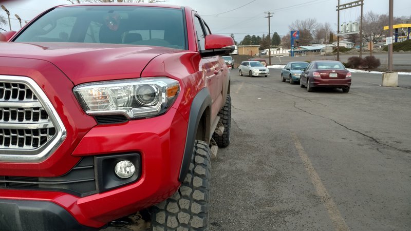

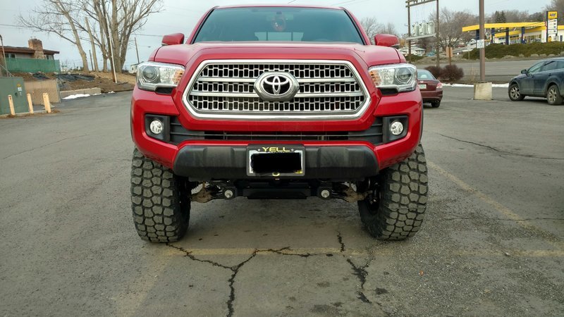

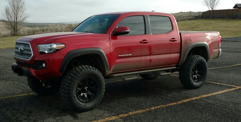

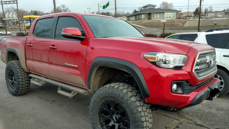

    Today was the day, finally got my lift on. 6" BDS w 18"x9" Helo 878 wheels & 35"x12.5" All Country Ironman MT tires.
    I know 6" lifts aren't everyone's cup of tea, but it is mine. It came out exactly like I wanted and I couldn't be more happier about how it turned out. Yes, I know it needs a bath, but it's 33 degrees right now and that'll have to wait until tomorrow or another day when it's warmer.IMG_20170128_163901.jpg IMG_20170128_154626183_HDR.jpg IMG_20170128_164023.jpg IMG_20170128_164303.jpg

    Looks beautiful. I love the wheel size choice, fills nicely. How much did you need to do aside from the chase is cut to get a proper alignment and no rub?

    Wheels are a 4.53" back space. The tire just clears the body mount, we'll see how it performs, I may have to trim and box in the body mount, but so far lock to lock and no rubbing.

    Sweet looking truck, how are the cv angles?

    Not bad at all, drop bracket lift

    Also, the reason why drop bracket lifts are not everybody's cup of tea is because they are really more for looks than function. The moment you start wheeling more seriously you'll realize that they don't really enhance off road performance at all [you actually lose ground clearance with that bracket hanging lower than the factory cross member]. Also, there are cheaper ways to fit 35"s :sawzall: :D

    With the RC kit you can get by with notching the crossmember. I'm willing to bet I have better ground clearance on 35's with my custom skid plates, than other Trucks with aftermarket skids plates. Plus I have down travel.
    I'm on a mission to make my drop brackets work :benchpress:
    The ProComp, RCD and BDS have really tall drop brackets, because they are a true 6" lift, where as the RC drop brackets only drop the lower a-arms 3.5"s.
