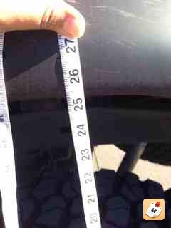

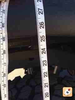

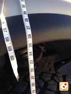

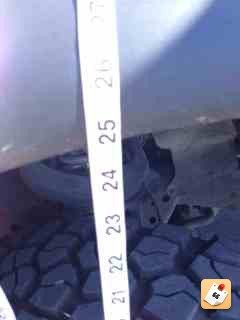

    So after taking pics and re-measuring with a seamstress measuring rope I got better/ different numbers than I did with the yard stick
    New numbers...
    Driver front = 24 3/4"
    Pass front = 25"
    Driver rear = 25 3/8"
    Pass rear = 25 1/4"
    I guess it still seems kinda high up front but I guess it's better than the 26" I was getting with the yard stick.

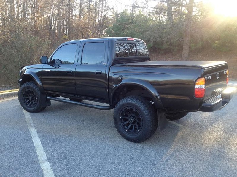

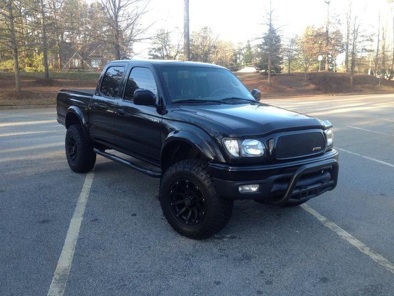

    Aragin70
    Aragin70 Member
    Jul 8, 2013
    #107847
    7
    Andre
    Atlanta, GA
    03 PreRunner
    OME 881coils-NitroSport 90004/Dakar Leafs NitroSport60062, clear corner lights, Grillcraft mesh grill/TRD badge, Hunter Bull bar
    OME lift with 17x9 Black Rhino's wrapped with 265/70 Duratracs.
