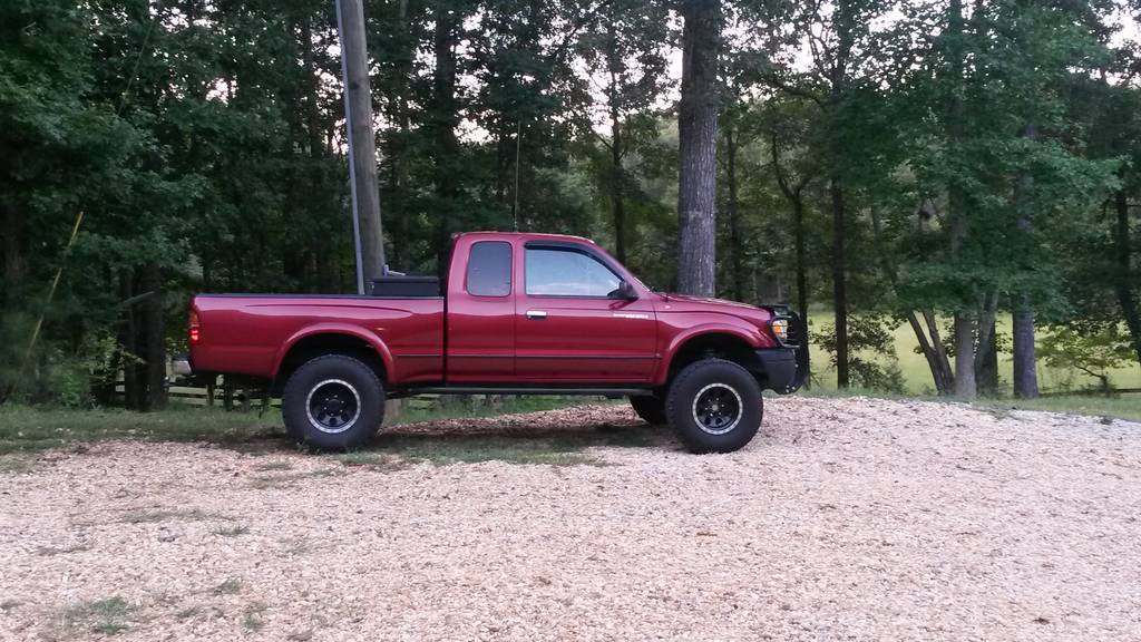

    Brushguard, Lift.

    Nice!! I love me a stepside

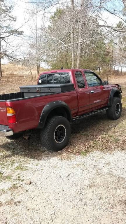

    We need specs! Or at least lift height and tire size!
    Random place to ask, but while I asking the above, are the body color matched flares factory, or did you paint them?

    Bilstein 5100s all the way around with eibachs and aal. I'm sitting at 39 1/2" from ground to fender in front and 39 1/4" in the rear. I have 33x12.50 KM2s on 15x8 MT Sidibiter IIs with 3.6" back spacing. I love it, sits nice and rides smooth. I have also fixed the bumper where is was angled from previous owner. The color matched flares, grille, and bumpers are stock

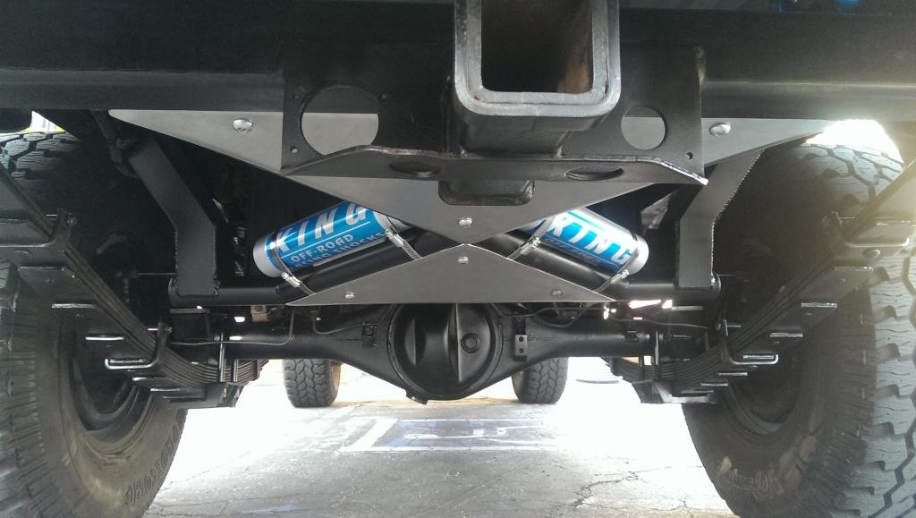

    Here is my project, [COLOR=#555555][FONT=Verdana]Click for full-size image (1024 x 579)[/FONT][/COLOR]
    [ATTACH=full]1797181[/ATTACH]IMG]Click for full-size image (1024 x 579)
    IMAG1422_zpsynrjvihf_b17db59db7f2527f5f8757ee37c7d000bebe6ad1.jpg[/IMG]

    That canti setup is pretty sweet, I want to see some flex shots

    Looks like very little up travel into the wheel wells, are you planning to run fiberglass?

    I got it back less than a week ago & haven't gotten to play with it yet, If I need to I will run fiberglass, Ill find out as soon as I get to take it out and play with it. Hopefully this weekend!

    There is a good amount of up travel.
    If your serious you need fiberglass PM me I plan on getting bigger bedsides soon and my glassworks 4" bedsides should work for you quite well.
