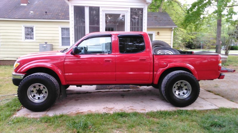

    What are the specs on lift and tires and rims? I am going to look at some 15x8 with 33x12.50 today. Hoping not to need wheel spacers to keep tires from rubbing UCA. I have the Fabtech 3.5 basic kit.

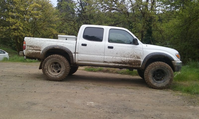

    Mid travel, armour all around
    3in bilstein eibach up front and deaver add a leaf with a 1.25in block in the rear stock shackels, wheels are scs 16in 3.5 backspace tires are 285/75 cooper st maxx

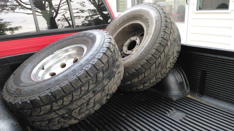

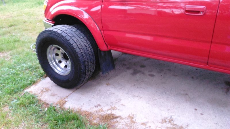

    Just picked these up for $240 total, 15x8 with 33x12.50, tires are pretty worn but will work for a few months, gotta turn up the coil overs and install the add a leaf, then the 3" body lift to fit the 35s :burnrubber:

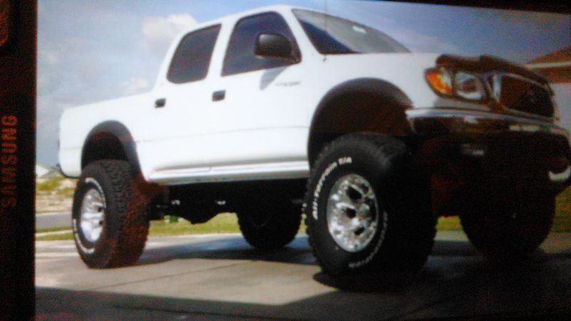

    Yes, this truck has body and spacer lift on 35s

    Drop bracket lift and booger welds
    Oof I guess just for looks? That high COG though.

    Body lifts are ugly as hell and unsafe if you ask me.

    I know, i hate the look of that frame hanging down all exposed. Looks like a damn chevy with 4 inches of frame hanging under the bottom of the door lol. I feel like a DB lift is better in this case...

    Im just gonna say it because everyone is thinking it why not just do a drop bracket lift if you wanted 6in of lift

    Because he wants the worst possible ride imaginable

    Well hes not doing spacers so it should ride ok but if its money related id just save and wait a little more

    I'd just do it right and go 3" lift no higher. Whats the point for going 6" lift, bigger tires? I've seen 35's on 3" lifts

    Yeah but not everyone wants to tub. I agree if you want it for the look might as well get the DB lift. 3" body lift is just as much work.
