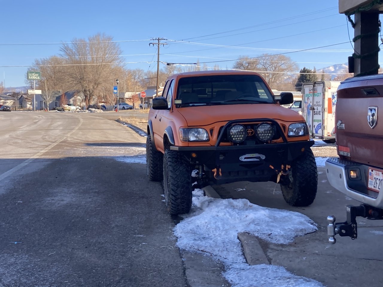

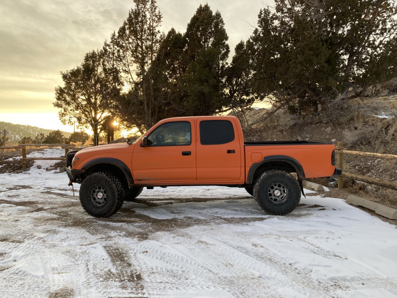

    I have bilstein 5100. With a 2” add a leaf on the rear and 2007 Tacoma front coil springs.

    What bumper is that?

    Interesting, whats the orange color called?

    It’s called Grabber Orange. It’s a Ford Mustang color

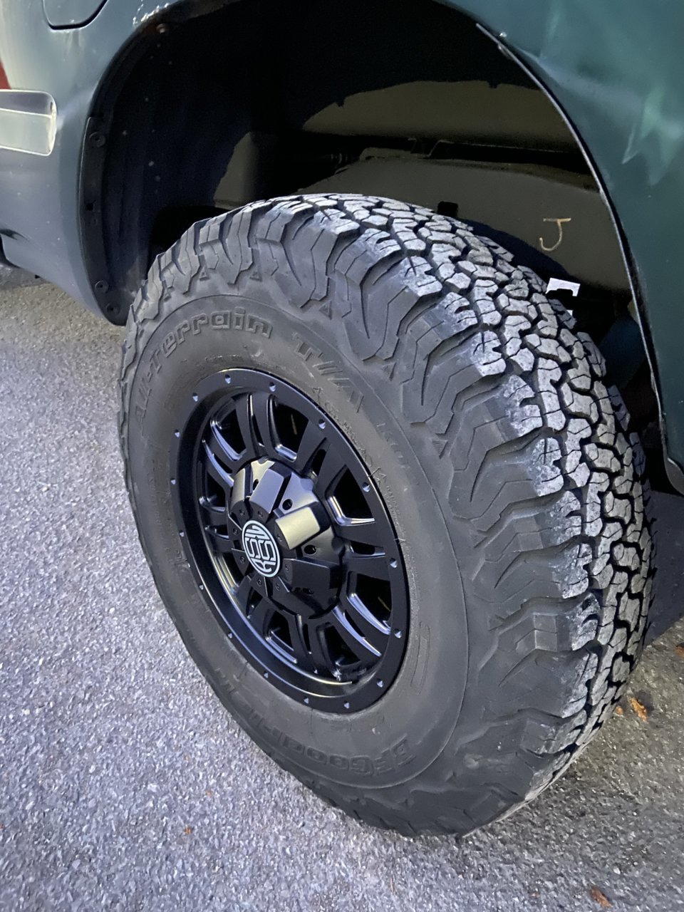

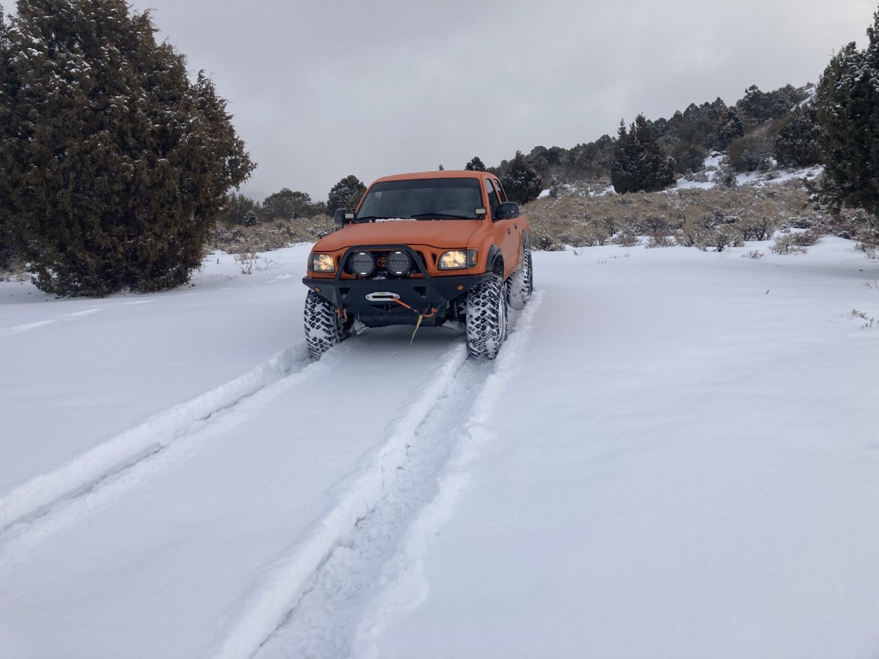

    I have had mine for about 7 thousand miles. So far I love them. They wear really even. They are the best set of tires I have ever ran. They are not the best in snow but I have never got stuck in themupload_2021-1-27_5-51-51.jpg

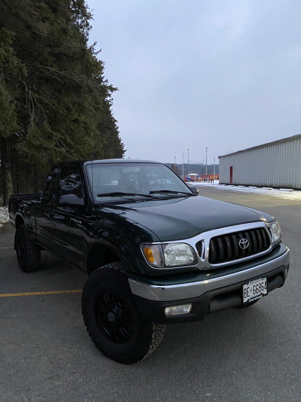

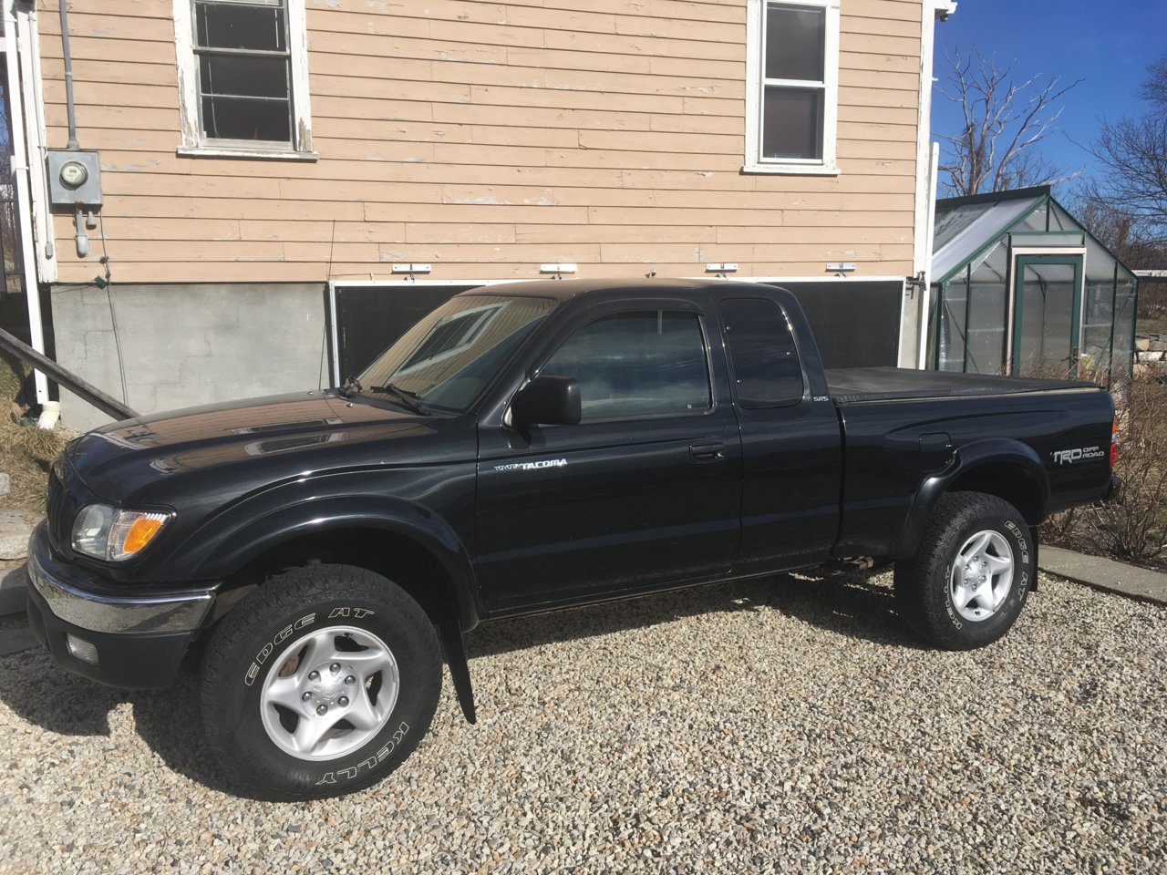

    Can you guys please tell me everything I need to make my truck below look like the one above. I plan on having everything installed by a pro. 1.5 -2" would be sweet.
    I see you can get the whole OME lift kit on Bilstein. Wondering how visible that yellow would be. And can you mix and match the 5100 with OME springs. I feel like thats what you lads are doing.

    5100's all around, ome 881 fronts springs on the lowest setting, and icon prog (3 leaf) aal or i heard the wheelers prog (3 leaf) aal is comprarable.

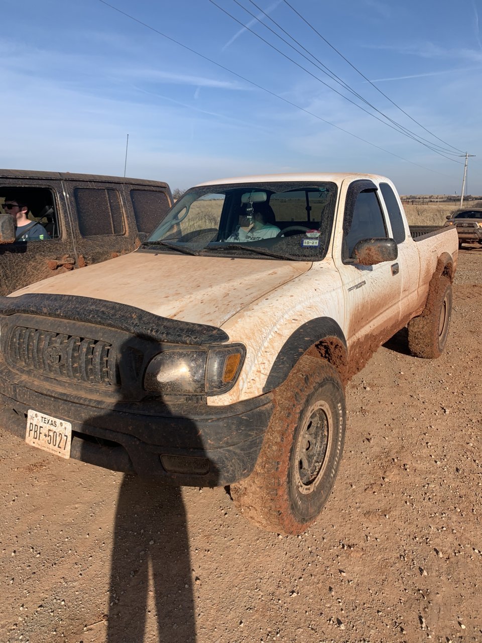

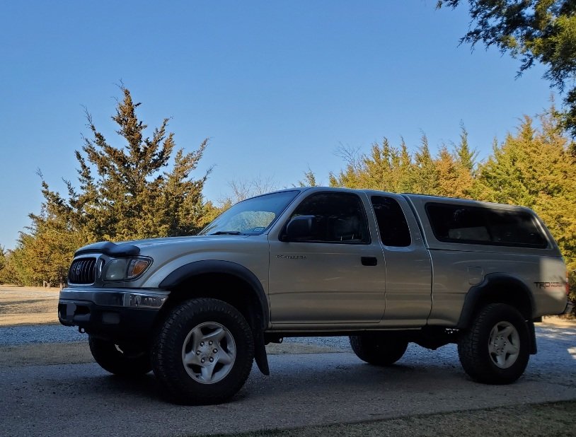

    I need some help figuring out what lift kit would be best for me. I own a 2001 Tacoma Xtracab, I have some 33" on it (rubs on the frame when fully lock) and I want to get a kit that would more focused on off-roading. I want to lift it 3" front and back. I went muddin last weekend and I am surprised did get stuck but I want some more clearance. Attached is my truck.
