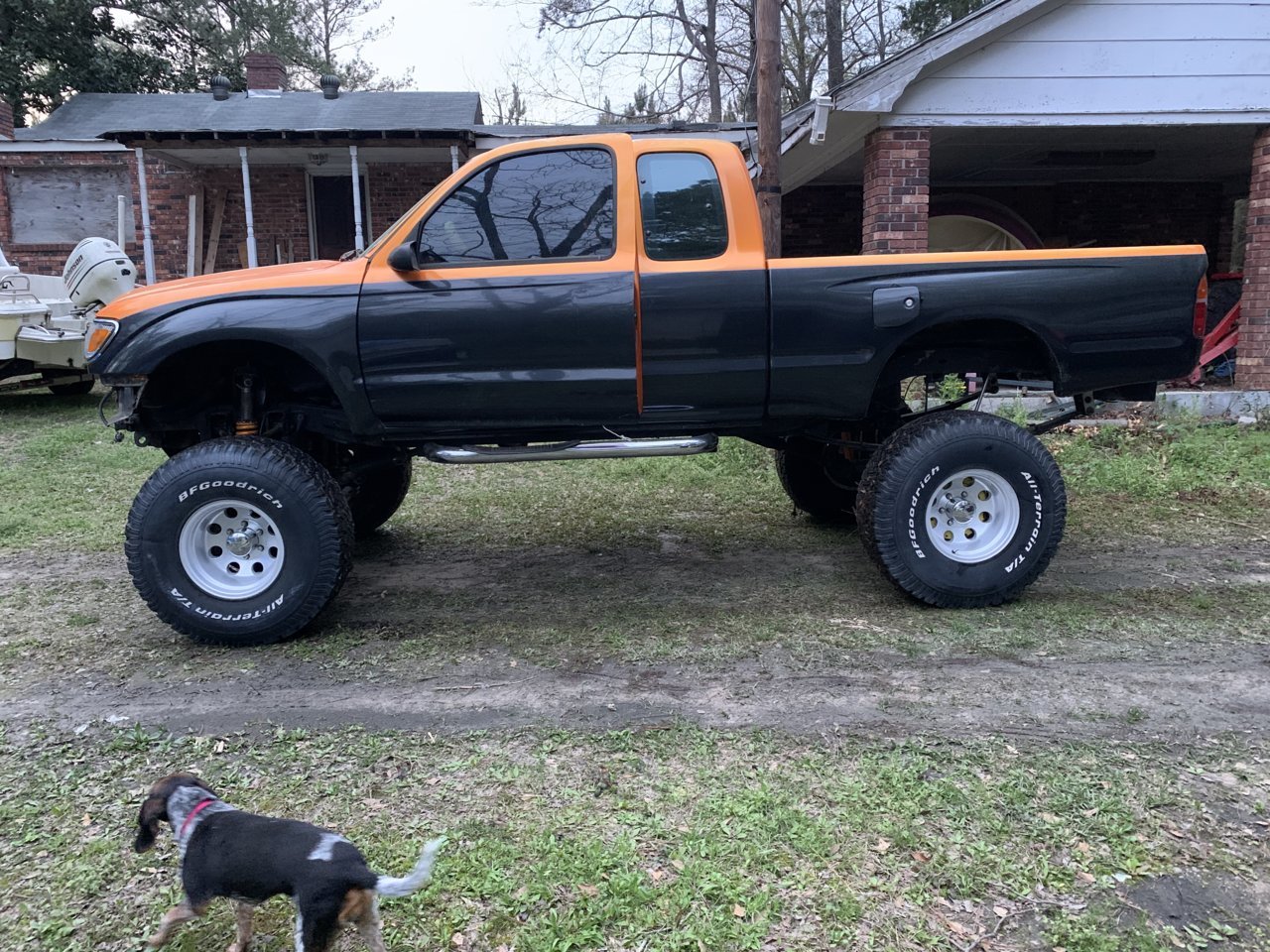

    3" Toytec spacers, Bilstein 5100s in the back with add a leaf and overloads removed.
    Not quite sure, not great lol I get about 200 a tank but that’s all in town driving and it only gets driven a few times a week

    Oh lol I’ve got 151k on it right now, about 40k since I went to 3” and these tires and wheels

    What's the backspace on these? I had the FN 5 stars in my 4runner but personally don't think 5 spokes look great on our tacomas. Big fan of six spokes though. Curious as to what the backspacing is, wheel size and if you have a spacer or not? Thanks in advance.

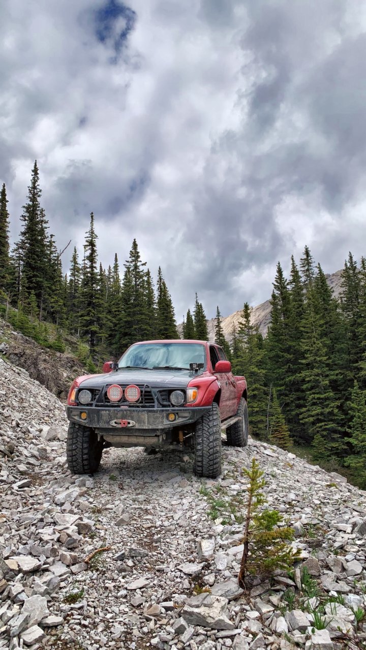

    Minimal lift, maximum cut:rofl:

    Drop bracket lift and booger welds
    The real question is how is the OEM skid still alive?

    Hard to hit it in the mall parking lot!!!

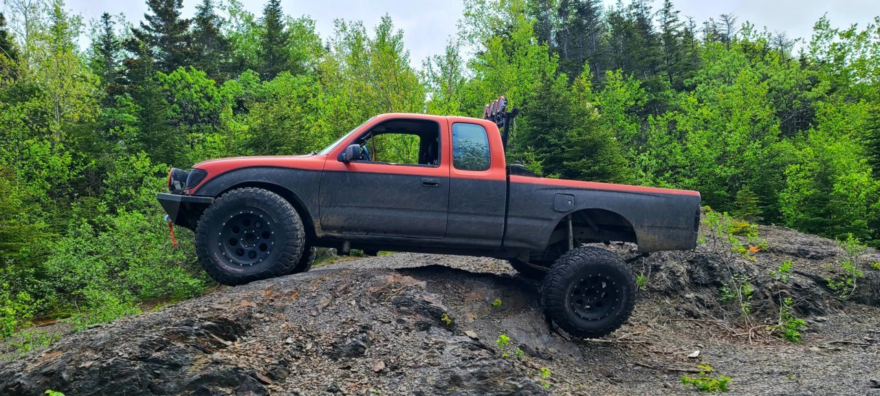

    twinsie

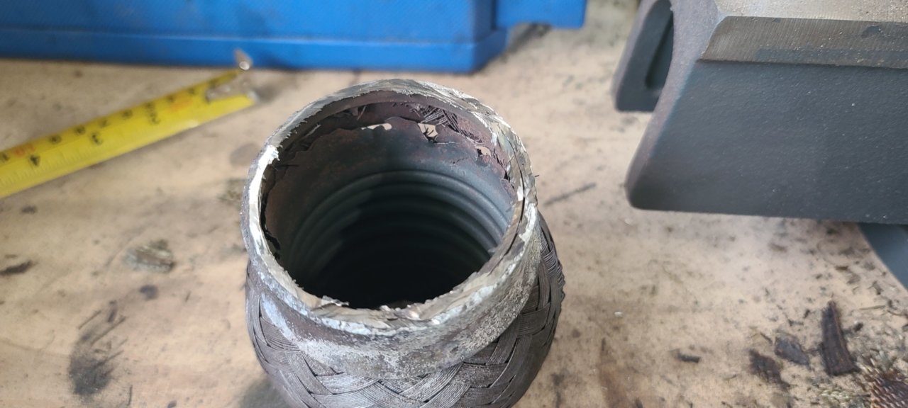

    How's the turbo set up been working out for you long term? Have you had any issues with the manifolds?

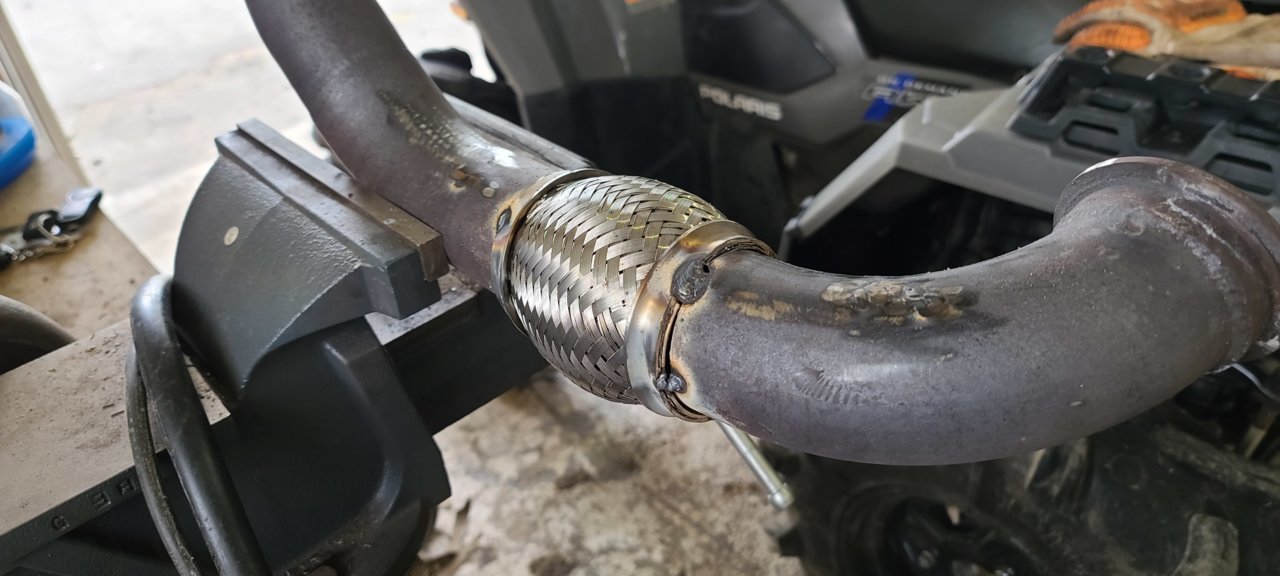

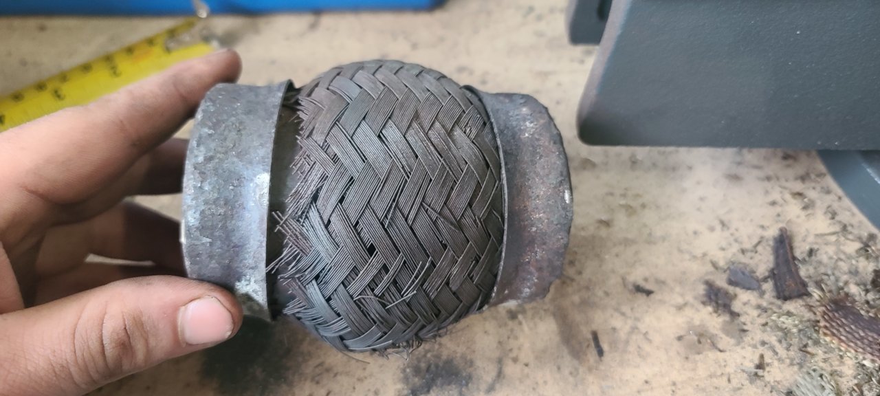

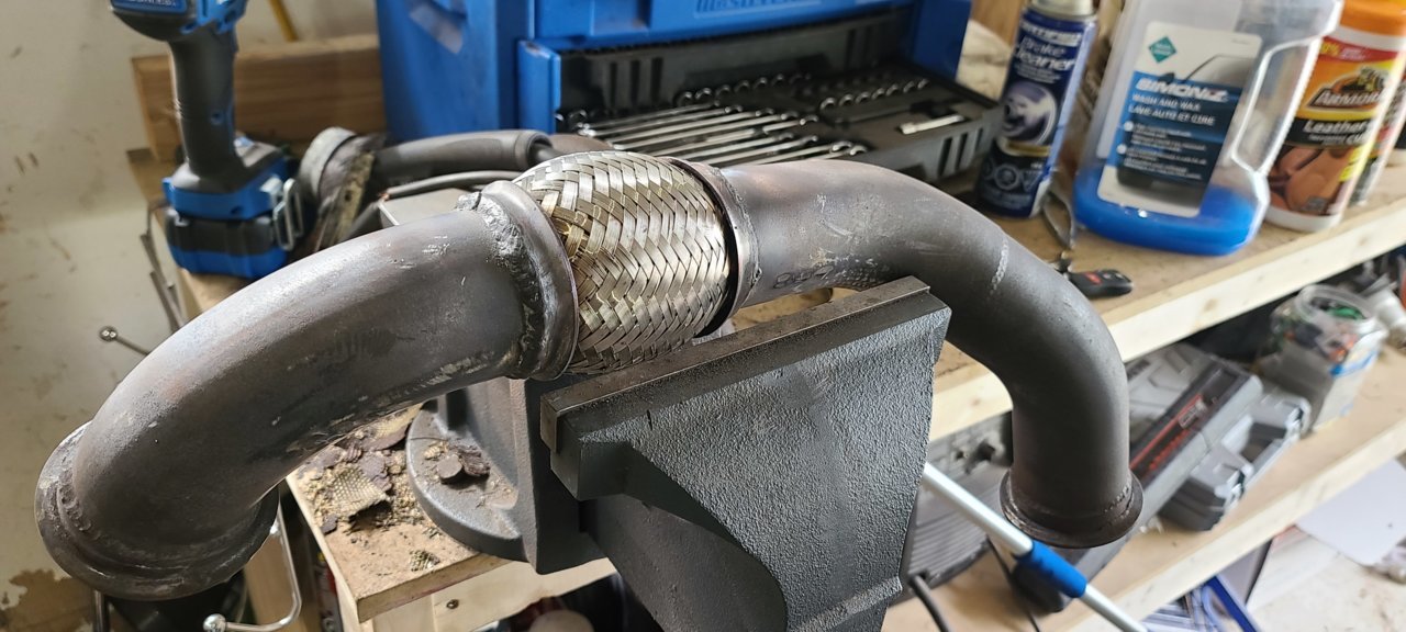

    had my first issue with them last month after 4 years of abuse. the flex pipe on crossover failed and i was getting some horrid turbo lag. original vbands popped right off (if you know where newfoundland is youd know thats amazingly lucky to not be siezed). happened to have a 2.5x4 flex joint laying around and i swapped it in. waiting on a roll of exhaust wrap before i put crossover back in. since its larger diameter pipe with no heatshield the floor gets quite toasty without any wrap.

    Nice! That’s some pretty good longevity out of that setup. Looks like the new flex section should be more durable. I forget what you ended up using for injectors and tuning?? What kind of hp do you think your making at the wheels?

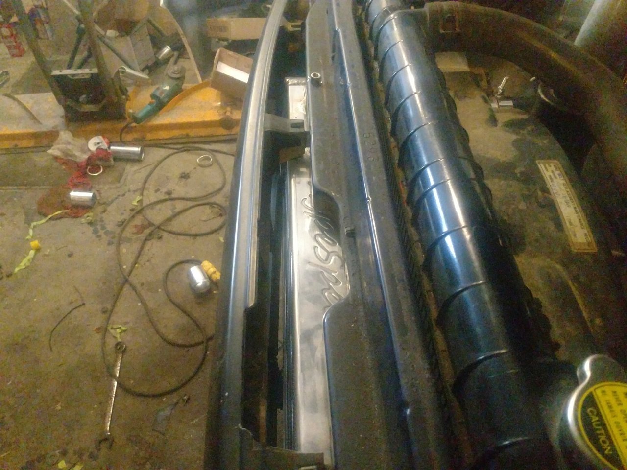

    How did you manage to install an intercooler?
    95-97 there is zero room for an intercooler as the grill bumper is much shorter
    I was looking at the rear mount option because an intercooler is not needed.
    I’m Supercharged but always looking for other options

    by removing the hood latch assembly (despite what some people keep saying my hood pins arent just for looks ahaha) and cutting a couple grill tabs off. had to relocate winch solenoid and other stuff too.

    I think my AC condenser takes up most of that area on my truck tho
